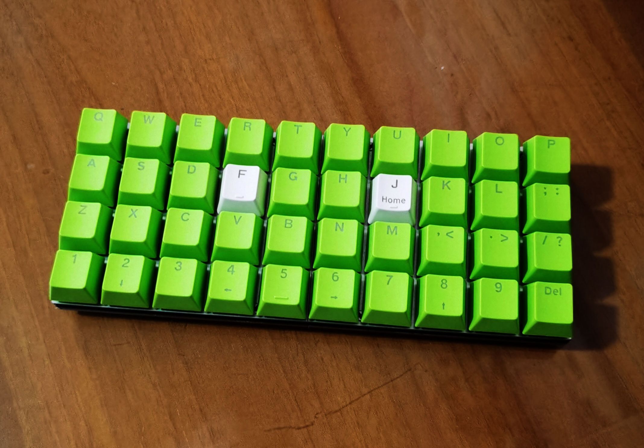

This project is changed from https://oshwhub.com/iqirtryi/pbk40-rgb-keyboard-c. The original project used a pro micro module, so the keyboard was thicker. At the request of PMM, a member of this project, it was changed to an onboard master control. Atmega32U4 was directly removed from the original module, and a high-low shaft and a sinking Type C port were used to make the keyboard thinner.
Borderless version: The positioning board, circuit board, and bottom plate are designed with a splicing board to reduce the production cost.
The two circuit boards are spliced ​​together with wires. The 32U4 master control and C port only need to be soldered on the left side of the diagram.
The sinking C port is used, and the height of all electronic components is controlled to the height of an aluminum substrate.
The bottom plate made of aluminum substrate has a hole for burning corresponding to the position of the RESET micro switch.
The borderless version was made by PMM, and the lovely fresh green was given to him and her. Bordered
version: The original keyboard was modified, and the copper fixing, copper bottom, and frame were used as the original keyboard, and the circuit board was designed with a splicing board.
Feeling the invincible feel brought by the thinning of the keyboard, I couldn't help but transform my previous main keyboard. Yes, it's her:
the simplest programmable inline keyboard with RGB, suitable for novice production.
First feel the difference in height before and after the transformation. Both use low-profile shafts, which are reduced by nearly 5mm after the transformation.
I have always been worried about the terrible craftsmanship when I re-entered the arena. This time, the craftsmanship has been greatly improved after using the heating table.
The heavy feeling of the copper base and copper bottom, coupled with the high-profile low-profile shaft and the sinking plate C-port design, feels first-class, and it is easy and not tiring to type for a long time.
