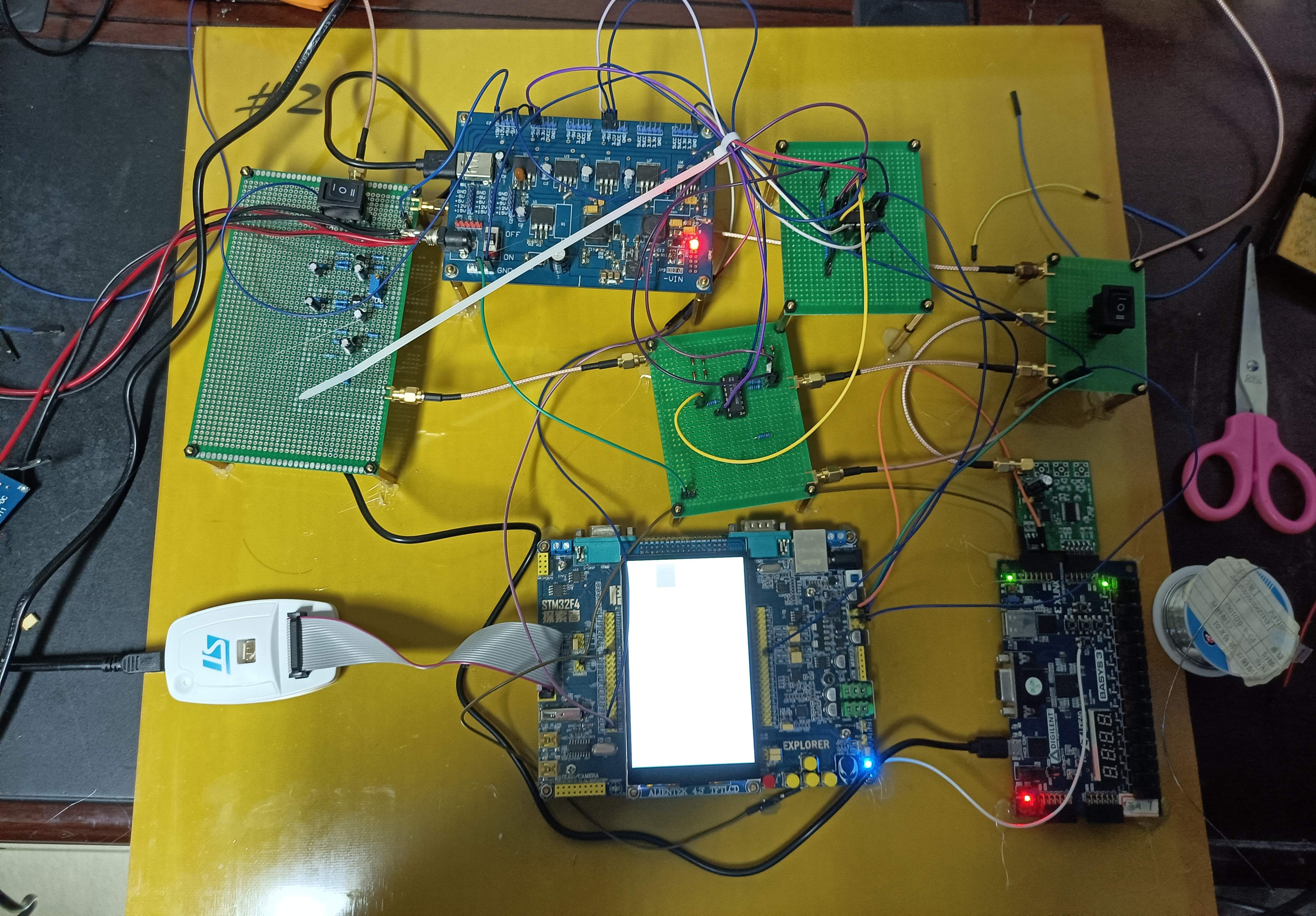

Design and produce an amplifier nonlinear distortion research device. Transistor amplifiers are only allowed to have one input port and one Output port, and can respectively output sinusoidal voltage without obvious distortion, "top distortion" voltage, "bottom distortion" voltage, "bidirectional distortion" voltage, and "crossover distortion" voltage, and can measure and display five outputs Total harmonic distortion of the voltage.

2. Distortion circuit
The design of the distortion circuit is shown in Figure 2-4 below:
Figure 2-4 Distortion circuit
It can be seen from the figure that the top distortion, bottom distortion and crossover distortion are all generated by diodes, and the forward conduction of the diode is used. The voltage drop and reverse resistance tend to be infinite, so diode filtering can be used to produce distortion.
3. The relay switching circuit
is shown in Figure 2-5. A triode is used as the driver of the microcontroller. The pin of the microcontroller outputs a voltage signal of 3.3V. The resistor divides the voltage so that the triode reaches a turn-on voltage of 0.7V, causing the diode to conduct. The multimeter The two ends of the relay are connected to both ends of the relay, so that the switch circuit can be turned on when the microcontroller outputs a high level.
Figure 2-5 Relay switching circuit
