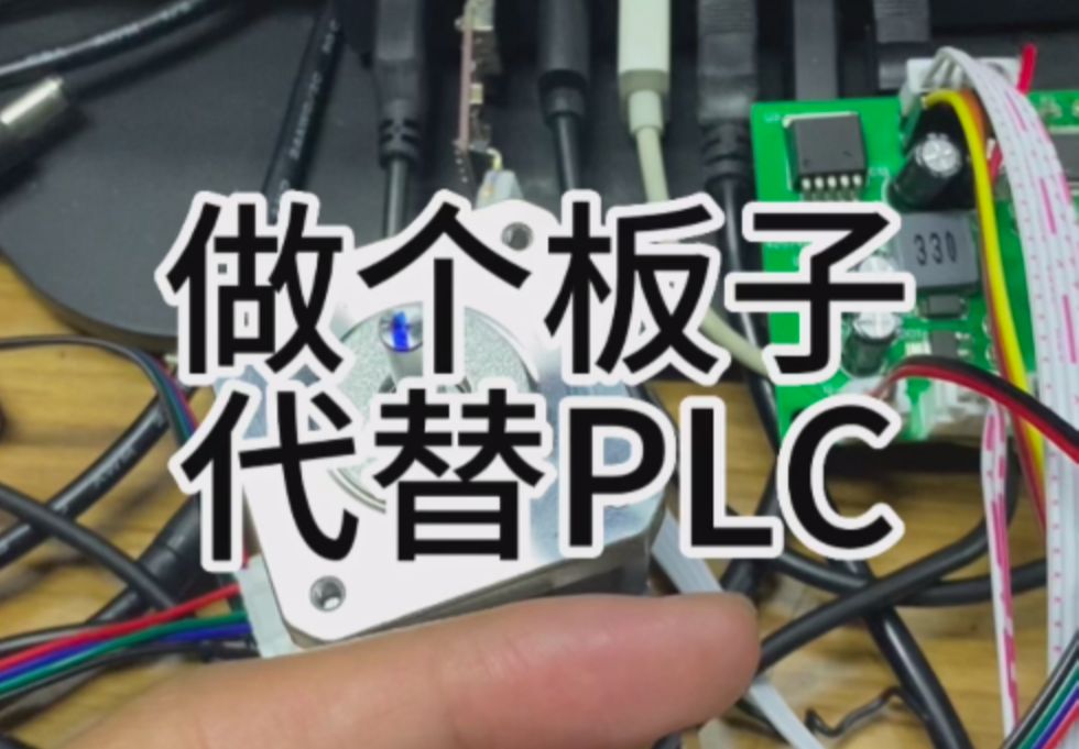

Stepper motor controller replaces PLC, Hezhou air32, A4988
The MCU is Hezhou Air32. The
programming
program is Arduino
platform. The platform is PIO. See the source code for the specific configuration.
It supports 12-24v motors, 36-42-58 stepper motors.
1 motor and 1 limiter
driver are A4988 modules. The minimum is 1 The /16 subdivision means that each pulse of the 1.8-degree motor can rotate 0.1125 degrees. This driver is commonly used in 3D printers. The cost is extremely low and the performance is reliable.
The MCU uses air32 which costs 3 yuan each.
The teaching video is here [Tik Tok Search Uncle Jie Tingdu]
