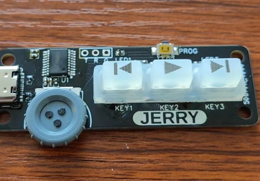

This design is small and silent, so I used silicone buttons, glued to the board, and made an acrylic panel.
The encoder uses a wave wheel, which is more expensive, and the overall price is no more than 20 yuan.
I wrote the program myself. The wave wheel controls the volume, and pressing the wave wheel is mute. The 3 buttons are the previous song, play, and next song.
After I printed on the silicone button with laser, it fell off when I wiped it, so I traced it with a pen, and it was not very regular.
