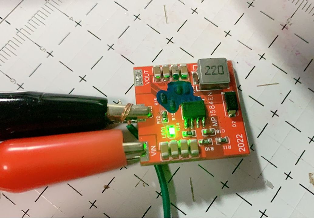

MP1584EN (tested)
Parameters:
 3-28V input (industrial 24V should be considered carefully)
with built-in short-circuit protection, short-circuit current threshold 4.87A,
maximum output current 3A (actually measured around 2.2A)
Schematic diagram:
refer to MPS DCDC Design Assistant
PCB Layout:
refer to MPS DCDC Design Basics (specific See the detailed description of the schematic diagram)
DCDC basics: PCB layout and precautions
Test:
measured input 26.3V, output 5V3A, loaded for five minutes, temperature rise around 35°C.
SW output waveform fitting data manual
refers to the following author's blog:
MP1584 step-down core DC-DC design summary.
This module only optimizes wiring and uses acrylic as an isolation layer to solve some surge problems caused by hand contact.
