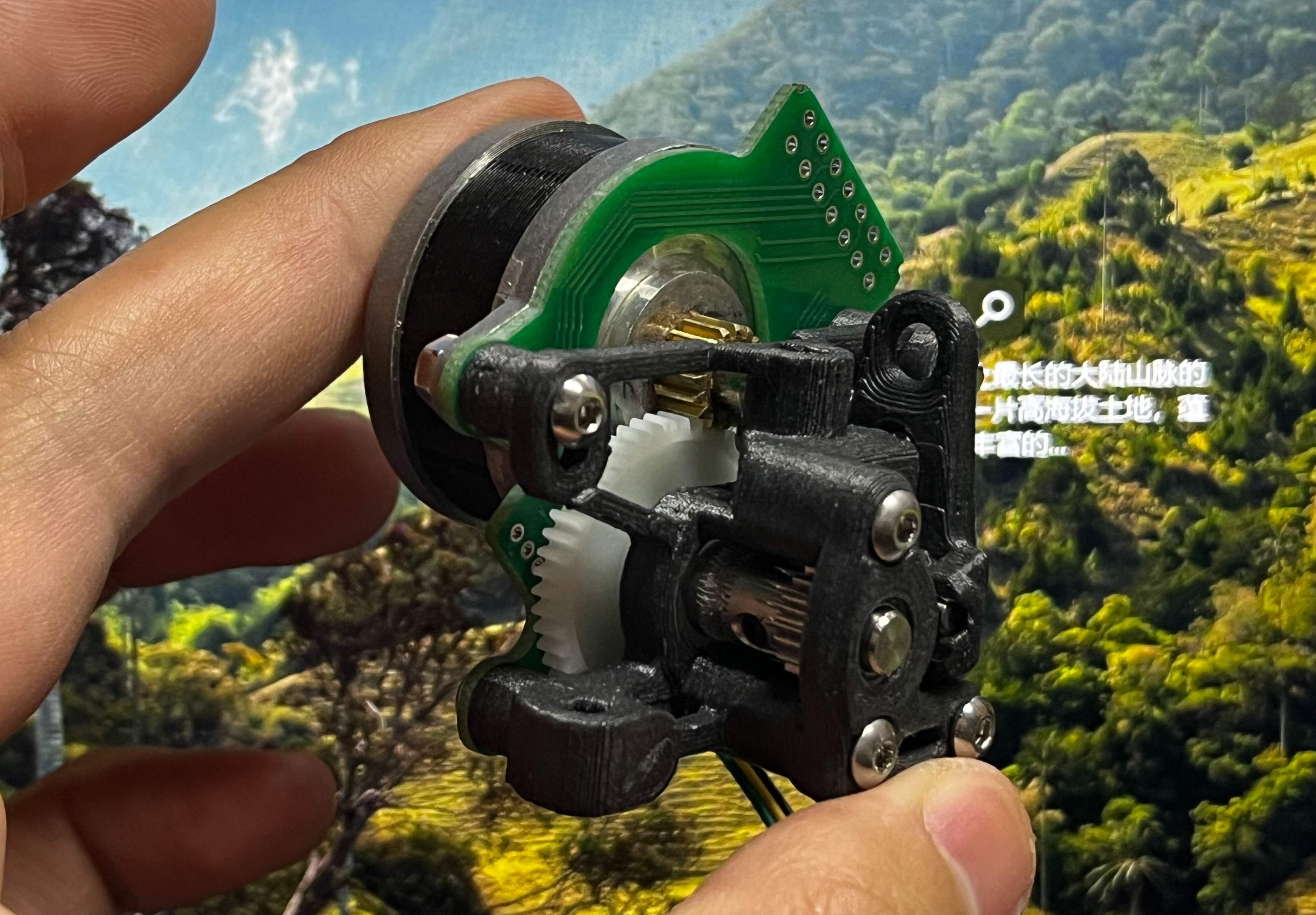

sherpa air extruder
Using BMG extruder gear kit, 5mm diameter 36 stepper motor, the cost is 20 yuan not counting the purchase freight. It
is fully compatible with the sherpa mini installation position, but you need to pay attention to whether the position of the hub board’s female seat will interfere with the structure. .
Station b https://www.bilibili.com/video/BV1bV4y1Z7XW/Motor
gear specification 165A 16 teeth 0.5 mold 5mm aperture. Just knock it in
