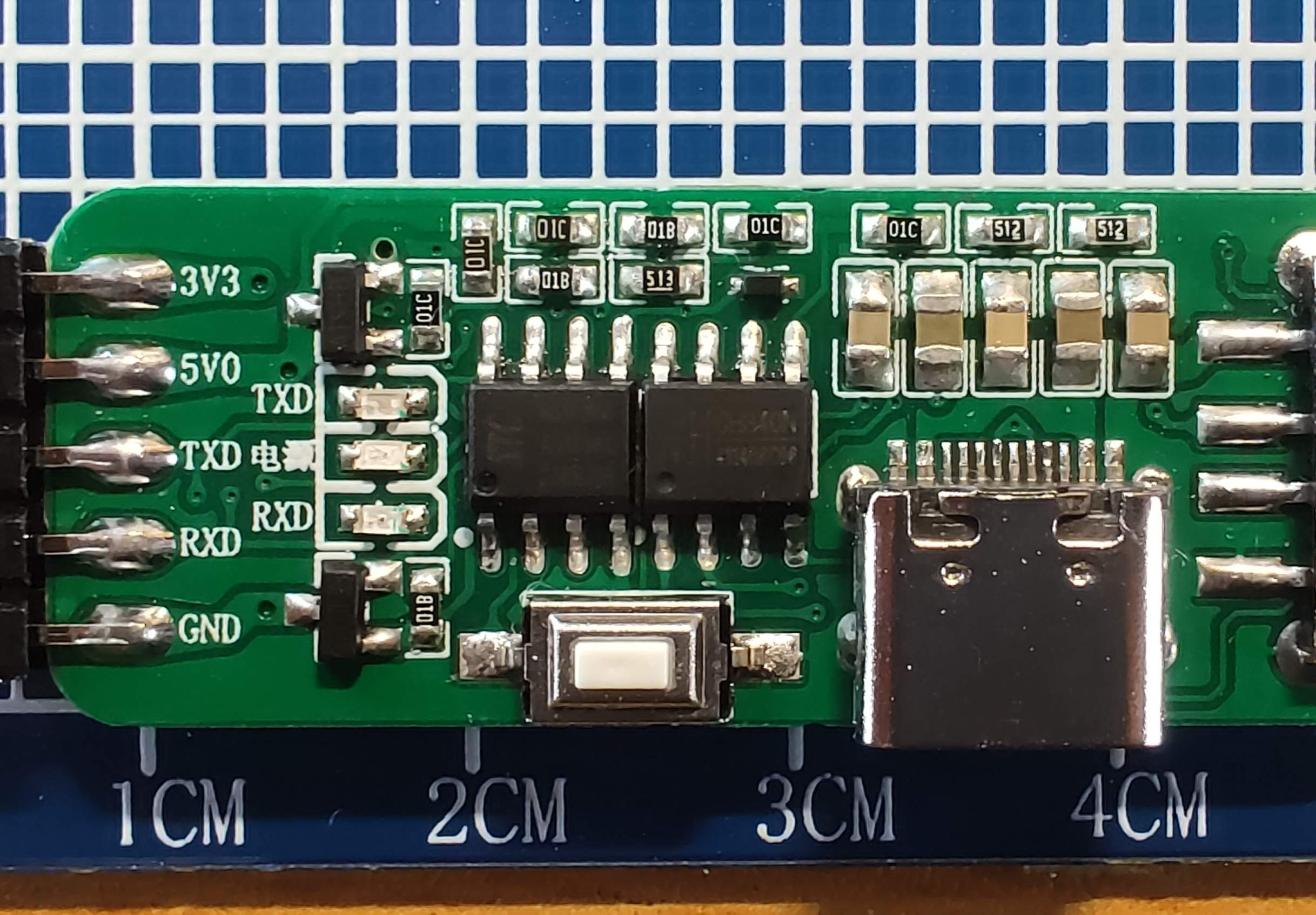

Physical picture:
Function introduction:
Use CH3400N to realize USB to TTL;
onboard TYPE-C female socket, supports dual C line communication; also comes with a USB male connector, which only needs to be used when using Can choose one of the two;
STC microcontroller supports automatic cold start when downloading the program, the success rate is as high as 99.9%;
disconnect the positive and negative poles at the same time during cold start, maximizing the success rate of cold start;
with a manual cold start button, manual cold start has The highest priority, manual cold start can be performed under any circumstances;
long press the manual cold start button to enable or disable automatic cold start;
there are two voltage sources of 5V and 3.3V onboard, and the 5V driving capability is equivalent to the connected power supply. 3.3V can provide up to 800ma driving current;
the power supply, TXD and RXD have independent indicator lights.
Working principle:
Use the STC8G1K08A microcontroller serial port to monitor the data sent by the TXD port in real time to achieve automatic cold start;
STC-ISP will continue to send 0X7F data after clicking to download the program. When a certain number of 0X7F is received, it will control the positive and negative MOS tubes to turn off. off, and then on again after a period of time to achieve automatic cold start;
the 3.3V voltage is converted by AMS1117, and the maximum sustainable current is strongly related to the quality of the device used.
