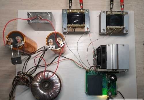

    Emphasize: In the primary circuit of the output transformer, a fuse is necessary! Once, because the contact between the transistor and the heat sink was not tight, the transistor overheated and broke down during operation, and one of my output transformers started smoking. Therefore, good heat dissipation and the addition of fuses can ensure the safety of the circuit.

7. Since there is no temperature compensation circuit, the quiescent current of the transistor will increase as the temperature of the radiator rises; when the temperature of the radiator is constant, the quiescent current is also basically constant. Friends who like traditional cooling methods can calculate the parameters of the radiator according to the actual static power consumption. I recommend the air-cooled radiator with an intelligent temperature control circuit. The biggest advantage is that the transistor can quickly reach thermal balance and stability (this is the determining factor for the stability of the quiescent current, which is simpler, more practical and more reliable than the temperature compensation circuit). Secondly, it can greatly reduce the size and weight of the cooling system. As for the legendary wind noise, it is a legend after all! Modern high-quality low-noise fans and air duct designs are trustworthy.
    The radiator I tested is an air-cooled CPU radiator. The 12V fan is temporarily connected to the filament and powered by 6.3V DC, and the wind noise is almost inaudible. When working, the radiator temperature is basically stable at around 50℃ (air temperature 25℃). Generally, thermal balance can be achieved within a few minutes of power on.
    Here is another picture of the stall. They have been working stably for hundreds of hours, and they should find a shell for them.
