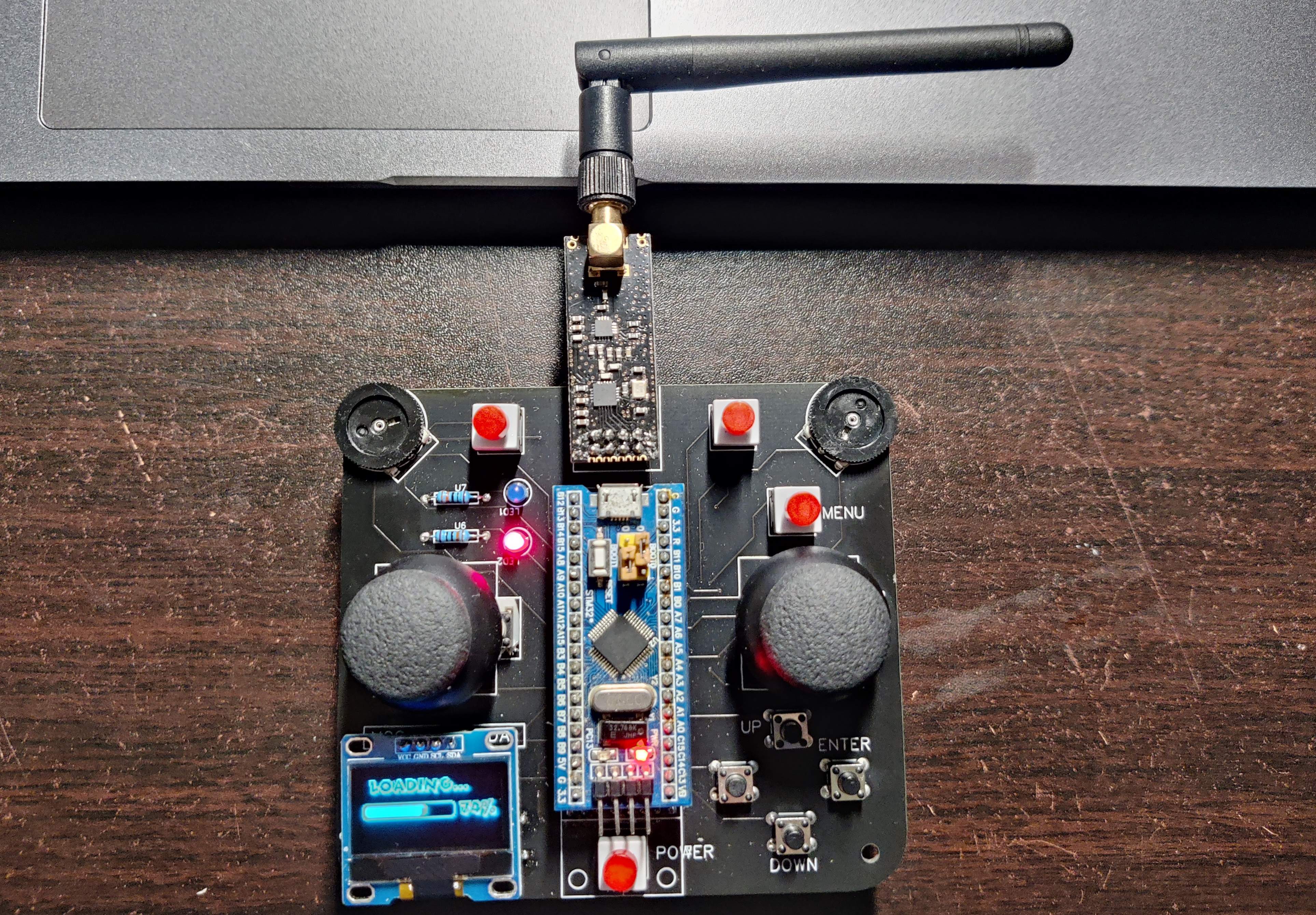

stm32f103c8t6 master control, use ADC+DMA to obtain the values ​​of two joysticks and two potentiometers, then read the values ​​of the remaining 8 buttons, input these 14 values ​​​​into the array and transmit it to the receiver through nrf2401, and the receiver will then Array decoding, used to control the car or others. The screen uses the u8g2 library driver and has many fonts. The mpu6050 part has been drawn on the pcb, but the code has not yet been added.
