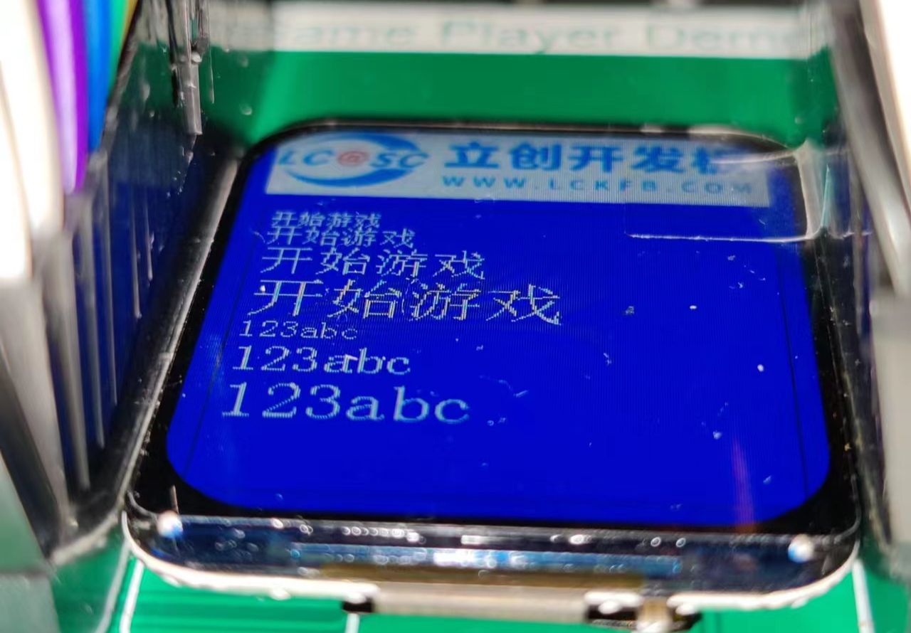

uses Jin Yichen's 1.69-inch TFT LCD display 240x280, the driver solution is ST7789V, and SPI communication is used.
The specific parameters are as follows:
This project also uses EEPROM to provide external font files for the main program. The chip is M24C02, which communicates using IIC. The circuit is as follows:
Actual picture
ps: The pin header is soldered backwards, so only the cable can be used.
