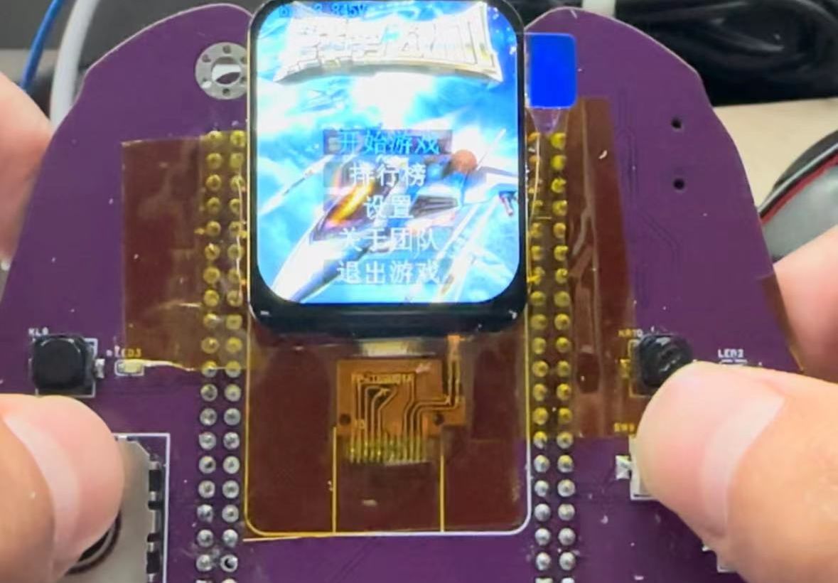

1. Project Introduction
> A game console based on the Liangshan School, which can transplant and run the Aircraft War game. Following Wu Gong, he wrote a Snake program that can be successfully run. The game can be started and returned to the initial interface by pressing the left and right buttons.
2. Hardware function description

3. Process and function
Power module error
> The first version should use a long press to charge and supply power, but it is designed as a sliding switch, causing the electric cold smoke
> First version
> ![Picture.png] > Second version: The power supply of Lichuang has been slightly modified. The components are a bit dense, so it is heated directly on the heating table.
> ![WeChat picture_20230518133100.jpg] > ![Picture.png] > The terminals of the power supply are also set a bit wrong. Wrong, it's wrong. I used a 14500 for power supply, but it is more stable to use the typec terminal directly for power supply
> ![Picture.png]
The screen voltage is wrong
> Experience: Remember to read the reviews when buying, the description says the power supply is 3.3V, the result is super dark , there are also many times of desoldering that you need to pay attention to, the pins are easy to break, and pay attention to the isolation of the screen
> ![Picture.png]
Missing components and over-purchased components
> Flying wires solve the problem, but it doesn’t look good, but it still works For use, the pcb and schematic diagram have been modified~~~~
