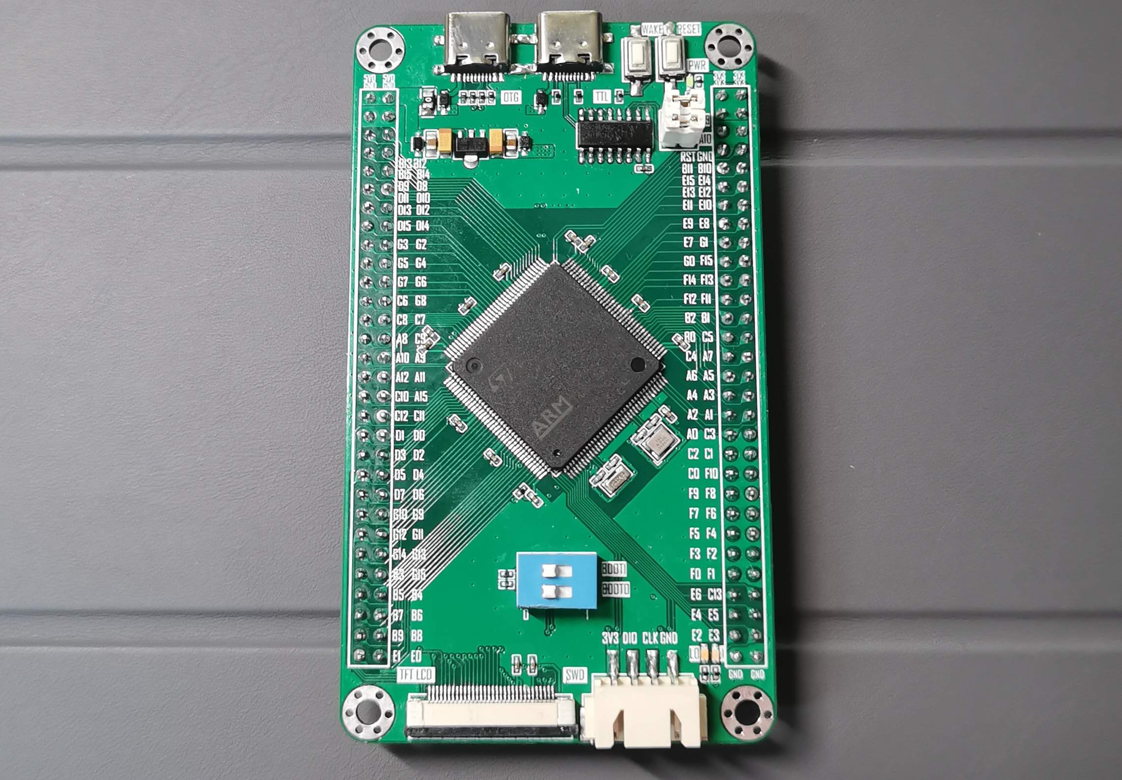

STM32F407ZGT6/ZET6_V2_2
STM32F407ZGT6_STM32F407ZET6 general-purpose minimum system board
schematic file and Gerber are shown in the attachment

Function introduction:
① Lead to the 109 IO port
② Two type-C interfaces, one is USB_OTG and the other is USB_UART (CH340C, you need to plug in the jumper cap of A9A10 when using the serial port)
③ A wake-up button, a reset button
④ 8080 and LCD interface
⑤ SWD download interface
⑥BOOT setting (implemented by toggle switch)
⑦TF card
⑧The
total cost of spare battery base materials = chip + 10 (currently 2023, July, 29: chip is 41 yuan)
Physical display
reference
punctual Atomic
Wildfire
Anti-Customer Technology
Lichuang Liangshan School
has been tested Successful peripheral
lighting, serial port printing, ADC
DAC-generating 4KHz sine wave
4.3-inch TFT screen test successfully (see the homepage open source project for the FPC-TFTLCD adapter board)
