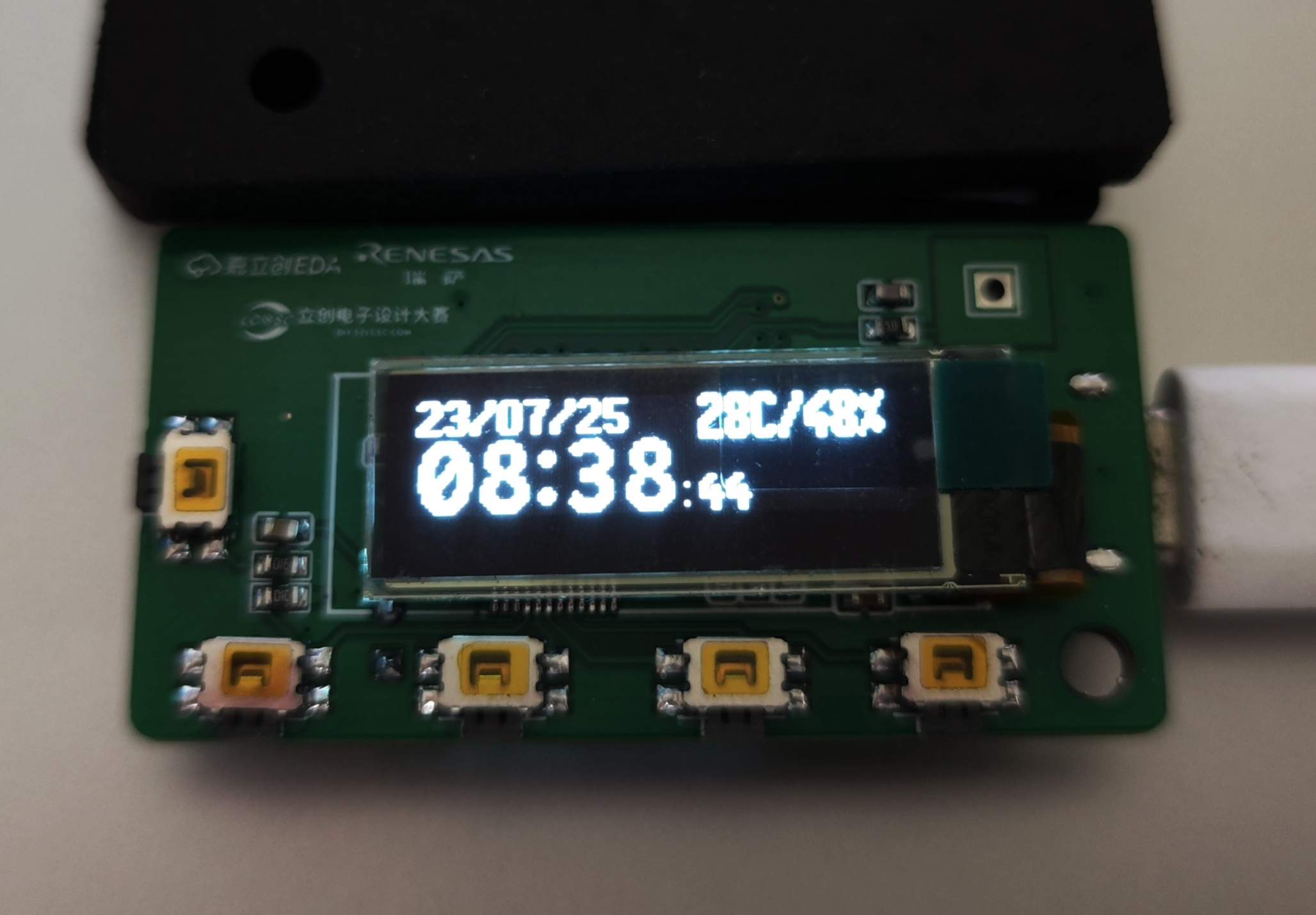

1. Project function introduction
Desktop clock based on Renesas chip
1. Display date and time
2. Display temperature and humidity
3. Set alarm
2. Project attributes
are disclosed for the first time, #EDA Summer Training Camp 2023# Learning project, test verification, competition
3. Open source agreement
Public Domain
Please fill in during the competition stage↓
4. Hardware part
Hardware PCB, 3D printed shell and panel are all made by Lichuang EDA.
MCU is Renesas's R7FA2E1A72DFL, temperature and humidity sensor uses DHT11 module, display is 0.91 inch OLED screen, and a touch-sensitive button is preset.
Note: The panel has been made but has not arrived yet, and will be supplemented later
5. The software part
is developed using Renesas' official e2 studio, and the display part uses u8g2 library, which supports power-off to save the last time. *6. See the automatically generated BOM below
