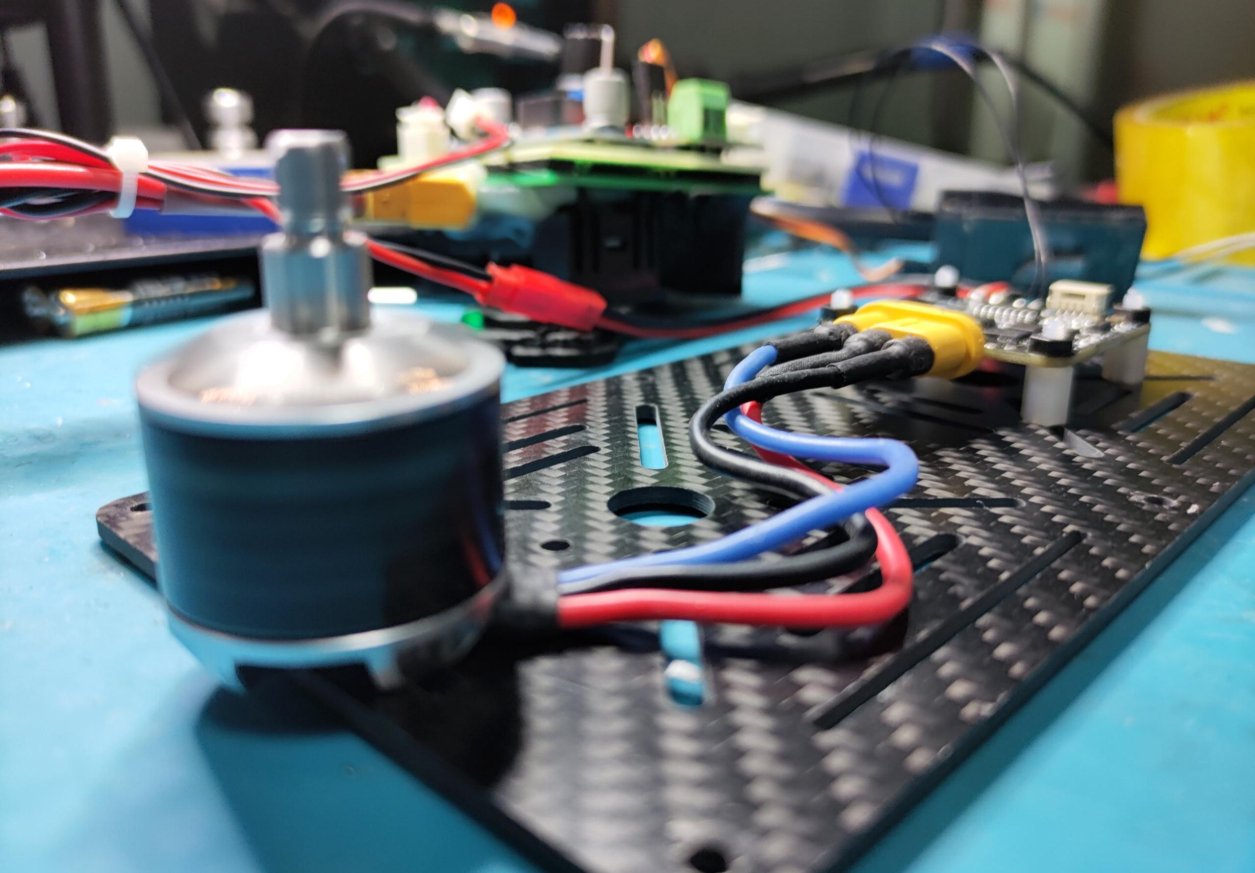

Learn from this article: Mozilla author [I Love Loli Loves Loli] 2020 new version of brushless ESC DIY tutorial https://www.moz8.com/forum.php? mod=viewthread&tid=182113&fromuid=111906 Without further ado, here’s a video:
https://www.bilibili.com/video/BV1yJ411J7aX/
[Drone] Brushless ESC learning path)
1. Hardware selection 1. MOS tube selection: AON6407 + AON63542. Microcontroller selection: STC15W408AS-35I-SOP163. Voltage regulator tube selection: AS78L05RTR-E14. Transistor selection: SS80505. Power supply interface selection: XT30PW-M6. Firmware programming interface: GH125-S04DCA-007. Resistors, capacitors and other other components are according to the table*** Some components are different from the author of the original post. More suitable components are selected through personal experience***
2. Circuit board design
This project uses [Jialichuang EDA software]( Designed by https://lceda.cn/), Jialichuang’s EDA software is very suitable for beginners and easy to get started. There are official free tutorials, which are worth recommending. The design drawing is as follows: 8. Schematic diagram
