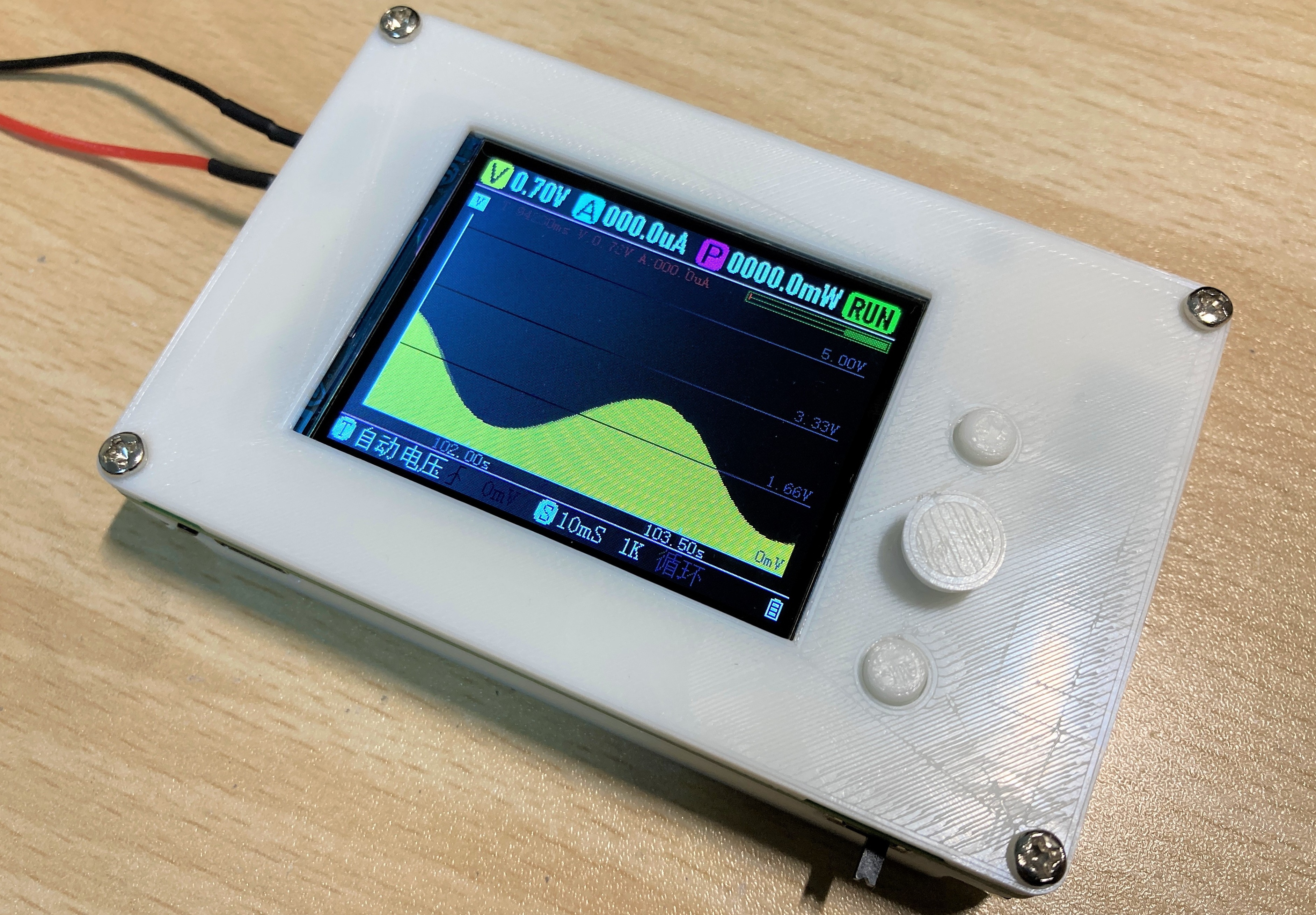

# 1. Introduction to project functions
![image.png] I have previously made a low-power mobile device powered by a battery. In order to evaluate the battery life, it is necessary to know the power consumed by the device in a sleep cycle. Because the working current of the device is constantly changing, ordinary multimeters are not competent, so a precision power meter that can measure, record, and analyze current changes is needed. However, this kind of professional-grade instrument is very expensive, and it is not cost-effective for a project to practice hands, and it is not convenient to use an oscilloscope plus an amplifier circuit. So this project was born.
This project is a small, portable precision power meter that can measure a current of up to 1uA. It has a 2.4-inch QVGA screen that can record the current consumption of the device or the voltage change of the power supply, and display it in a graphical way, which is convenient for power supply or power consumption analysis. The body has its own battery and supports completely offline operation without the need for a host computer. At the same time, the sampled data can also be uploaded to the PC for more detailed data analysis. It supports trigger sampling function, which can easily record occasional events. The maximum sampling rate of 100SPS meets the needs of most scenarios.

The basic working principle of the device is shown in the figure. This project is essentially a packaged voltmeter plus an ammeter, but it has additional functions for sampling, storing, and processing test results, which can be used to observe the changes in voltage or current over time, or to analyze data for a specified time period.
