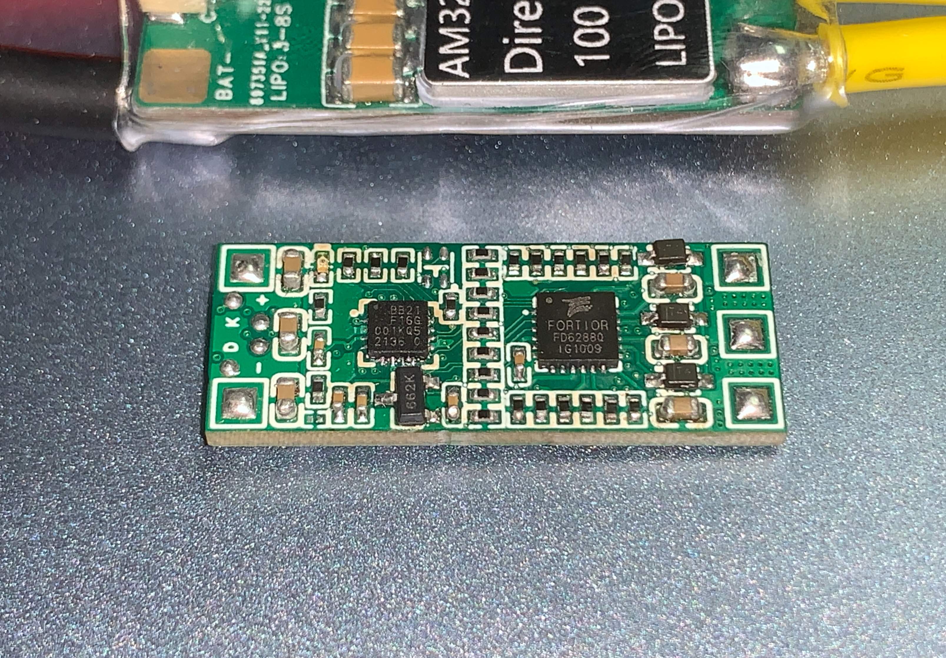

Single brushless motor ESC (ESC) based on BLHeil_S firmware
This ESC uses open source firmware BLHeli_S, the firmware type is JH-30 (why this, because it is best to wire), and is compatible with Bluejay firmware.
BLHeli firmware address: GitHub - bitdump/BLHeli: BLHeli for brushless ESC firmware
There are many online tutorials on how to burn the firmware of this ESC, so I won’t go into details here.
This ESC was originally created for personal testing of BLHeli_S, paving the way for subsequent four-in-one ESCs.
Due to personal drawing board habits and only for testing purposes, limited by volume, the overcurrent capability of this PCB is not guaranteed.
The theoretical maximum withstand voltage of the ESC is 20V, and it is recommended to supply power for 3~4 seconds.
