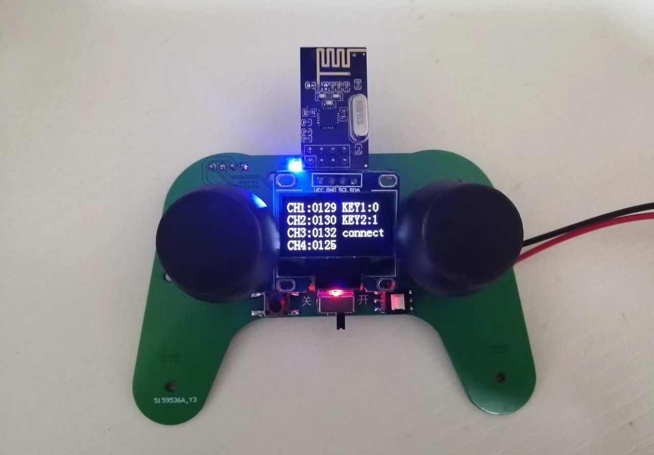

Remote control based on HK32F030MF4P6
 A 6-channel remote control based on HK32F030MF4P6 microcontroller, with 4 proportional channels and 2 switch channels.
Hardware list:
1 HK32F030MF4P6
1 AMS1117
2 10K rocker potentiometers
2 tact switches
1 self-locking switch
1 NRF24L01 module
1 0.96 OLED (especially note that I am using an old version of OLED, the pin order They are VCC, GND, SCL, and SDA. The order of the new version of VCC and GND is reversed, and smoke will emit when plugged in.) The cost of
some resistors, capacitors, etc.
can be controlled at least within 20 yuan.
This project is based on the project from yinghuan.zeng
https:/ /oshwhub.com/yinghuan.zeng/ji-yuhk32f030m-di-dan-shou-yao-kong-qi-674182a
Since I have just started to come into contact with 32-bit microcontrollers, my programming level is limited. The program is modified based on the original author's work. The original 2-channel ADC is expanded to 4 channels.
Receiver link: https://oshwhub.com/myself1820/ji-yu-hk32f030mf4p6-de-jie-shou-ji.
Updated program on May 31st.
