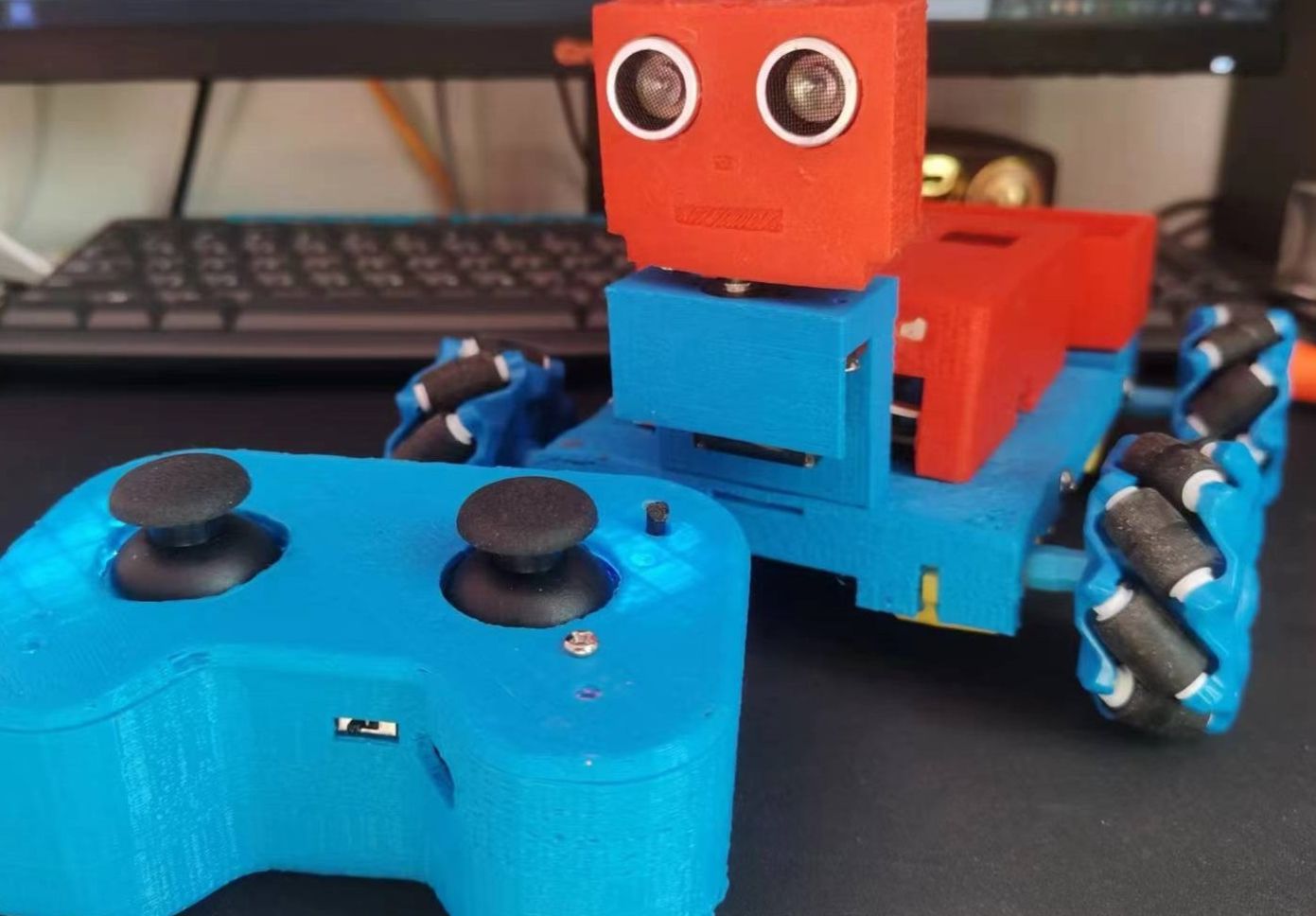

Hetu Car (ESP32)
Demo address: https://www.bilibili.com/video/BV1X44y1Z7kE/?spm_id_from=333.337.search-card.all.click
TC1508S motor driver board, ESP32 module development, leads to all output pins, can also be used as an ESP32 development board use.
1. Hetu_v1.4
2. Hetu_v1.4-mo adopts modular circuit to reduce welding
3. The difference between Hetu_v1.5 and Hetu_v1.4 is the use of DC-DC 5V3A module Voltage, both versions can be used.
The motor drive module voltage can be selected through a jumper cap to 5V or 7.4V.
