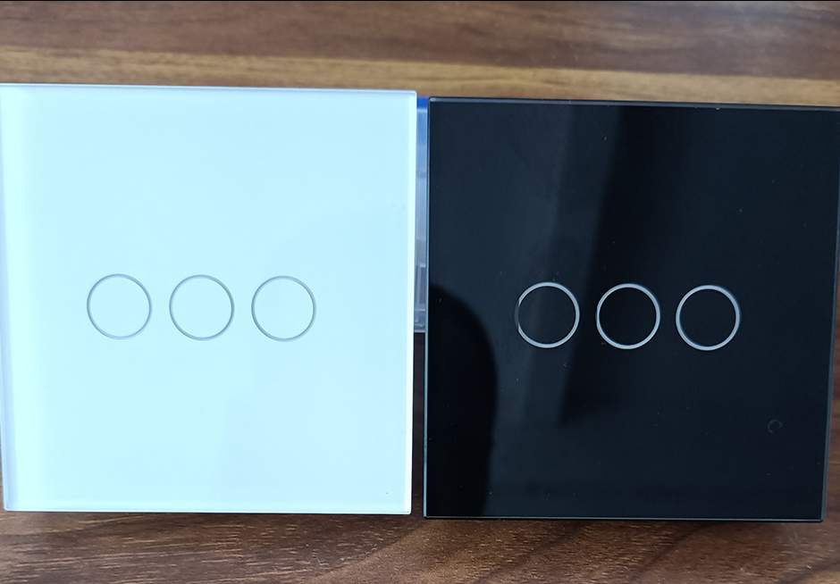

Project description:
       This switch has been used in my store for more than half a year. This switch is because I often forget to turn off the lights, so I made this project by referring to various information to facilitate myself to turn the lights on and off remotely. After this period of modification and revision, the source code of the APP was modified to adapt to the IoT devices developed by myself.
       ESP12-F's three-touch switch, each switch is controlled by an independent TTP223-BA6 touch switch. The consideration at that time was that it could be changed to one-on or two-on at any time.
       Finally, one more nonsense, this switch is for personal use, so the hardware cost is not considered.
Picture of the finished product: Originally there was a gold one, but I didn’t take the picture while it was in use.
