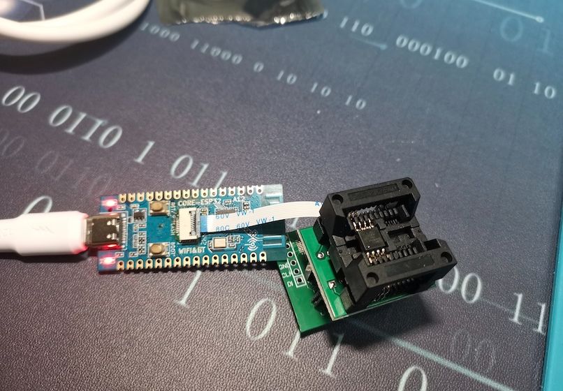

## Introduction:
Use Hezhou 9.9's ESP32C3 to make a NorFlash programmer and burner. Supports NorFlash burning in SOP-8 package within 16M.

## Notes:
- This PCB is actually a splicing of three boards. The proofing fee of Jiali Chuang is relatively high. I spent 74, T_T. The sponsor is free to choose~
- The soldering of the SOP-8 adapter is more troublesome, and the FPC pins are particularly easy to be tinned. After soldering, use a multimeter to test whether it is normal.
- When placing the FLASH chip, pay attention to the position of pin 1, and don't put it upside down.

- ##### Test burning socket to burn FLASH chip
! [Burning socket burning test.jpg]
- ##### Test 6-pin FLASH module on Xbao
! [Test 6-pin NORFlash module on Taobao]
- ##### Test TF-connected FLASH module
! [Test TF-connected FLASH module]
- ##### Check FLASH capacity on the computer
! [Check FLASH capacity size]
- ##### Save the firmware in FLASH on the computer
! [Save the firmware in FLASH]
- ##### Burn the firmware to FLASH on the computer
! [Burn firmware to FLASH]
