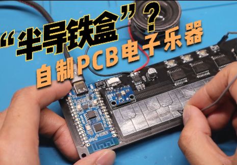

PCB electronic musical instrument
It is a copycat of a stylistic instrument. It only imitates the keyboard and operation methods, but does not have the essence of electronic sound.
Very simple, just for fun,
use ESP32C3, AD9833, LM4781, PCF8574T, speakers, and potentiometers.
The principle is very simple. I2C scans the input status of the three PCF8574T pins and controls the AD9833 to output a waveform corresponding to the frequency when a low level is detected.
A very simple but very interesting project that uses SPI, I2C and IO input at the same time and is very suitable for beginners getting started with Arduinio.
The code is in the attachment (Music BOX.zip)
