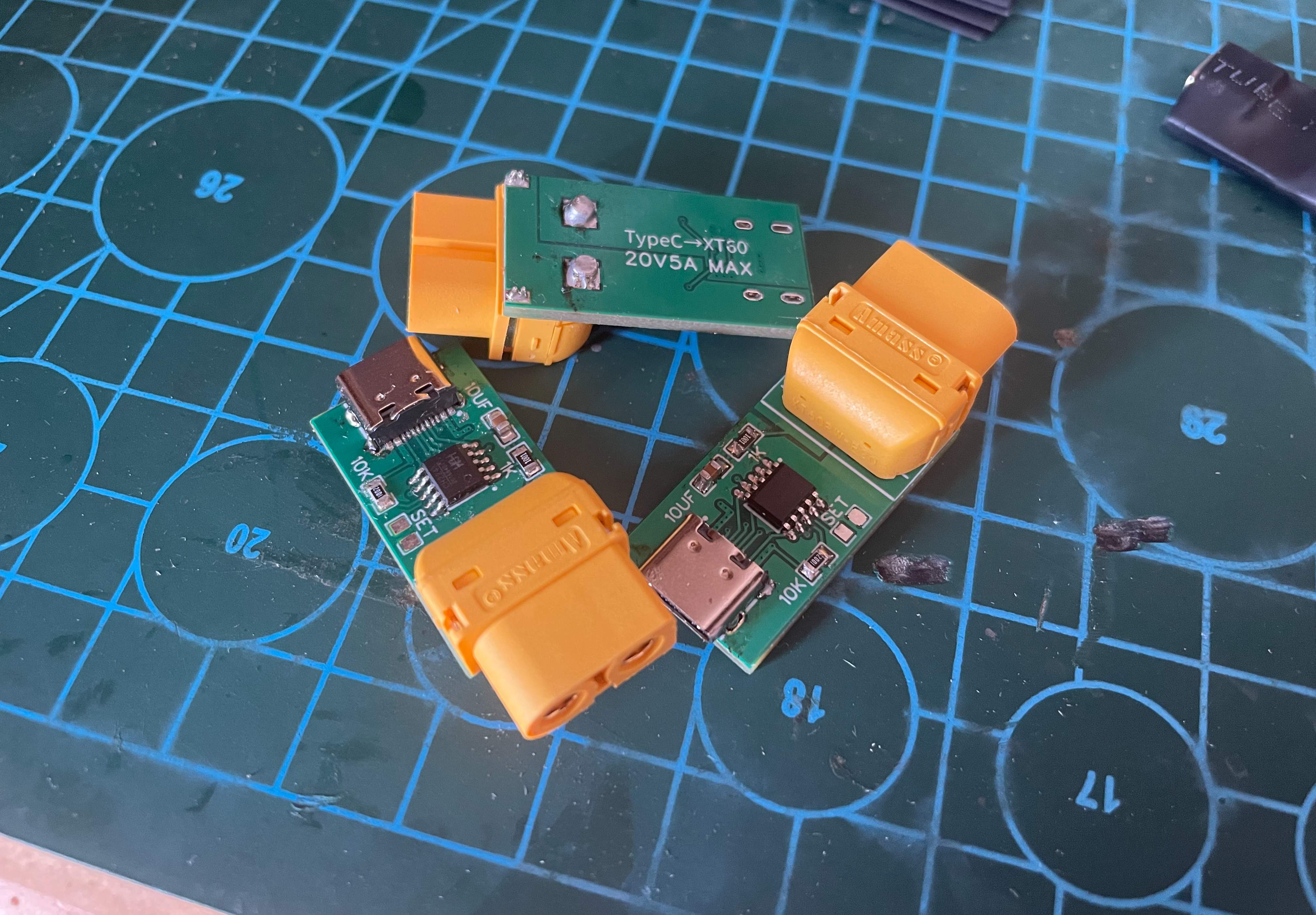

typec fast charge to xt60
### Use ch224k to trick 20v and use xt60 output, which is convenient for powering the aircraft model charger in the field
###### Test picture↓
![IMG_1834.JPG] ###### The output voltage can be changed by placing resistors according to the table↓
| Voltage| 5v | 9v | 12v | 15v | 20v |
| SET position resistor| Short|6.5K | 24K | 55K | Empty|
###### The XT60 interface uses XT60PW-F (it seems that there is no LiChuang Mall).
The board was made in jp (whisper )
