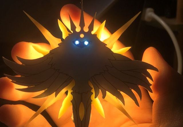

The schematic diagram of the radiant small ornament made based on the SGL8022w chip
refers to my snowflake lamp: [Touch stepless dimming snowflake lamp (ceramic filament)] (https://oshwhub.com/mondraker/snow_light)
Please purchase the components by yourself (BOM list) Not allowed):
0805 resistor 20R (4 pcs), 200R (1 pc), 1K (1 pc), 47K (1 pc)
0805 capacitor 10nF (1 pc), 100nF (2 pcs), 10uF (1 pc)
SOT- 23 package S8050 NPN type transistor (1 pc)
SGL8022W
ceramic filament 26mm 3V 2700k warm light (4 pcs)
type-C vertical 2P female base
requires an additional hot melt q to fix the female base.
This board can be used as a welding practice board , the 0805 package is not small but not big either, suitable for beginners to practice.
