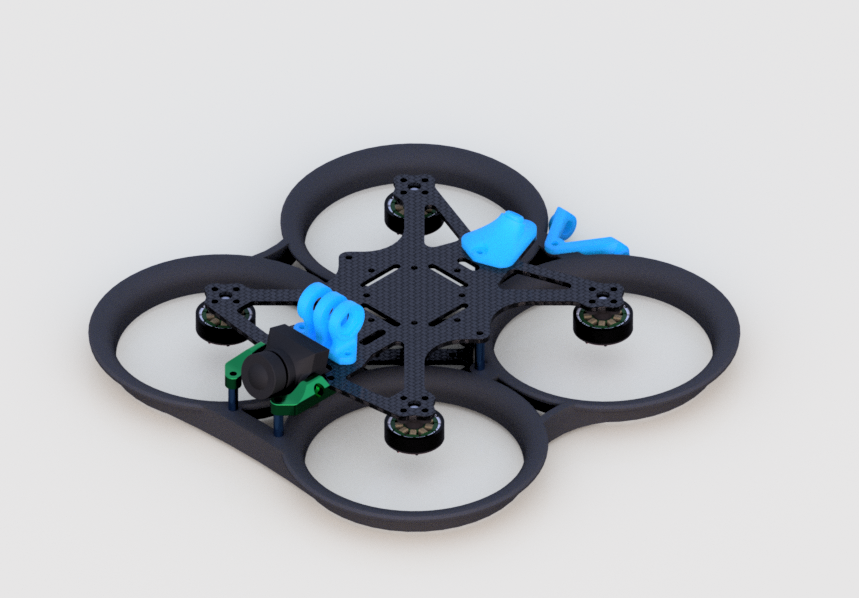

2.5 inch FPV drone frame
The wheelbase is 112mm, and
can be used to install flight controllers with 20mm and 25.5mm hole pitches.
The motor mounting hole pitch is 9mm, and
the camera seat is 19mm.
All are fixed with M2 screws with lengths of 5mm, 6mm, 8mm, 10mm, 14mm, and 16mm;
M2 nuts and copper columns are also required;
***Upper board***
* V1.0 version: does not contain any electrical properties, only used for fixing
* V1.1B version: a buzzer is added to the upper board (no welding is required)
***Bottom board***
***LED driver bottom board***
Used for atmosphere lights and lighting drivers, verified, very cool, with 12V COB light strips, 2 3W lamp beads, illuminate your beauty.
The V1.0 version rack picture is as follows for reference
