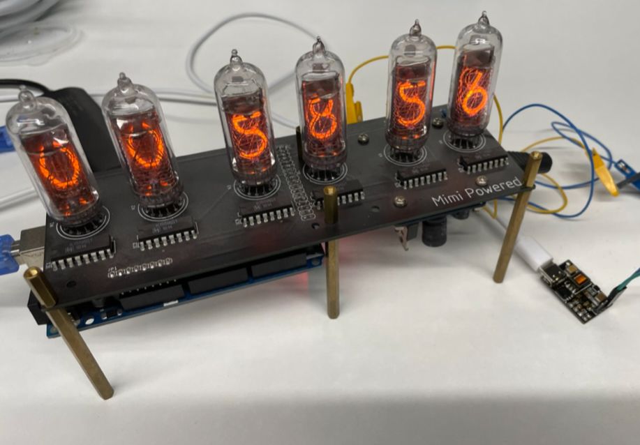

The coupled inductor Boost circuit achieves a 5V boost to 170V, capable of driving at least 6 IN-14 Nixie tubes. The solution is similar to the NCH8200HV produced by OMNIXIE.
Capacitor C5 has requirements for withstand voltage and needs to be purchased separately.
