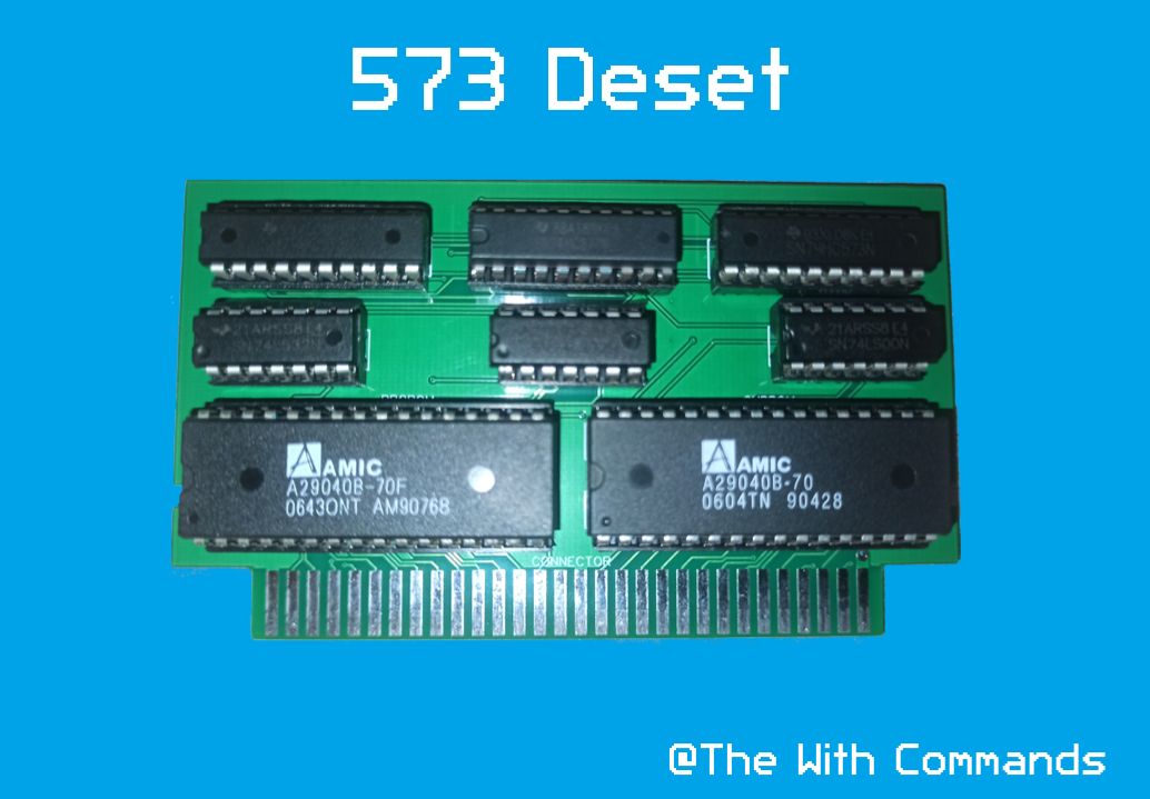

[FC Custom Mapper] 573 Deset Cassette
The maximum supported capacity of PRG ROM and CHR ROM is 512kB.
Bank mapping is similar to Mapper 78.
Overview:
PRG ROM Bank size: 16kB
CHR ROM Bank size: 8kB
PRG RAM: Does not exist
Name table mirror: Controlled
bus conflict: exists (please refer here)
Bank mapping:
CPU $8000-$BFFF: Switchable PRG ROM Bank , total size 16kB
CPU $C000-$FFFF: 16 ​​kB PRG ROM Bank, fixed in the last Bank
PPU $0000-$1FFF: switchable CHR ROM Bank, total size 8kB
Bank selection data input ($8000-$FFFF):
76543210 bits
||++++++- Give latch related data
|+------- PRG ROM latch flag (0: latch; 1: open)
+ -------- CHR ROM latch flag (0: latched; 1: open)
PRG Bank selection:
543210 bits
+++++- Select 16kB for CPU $8000-$BFFF PRG ROM Bank
+------ Name table mirroring status selection (0: horizontal; 1: vertical)
CHR Bank selection:
543210 bits
++++++- Select for PPU $0000-$1FFF 8kB CHR ROM Bank
参考设计图片
