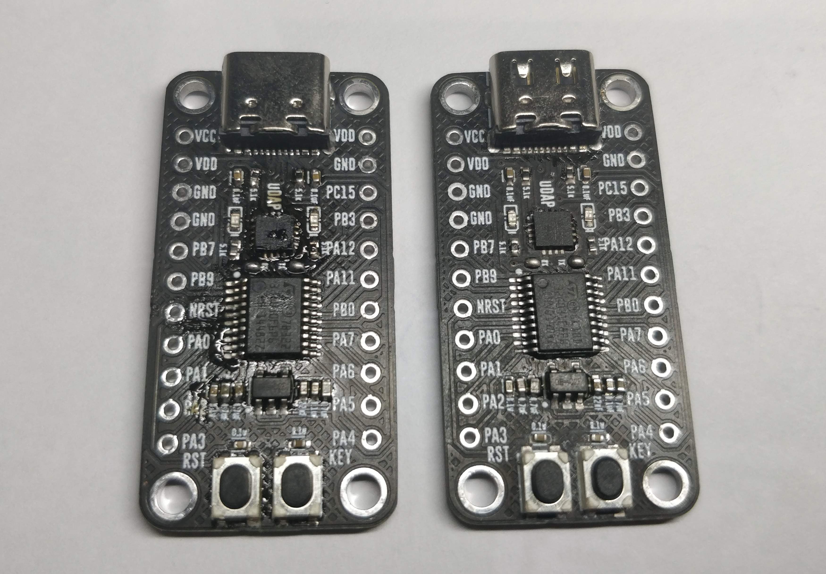

stm32g03xf6/8 mini board [minimum system] [development board]
On-board debugger, usb-uart, LED
does not lead to the swd debugging pin, and the LED pin
uart1 can select USB through the soldering jumper on the board. If connected, it means that the
stm32g030f6p6g031f8p6
symmetrical design is supported by connecting the USB test. I think it is quite good-looking.
When connecting to the computer for the first time, ch552p automatically enters the usb download mode. You can burn the program in the appendix through wch-isp and burn cmsis-dap v2.
If you do not enter the usb download mode, congratulations on buying a refurbished film
because it does not provide any The interface enters download mode, so please be sure to buy a brand new ch552p
