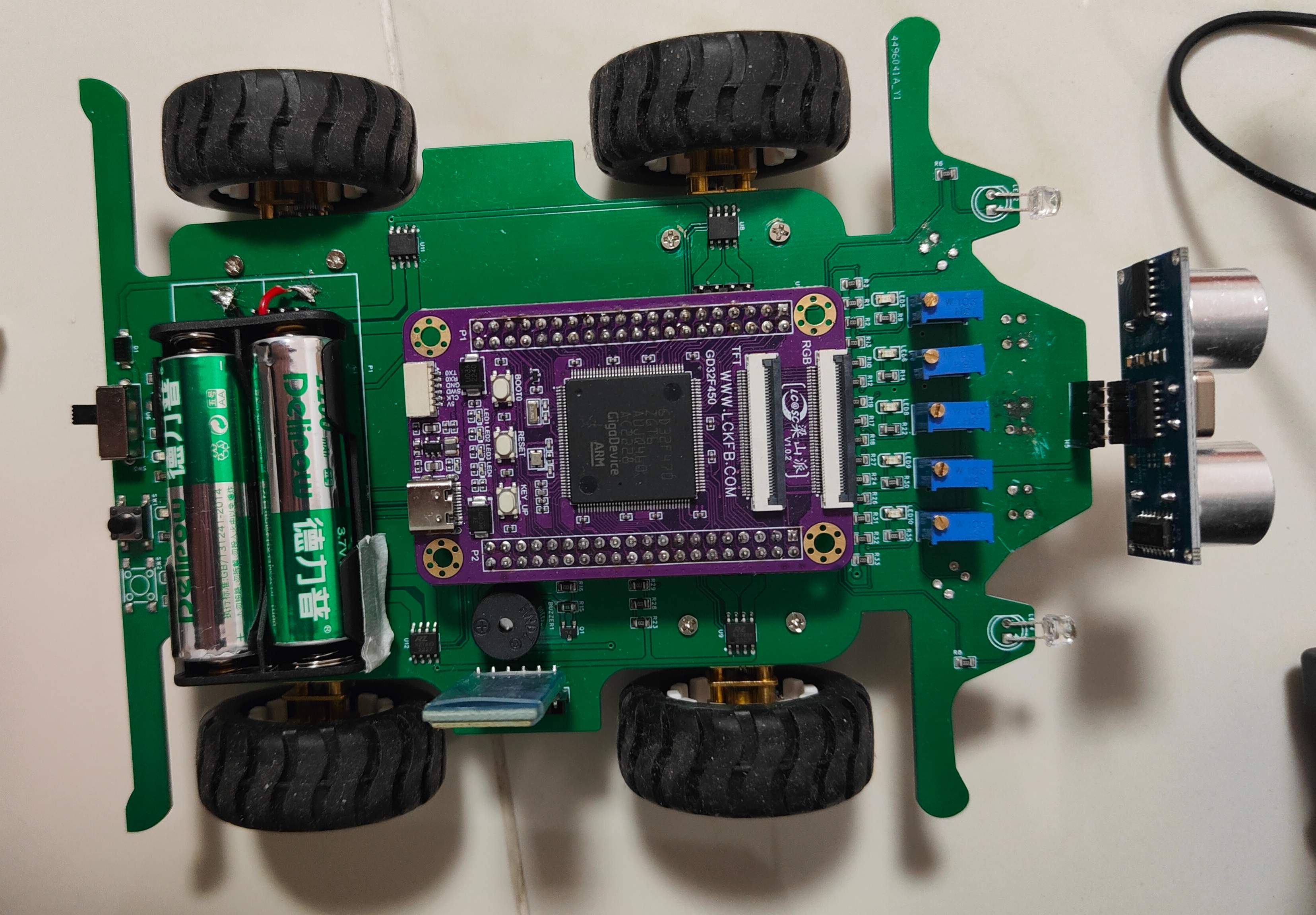

###### Smart car project description
   The smart car uses two lithium batteries (7.4V), which are reduced to 5V through a step-down chip to power the microcontroller system. This system includes the following circuit modules: Lichuang·Liangshanpai core board and The LED lights, button circuit, obstacle avoidance circuit, tracking circuit, ADC voltage acquisition circuit, Bluetooth remote control circuit (wireless remote control function), buzzer, and motor drive circuit on the smart car expansion board.
1. Scheme design
The smart car uses two lithium batteries (7.4V), which are reduced to 5V through a step-down chip to power the microcontroller system. This system includes the following circuit modules: Lichuang·Liangshanpai core board and smart car expansion board LED car lights, button circuit, obstacle avoidance circuit, tracking circuit, ADC voltage collection circuit, Bluetooth remote control circuit (wireless remote control function), buzzer, and motor drive circuit.
2. Hardware introduction
2.1 Power supply
BAT is two lithium batteries (7.4v) connected in series.
D1 is a Schottky diode, which prevents reverse connection.
SW3 is a sliding switch that controls power on and off.
U6 is a linear voltage regulator that reduces the input voltage to 5V to power microcontrollers and other devices.
C1 and C2 are bypass capacitors, which play a filtering role.
LED7 is the power indicator light, which lights up in red after power is supplied.

! [Screenshot 2023-02-26 232311.png] 3. Physical picture
! [IMG20230226214042.jpg]
