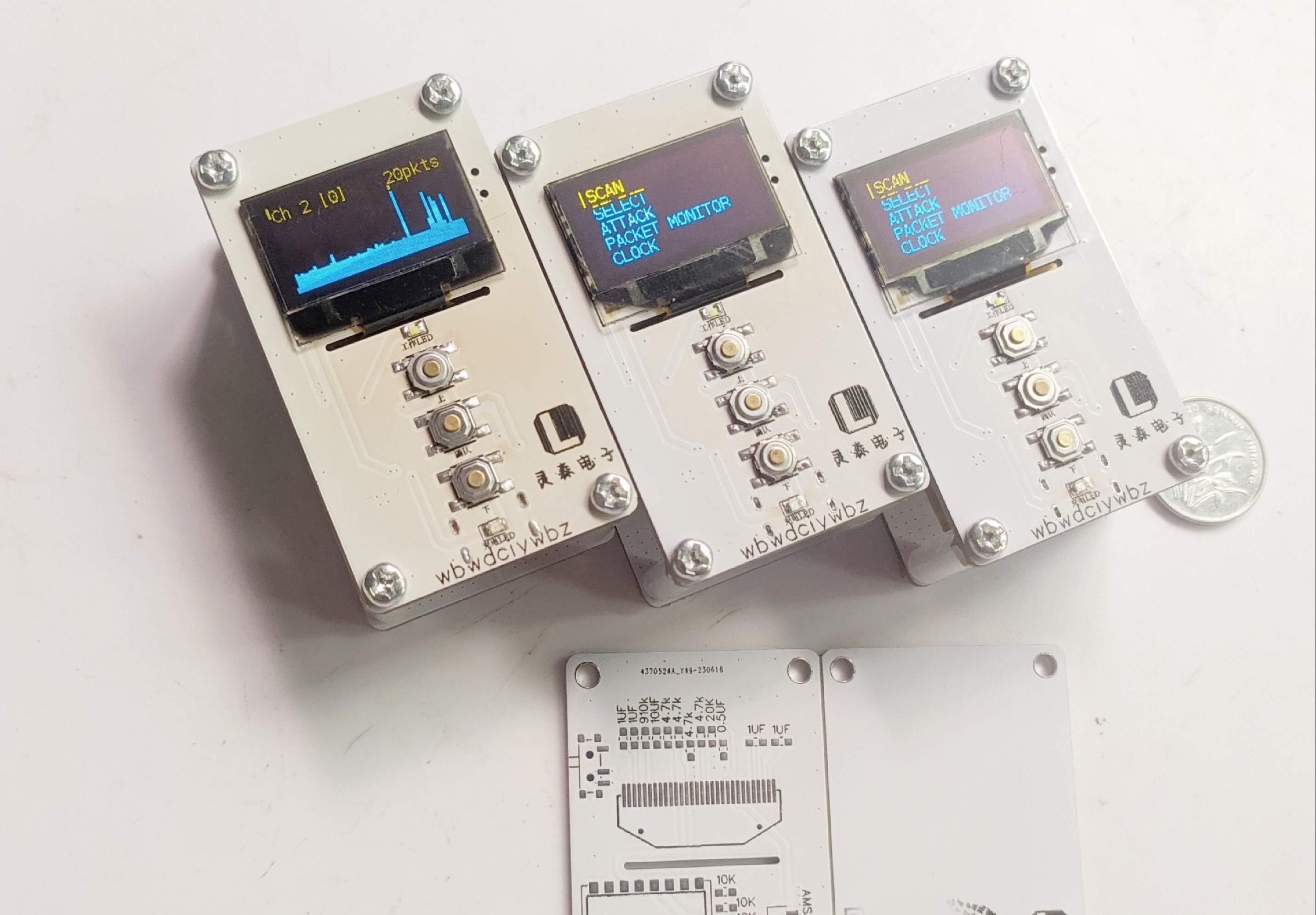

ESP8266_Deauther is a program running on the ESP8266 development board. It can deauthentication attacks interfere with Wi-Fi and prevent users from accessing Wi-Fi to paralyze it.
Of course I don’t recommend that you test on an unfamiliar network because it’s illegal!
What can it do?
Flood attack, network paralysis
WIFI cloning (confession or advertising machine? Customizable WIFI name confession and advertisement, up to 60)
Channel detection (detection of network transmission activities of the channel)
Note: The above can only be used for 2.4g signals, 5g and convergence are not supported
Other parameters
Antenna: Eight-eye antenna (not tested by professional equipment, the actual effect is OK)
Charging interface: Type-C
Reproduction Notes
There is no burning circuit on the PCB, and the C port can only be charged, which means that you You need to use a burner to burn, and then solder the esp8266 module to the pcb, which may be difficult for beginners.
My suggested solution is to use the esp8266 development board to solder the esp8266 module to the development board, connect it to the computer for burning, and then remove The lower module can be welded to the pcb board of the project (you can see my other project for the development board, or buy it on the shopping platform). It
is fixed with 3m screws + large-tip pen refills (note that it is not ordinary gel pen refills).
The screen is driven by SSD1315 0.96 Inch OLED screen, many of the switches on Moubao
are 7-pin switches
because the module has an antenna base that can be used to extend the antenna, so you need to buy an antenna. Of course you can use the onboard antenna module, but then the Yagi antenna will be useless (the effect of the Yagi antenna is much greater than the onboard antenna)
