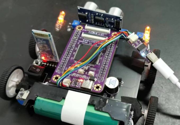

### Front! [Screenshot 2023-05-31 092624.png]
* There is a Liangshan School interface on the front of the car, and a 3.7V battery at the bottom.
* There is an ultrasonic obstacle avoidance 4pin plug in the front, and the IP5306 boost charging module designed by myself in the lower left corner is used to charge and discharge the battery.
* A boat switch and two patch buttons on the left are used to switch modes and start and stop the car.
* The upper part is the adjustable resistor and LED light of the car's obstacle avoidance module!
* The right side is the buzzer and the 1.54-inch ink screen FPC interface, which uses SPI communication, and the middle is the Liangshan School double-row pin header

Actual object![微信图片_20230531095350.jpg]
* ![微信图片_20230531095356.jpg] * The actual object is shown in the figure above
* The hardware introduction is completed, and the software is introduced next
* First look at the requirements as shown in the figure
