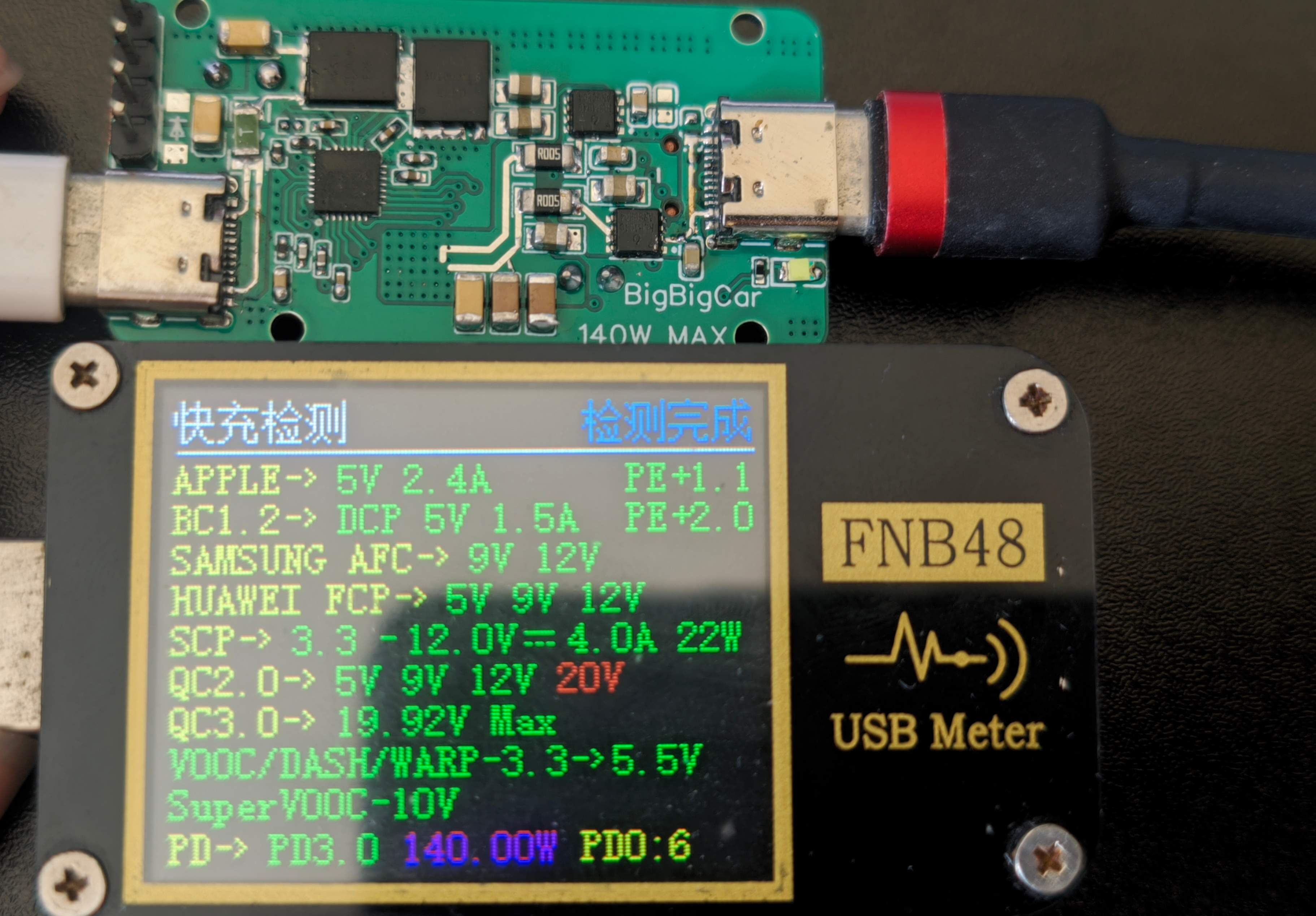

sw3538/sw3536 140w power module
Note: It is best to use capacitors with a withstand voltage of 35v or above at the input end, and capacitors with a withstand voltage of 25v or above at the output end. If the withstand voltage is not met, an achievement (electronic firecracker) will be achieved;
support OPPO's SUPERVOOC
compared to 3518s, pd The maximum fixed gear is 20v7a, the maximum pps is 6.35A (a major upgrade, mobile phones basically use pps), with the addition of SUPERVOOC, the static power consumption is lower 24v 0.02w.
C port protocol support:
A port protocol support:
Mi 11u 30W
k50g 65w
note11pro+ 90w
mix4 40w
meter 10u 45w
supervooc's 65w
Huazi series 20w
v I estimate it is only around 20w PDQC. I haven't tested it. Anyone who has tested it can tell me that
sw3536/sw3538 can be used universally. 3536 has less protocol
schematics and BOM objects that may be incomplete.
It is recommended to select materials according to the PCB objects.
