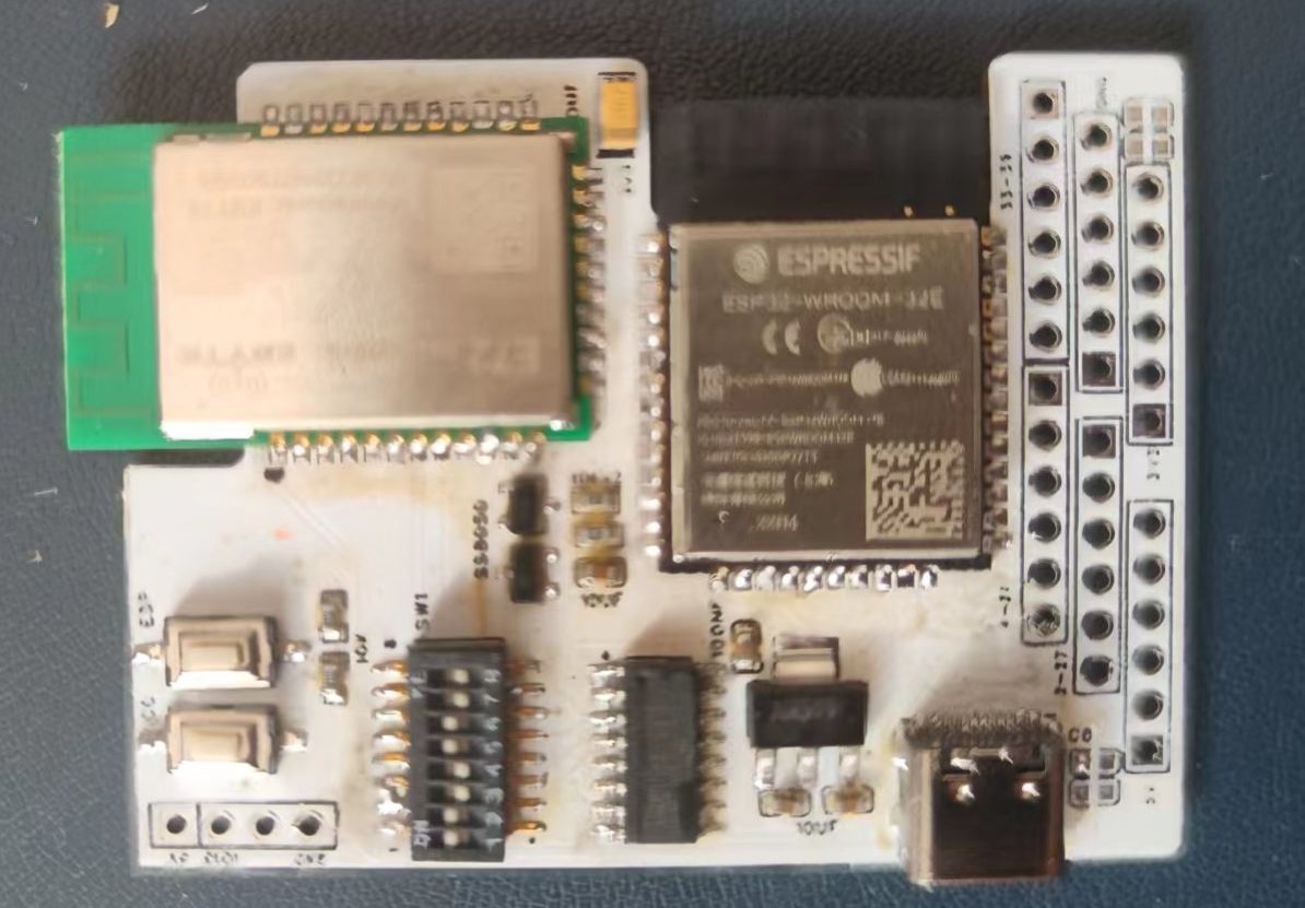

is learning EDA drawing, learning Espressif's esp, and trying to draw a multi-functional home gateway of esp.
This prototype is based on the white ape zigbee gateway of station B.
I created a group: 473746756 to facilitate communication.
If you are interested, please leave a comment area. Multiple pointers and
real objects
can be extracted from the io to facilitate subsequent addition of modules. Screen
addition module
DHT11. Temperature and humidity sensor
PIR. Human body sensor
connection module.
Bluetooth. Xiaomi Door and Window Sensor 2
is connected to HOMEASSISTANT. Burn the
firmware
in 2 steps. First burn the CC2652P firmware, and then burn it. If the gateway firmware
DIP switch 12 56 is ON,
first go to tasmota to burn the normal version of the zigbee pro firmware, and then burn the zigbee firmware of SonoffZBPro_coord_20220219.hex into the cc2652p (for example, set the DIP switch 34 78 ON to the cc2652P direct serial port, which can be directly connected to the serial port) Use windows to burn zigbee firmware)
and then burn ESP_gateway_20221121.bin to esp32.
Connect to esp's wifi. Configure connection routing and
configure IO.
Complete to get a zigbee+BLE+ integrated multiple sensor home gateway
