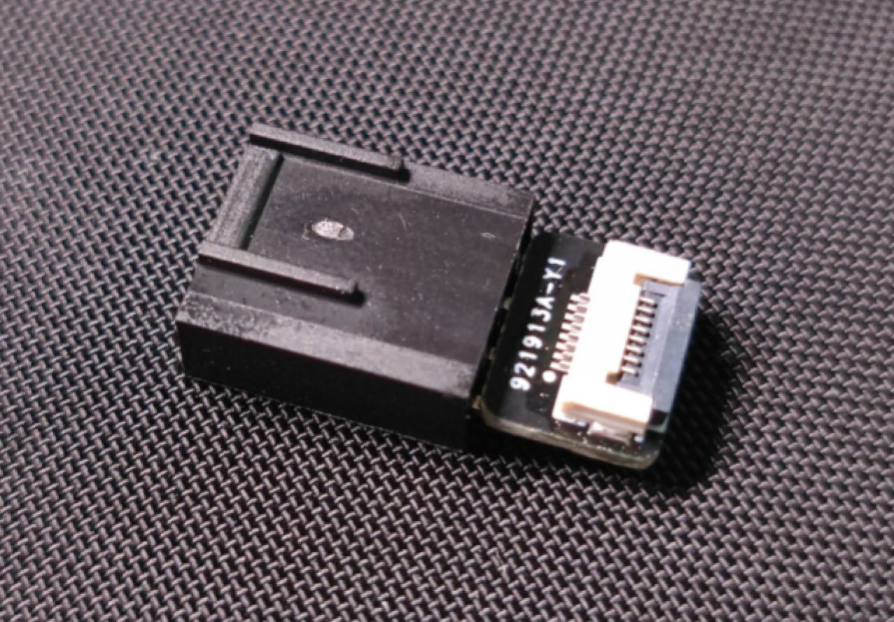

4090 original fan FPC to 4pin plug
Since the FPC width of this fan is wider than the total pad, an 8p connector is used (h1.5 clamshell type below). Please use a pin header for soldering on the 4p end, and crimp or weld the fan 4p terminal on the pin header. Attached are some real shots, as well as an axp90 adapter board, which requires ABS glue to adhere the buckle, four m2*3 self-tapping screws, and a thickness of 2mm.
