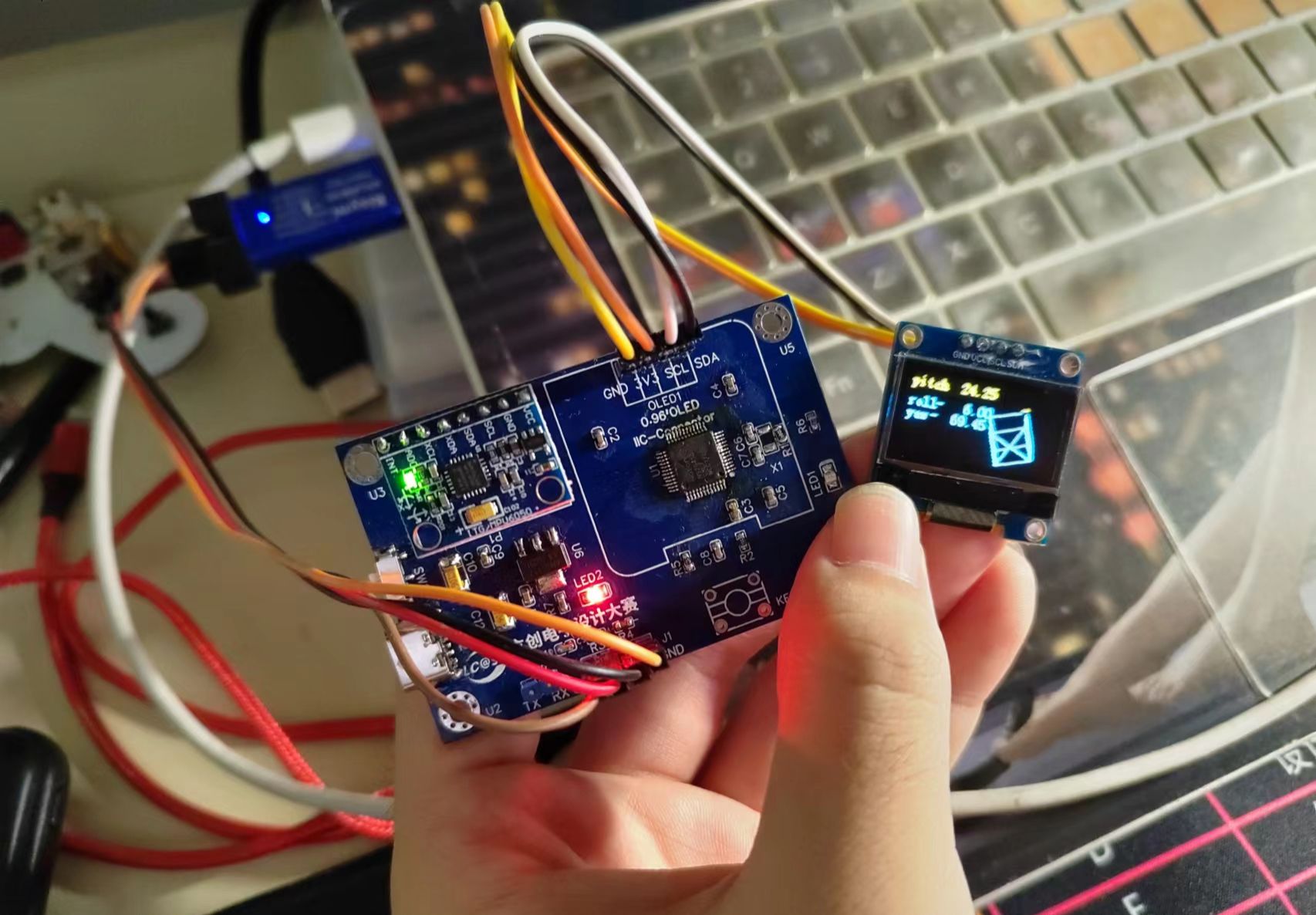

* 1. Project function introduction
Based on N32G430C8L7+INA199, the collected attitude data is converted into the real-time attitude of the module and displayed on the OLED.
It is mainly divided into the following parts: host computer, main controller N32G430C8L7, MPU6050 sensor, OLED display module, etc. It aims to use the MPU6050 sensor to collect the original acceleration and gyroscope acceleration. After receiving the data, N32G430 converts it into the attitude of the module and displays it using OLED and the host computer.
*2. Project attributes

*4. Hardware
The architecture of this design is shown in Figure 1 below. It is mainly divided into the following parts: host computer, main controller N32G430C8L7, MPU6050 sensor, OLED display module, etc. The purpose is to use the MPU6050 sensor to collect the original acceleration and gyroscope acceleration. After receiving the data, N32G430 converts it into the posture of the module and displays it using OLED and host computer.
 The 2022 summer training camp project was perfectly reproduced using Jiali Chuang EDA.
Using N32G430:
The N32G430 series uses a 32-bit ARM Cortex-M4f core with a maximum operating frequency of 128MHz, supports floating-point operations and DSP instructions, integrates up to 64KB embedded encrypted Flash, 16KB SRAM, integrates a wealth of high-performance analog devices, built-in a 12bit 4.7M sps ADC, 3 high-speed comparators, and integrates multiple U(S)ART, i2C, SPI, CAN and other digital communication interfaces. The N32G430C8L7 microcontroller product can work stably in the temperature range of -40°C to +105°C, with a supply voltage of 2.4V to 3.6V, and provides multiple power consumption modes.
Using MPU6050:
MPU6050 is the world's first integrated 6-axis motion processing component launched by InvenSense. Compared with multi-component solutions, it eliminates the problem of inter-axis difference when combining gyroscopes and accelerometers, and reduces installation space. MPU6050 integrates 3-axis gyroscopes and 3-axis acceleration sensors, and contains a second IIC interface that can be used to connect external magnetic sensors, and uses its own digital motion processor hardware acceleration engine to output complete 9-axis fusion calculation data to the application end through the main IIC interface. With DMP, you can use the motion processing library provided by InvenSense, which is very convenient to realize attitude solution, reduce the load of processing operations on the operating system, and greatly reduce the difficulty of development.
OLED module hardware is also used.

*5.
Initialization process of important peripherals MPU6050 and OLED in the software part:
MPU6050 initialization configuration process:
1. Initialize the IIC interface
2. Reset MPU6050
3. Set the full-scale range of the angular velocity sensor (gyroscope) and acceleration sensor
4. Set other parameters
5. Configure the system clock source and enable the angular velocity sensor and acceleration sensor
OLED initialization configuration process:
2. Turn off the OLED display and set the OLED register parameters
3. Turn on the OLED display
(reference document: https://wenku.baidu.com/view/fb23e3a4bfeb19e8b8f67c1cfad6195f302be849.html)
The spatial coordinate conversion algorithm can be found on Baidu.
Software initialization process:
-log_init(): 500000Bd, no parity, 8-bit data, 1 stop bit
-i2c_master_init ()
-oled_init ()
-MPU_Init()
-mpu_dmp_init()
Personal Idea: This project is based on the demo case corresponding to the summer training camp real-time posture display Oled. The software flow chart is shown above. The important thing is the data acquisition of the three angles of MPU6050. Through the library provided by DMP, directly call the library after DMP initialization to obtain the Euler angle data, and then convert it into data that Oled can display through the algorithm.
