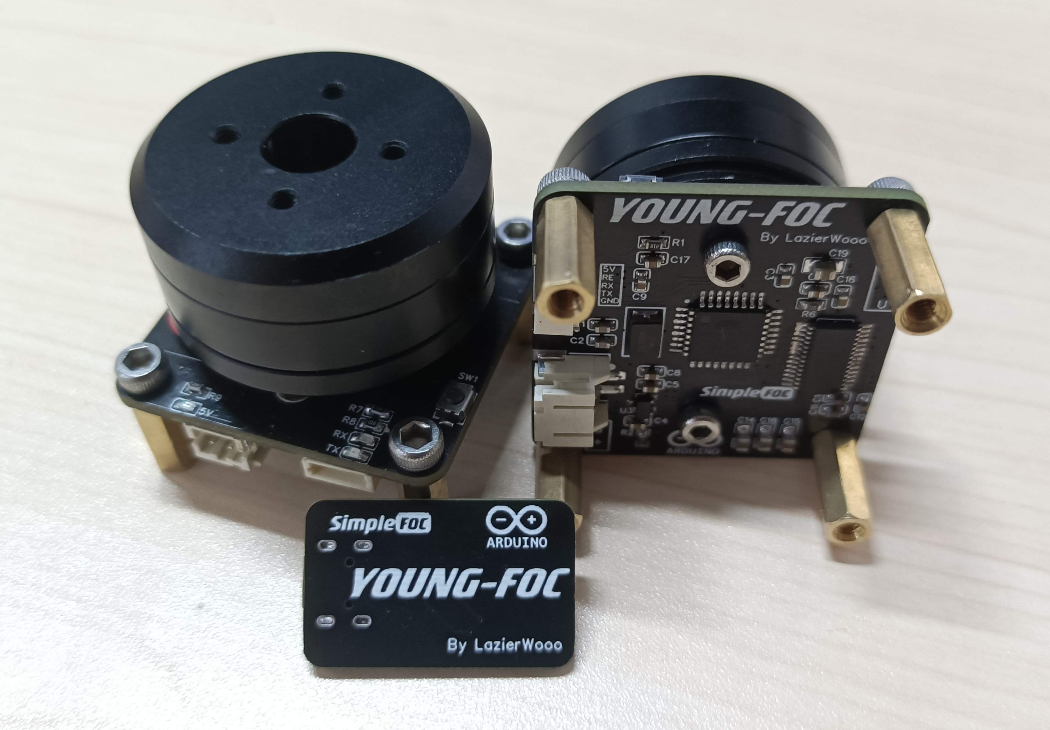

3.4 PCB size
      The PCB is a 36mm×36mm rounded rectangle with a distance of 16mm between the two center holes. It is suitable for a variety of motors with a fixing hole of 16mm. If the size of the fixing hole is not suitable, you can just modify the size and distance of the two fixing holes on the board, re-modify a small part of the routing and lay copper, and you can adapt to more types of pan-tilt motors. Currently, two motors, 2804 and 2210, are used
      Because all the basic hardware supported by Arduino and simpleFOC is used, SimpleFOC studio parameter adjustment is also fully supported. For the configuration, installation and usage suggestions of SimpleFOC studio, please go to CSDN and B station to check it yourself.

5. Physical picture
参考设计图片
