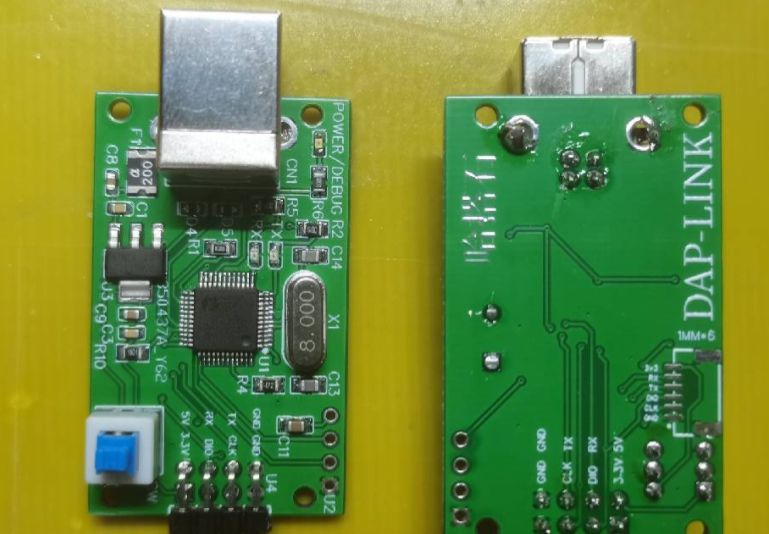

DAP-link based on Air103
Because the USB data cable is not very long, and the data speed is not very fast for USB2.0, I only made equal lengths and did not perform differential wiring. The USB port uses a TYPE-B interface because I think such an interface is more stable and less likely to be damaged. The MCU used by the DAP-LINK downloader is AIR32F103. The performance of this MCU is better than STM32f103. It has a faster download speed. DAP-link is designed using AIR32F103. Hezhou officially provides the latest V2 firmware. This firmware download program is very quick.
