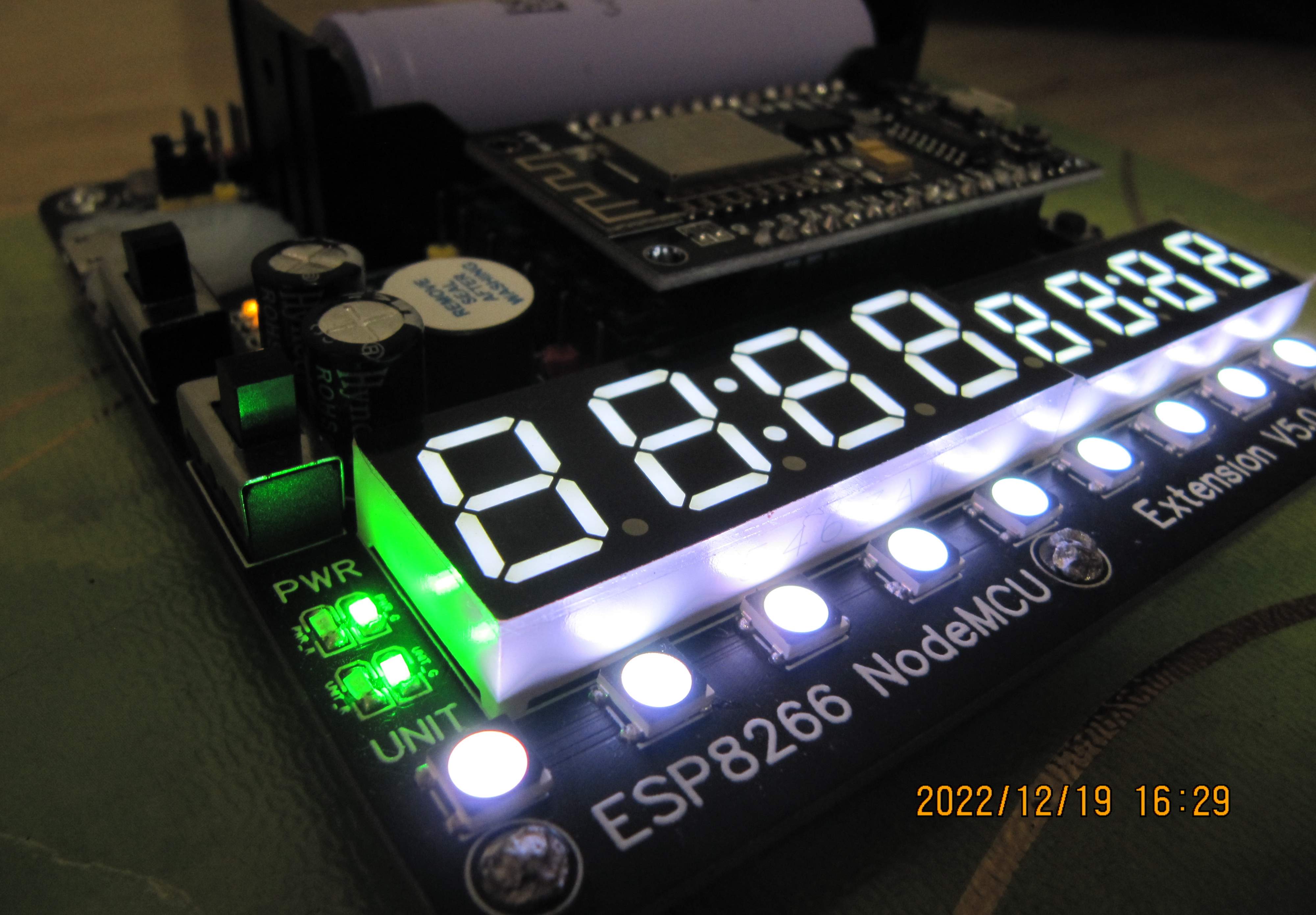

[Verified] ESP8266 NodeMCU Digital Tube Expansion Board
Finished product:
Onboard resources:
        1 MAX7219 8-bit digital tube (0.56-inch common cathode * 1, 0.4-inch common cathode * 1)
              DIN GPIO13
              CLK GPIO14
              CS GPIO15
        1 WS2812 5050 colored lights
              DAT GPIO5
        1 TMB12A05 buzzer
              TRIG GPIO4
        1 photoresistor with built-in voltage divider (A0 can be read directly)
              OUT A0
        1 AMS1117 3.3V voltage regulator
        1 18650 lithium battery holder
        1 ETA9740 charging and discharging chip (in parallel with MicroUSB, no need to solder)
Design analysis:
        1. Adopts ETA9740 charging and discharging chip, which has high power (switch charging instead of linear charging) and has the same input and output port, supporting charging and discharging at the same time.
        2. There are 8 M2 copper pillars around (can be unwelded) to support the entire PCB to prevent the bottom circuit from touching the metal surface and short-circuiting (all copper pillars are grounded).
        3. Two SS12D10G5 high-current switches are used as power switches, and all power lines are thickened to reduce line resistance.
        4. The data pins use jumpers for easy use (jumper caps or DuPont wires can be used for short-circuiting).
        5. MAX7219 is used to drive 8-bit digital tubes, and the program is simple (a lot of libraries in Arduino IDE).
        6. Compatible with wide version NodeMCU with CH340 serial port chip and narrow version NodeMCU with CH9102X or CP2102 serial port chip.

Instructions for use:
        1. Solder components. R1 is the brightness setting resistor of the digital tube, which needs to be selected according to the actual situation. The recommended value for red digital tube is 10K, and the recommended value for white light is 220K (220K is more comfortable to look at and not too dazzling). For other colors, please refer to the two sections on pages 10-11 of the datasheet:
Ⅰ.
Ⅱ.
           Please solder the remaining components according to the component names in the silkscreen and PCB (four 0805 for 25%, 50%, 75%, and 100%). LED and the corresponding current limiting resistors R6 and R7 can be replaced according to actual needs. I use four yellow LEDs with two 10K resistors, and the brightness is slightly dim (pay attention to the direction of the LED).
Battery level indication, four 0805 yellow LEDs (R6 and R7 are LED current limiting resistors)
If the lithium battery charging and discharging function is not required, the 18650 battery box and the components in the blue box here (below the 18650 battery box, bottom of the PCB) can be left unsoldered.
          Please solder the PWR and UNIT indicator lights according to the colors marked on the silk screen (red: "···_R" & green: "···_G"); the 9 ceramic chip capacitors (100nf) at the bottom edge of the bottom of the digital tube are spare for the WS2812 lamp beads and can be left unsoldered (see the Datasheet below).
     2. Make sure all switches are disconnected (the side of the switch handle close to the MicroUSB port is off, and the side close to the digital tube is on), connect the Micro Use a USB charging cable or install an 18650 battery (be sure to check for short circuit before installing the battery). At this time, the PWR indicator light is red, the UNIT indicator light is off, and all onboard devices have no power.
     3. Insert the NodeMCU into the slot (pay attention to the direction and align the pins before inserting. If it is inserted in reverse or not connected correctly, the NodeMCU may be damaged). After confirming that the NodeMCU is connected correctly, turn on the switch printed with PWR. At this time, only the NodeMCU and the 5V output pin header (the 3*10pin pin header in the upper right corner) are powered on, the PWR indicator light turns green, and the UNIT indicator light turns red. If you need to use the onboard digital tube or colored lights, you need to disconnect the main power supply first (turn off the switch printed with PWR) and remove the NodeMCU. Refer to the previous instructions to connect the jumper cap and then install the NodeMCU back. Finally, turn on the UNIT switch printed with UNIT. switch. At this time, all modules on the board are powered on, and the PWR and UNIT indicators are both green. If 3.3V output is enabled, an LED next to the 5V output pin will light up, otherwise it will be off.

------------------------------Updated on 2022/12/22------------------------------
1.The PCB has been soldered and verified and works properly. Use a SamSung 3400mah 18650 battery (actual capacity 3296mah, the test equipment is XTAR's VC4 Plus), after the battery is fully charged, all onboard devices are enabled (NodeMCU firmware is MAX7219_PCB_Clock_Inverted, which can be obtained in the attachment) After 27 hours and 18 minutes, ETA9740 enters low battery protection, cuts off 5v output, and stops supplying power.
Photos taken during the test
2. The actual maximum discharge power of ETA9740 is about 2.52A, slightly exceeding the 2.4A on the Datasheet, and the actual power reaches 12.6W, which can easily drive 4 TT motors.
After discharging at about 2A for 30 minutes, the chip surface temperature is 33.3℃, ​​and the ambient temperature is about 15℃
3. ETA9740 charges the battery (Riset=82kΩ, the inductance between BAT and SW is 2.2uH), and it takes 3 hours and 22 minutes from discharge protection to full charge, and there is basically no temperature rise on the chip surface (the first version uses TP4333 with linear charging, and it takes 5 hours and 27 minutes to fully charge, and the chip surface temperature reaches 56.5℃ at the highest).
