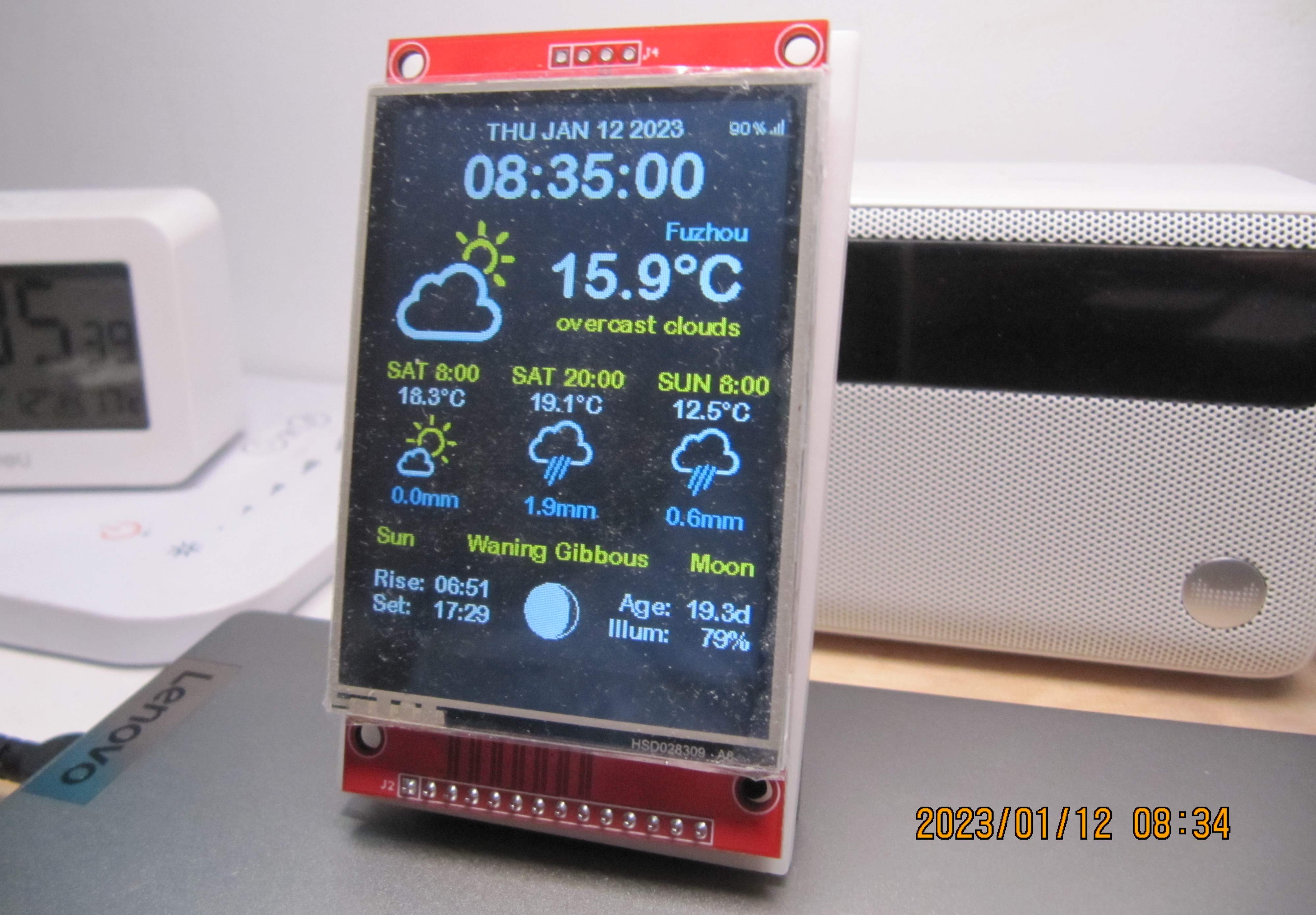

[Verified] ESP8266 Desktop Weather Station
The program and instructions can be found at the original URL: Project, or you can follow the instructions in this article to make it.
The finished product after welding (it is recommended to glue the USB interface and battery welding points to prevent them from falling off):
This is an adapter board for connecting ESP8266 NodeMCU and ILI9341 2.8-inch touch screen. It comes with AMS1117 LDO and optional lithium battery and charge and discharge management, four-grid power indicator, and a physical switch. The 3D model is attached and available in three formats: OBJ, STEP and STL.

Assembly:
1. Slowly place the LCD screen module into the casing:
2. If everything goes well, the screen should be embedded in the groove of the upper shell (when turning it over to check, you must support the screen module from behind, otherwise the screen may sink):
3. After confirming that the screen is flush with the casing, squeeze a little hot melt glue on the four corners of the screen module:
4. Install the NodeMCU on the soldered PCB (pay attention to the direction, the USB port faces down, this is a wide version of the NodeMCU with the serial port chip CH340, so solder the outer pins):
5. Gently place the PCB with the installed NodeMCU into the casing (align the pins):
6. Press slightly on the solder joints of the screen header until the pins are embedded in the header (the upper end of the PCB will sink at this time because there is no support):
7. Turn on the switch to check. If the screen lights up, the circuit connection is normal. Gently lift the NodeMCU upwards, make sure that the PCB is parallel to the desktop, and then use hot melt glue to fix the four corners of the PCB:
8. After the hot melt glue cools down, cover the back cover (the old version of the shell has two slots, one for the switch and the other for the location of the WiFi module. Later, it was found that it was more convenient to open the back cover and then toggle the switch, so the two slots were cancelled (the actual shell has little effect on the WiFi signal of the NodeMCU)):
9. The battery indicator light on the side:
10. The finished product (the old version of the shell has a problem with the size, and there is a gap between the upper and lower shells. The compressed package in the attachment is the new version of the shell, and the problem has been fixed):
