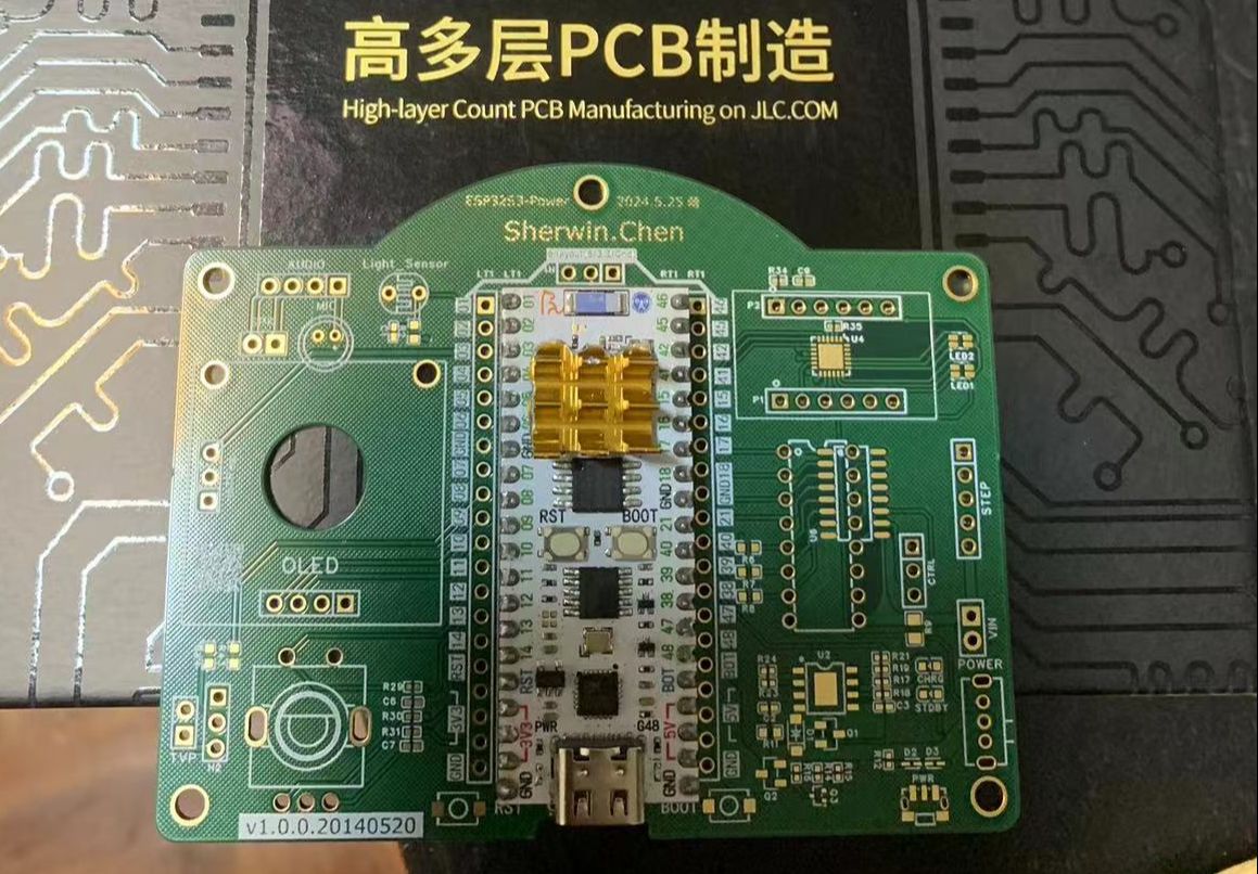

LCSC ESP32S3R8N8 Expansion Board V1.0
This is a reference to an open-source solution: https://oshwhub.com/nan_sheng/esp32s3-tuo-zhan-ban-v1-0.
It describes
an expansion board specifically designed for the LCSC ESP32S3 development board, including USB and lithium battery switching, battery charging, a 0.96-inch OLED, stepper motor driver, LED tri-color lights, digital tube, temperature and humidity sensor, photosensitive sensor, rotary encoder, EEPROM, infrared, and other functional expansions. The video demonstrates software power-on/off, OLED display, and photoresistor ADC voltage reading.
New features:
1. All pins are brought out for easy self-outlining.
2. A 6-layer board is used, with the following layer layout:
signal layer
GND,
5V
GND,
3.3V
GND.
3. Text uses reverse annotation.
4. Originally for personal use and not intended for public release (a copy of someone else's), it is shared here because some group members requested it. Criticism and corrections are welcome.
5. Copyright belongs to the original author. Please go directly to: https://oshwhub.com/nan_sheng/esp32s3-tuo-zhan-ban-v1-0
6. The image below shows a 6-layer precast component, not yet welded; more will be added later.
PDF_LCSC ESP32S3R8N8 Expansion Board V1.0.zip
Altium_LCSC ESP32S3R8N8 Expansion Board V1.0.zip
PADS_LCSC ESP32S3R8N8 Expansion Board V1.0.zip
BOM_LCSC ESP32S3R8N8 Expansion Board V1.0.xlsx
