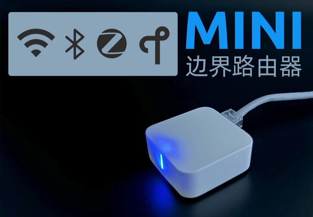

Project Overview:
This project involves creating a MINI border router solution based on Espressif's ESP32-S3 and ESP32-H2 (Wi-Fi and 802.15.4), utilizing services such as LCSC PCB, 3D printing, and the LCSC online store.
The bilibili video link
project features compatibility
with ESP Thread Border Router,
bidirectional IPv6 connection
service discovery,
multicast forwarding,
NAT64
RCP update,
RF coexistence,
and a web-based graphical user interface.
Project parameters include
: Component
Specification:
Main chip
ESP32-S3-MINI-1U-N4R2,
Auxiliary chip
ESP32-H2-MINI-1U-N4;
Status indicator
WS2812
; Buttons
G0/G9 (Boot button, RST reset button)
; Slide switch;
USB toggle switch (selects between main and auxiliary chip); Input interfaces: USB-C wired network, RJ45
input ; Power supply: USB DC 5V input, PoE IEEE 802.3af (36V to 57V DC) ; Expansion I/O ; Rear pads for power and I/O; Device dimensions: 45 x 45 x 20mm; Device weight: 32g; Design principle: PCB'A (front and back); Finished board thickness: 1.6mm; Number of layers: 2; Board dimensions: 40 * 40 mm ; 3D schematic; Component Specification: Heatsink 14 x 14 x 6mm blue strip with thermal adhesive silicone pad, gray silicone pad, single-sided adhesive, 28 x 1mm diameter antenna , M-type ultra-small FPC (3DB 18 x 7mm), total cable length: 6cm, connector type: IPEX 3rd generation. Software description: Espressif ESP Thread Border Router SDK, Visual Studio Code + ESP IDF development environment. Physical demonstration . Notes : Difficulty of replication: ⭐⭐⭐ This project has many 0402 components, and the density is average. Please evaluate carefully before replication. The RJ45 network port has a corner that interferes with the bevel of the shell, requiring manual cutting of the network port plastic. Cost reference: Standard version, Simplified version, PCB'A ¥93 ¥55 (no PoE module) , Antenna ¥1.36 ¥1.36 , Heatsink ¥1.3 ¥1.3, Shell ¥28.7 ¥8.7 (unpainted) , Feet ¥0.11, None. Total ¥124.47 ¥66.36
