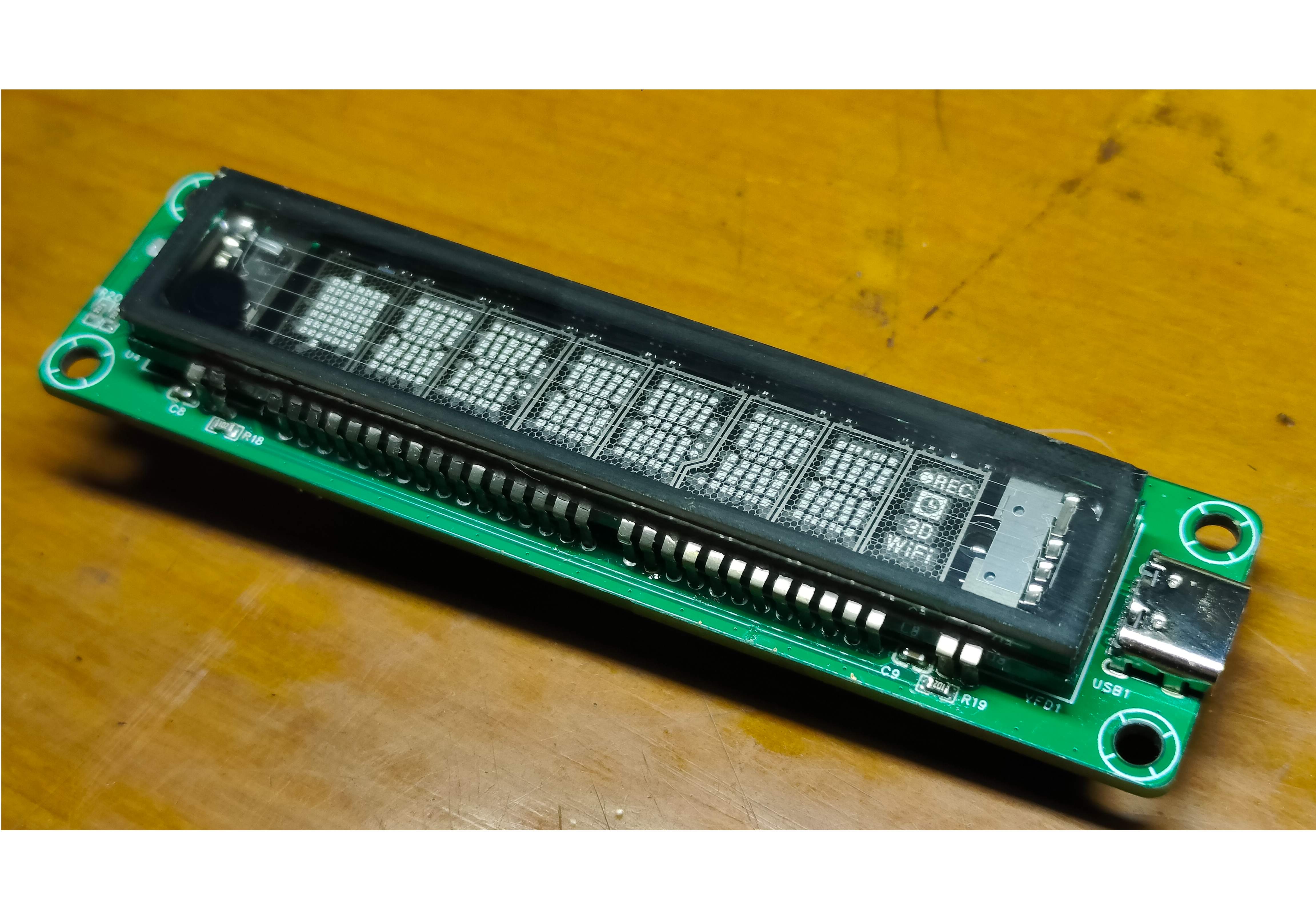

VFD display module based on ESP32C3+PT6315
Project Description
This project implements a VFD display module. The module supports basic WiFi clock functions and also exposes remaining I/O and a matrix keyboard interface, allowing interested users to use it as a display screen + ESP32 development board for secondary development.
The VFD used in this project is a cheap FUTABA_7-BT-317NK that was sold off on Taobao a few months ago; there are still some available on the market.

Design Principles
I. Main Board Part
1. Using the ESP32-C3-MINI1 module, its price and pin count are suitable for this project, its performance is stronger than the ESP8266, and I am more familiar with it.
2. Two S8050s form an automatic download circuit, which is common in many development boards. This circuit is reserved for easy burning and debugging.
This is the VFD driver chip PT6315.
Similar to a digital tube chip, it writes data to its display memory via a three-wire interface (DIN, CLK, STB), and then continuously scans the display level at each segment and digit selection pin.
This type of chip usually also has keyboard scanning functionality, and the PT6315 is no exception; it can scan a 16*2 matrix keyboard.
(The keyboard port and LED output port of the PT6315 are shown, making it convenient to use the motherboard as a module elsewhere.)
The PT6315 drives the VFD in a negative voltage manner, therefore it requires a -20V to -28V DC negative voltage.
A negative boost converter for CUK is implemented using MT3608+LMV321; this part is copied from @XACT.
Output voltage calculation: Vout = -0.6 * (1+R6/R7), using the resistors shown in the diagram to output -23V.
The voltage can be set manually using R6 and R7; a higher voltage results in brighter display, but may increase power consumption and reduce the lifespan of the VFD tube.
The VFD_EN_HV label in the circuit diagram is the enable signal input for the negative boost circuit.
The PT6315 datasheet mentions that the negative high voltage requires a power-on delay and an earlier power-off (see diagram below). Although actual testing showed no impact, the datasheet recommendation was followed.
The VFD filament requires AC heating.
If DC power is used, due to the filament's resistance and decreasing potential from the positive to the negative terminal,
the end closer to the positive terminal will attract electrons more easily and become brighter, resulting in uneven brightness across the VFD.
The MX113 motor driver chip is chosen in this circuit because it is inexpensive and small.
Through the microcontroller's PWM and an inverter constructed from AO3400, two complementary PWM signals are obtained.
Therefore, the full-bridge output swing is VCC*2≈10V. By adjusting the PWM duty cycle, Vrms is kept between 2.0 and 2.8V.
Generally, the duty cycle is adjusted to achieve a considerable brightness while maintaining a relatively small duty cycle.
If the duty cycle is too high, the filament will turn red; avoid seeing a noticeably red filament, as this will significantly shorten its lifespan! For

Finally, the JLC04161H-7628
4-layer board was selected, with a PCB thickness of 1.6 and a trace width of 32.2 mil.
Component placement and routing planning
followed. Espressif's hardware design guide also provided an example
using a 4-layer board. Components were placed on the top layer, and most traces that could be routed on the top layer were routed there.
The inner layer 1 was fully copper-clad to ensure a complete ground plane.
Some signal lines were routed on the inner layer 2,
and power lines were routed on the bottom layer. Because the copper foil thickness of the bottom layer is 1 oz while that of the inner layer 2 is only 0.5 oz, the trace width on the inner layer 2 would need to be doubled compared to the bottom layer.
3D
antenna parameter debugging was performed
, but the π-shaped circuit parameters at the antenna needed to be adjusted according to the actual design, so a network vector analyzer was used for testing and adjustment.
First, remove the chip. Solder the test leads to the antenna pins. Connect the initial parameters of the π-shaped filter circuit in series with an 0R resistor.
Connect the other end to the vector network analyzer. Set the scan start frequency to 2.4GHz and the end frequency to 2.5GHz. Adjust the cursor to 2.412GHz, because the car's AP mode uses WiFi channel 1, which corresponds to the 2.412GHz frequency.
After adjustment, as shown in the figure below, the antenna performance at the specified frequency is displayed: VSWR is 1.838, and Smith chart value is 79.26+. At j25.63Ω, the antenna
performs best with a VSWR of 1.0.
After confirming the input, the corresponding point is displayed, which roughly corresponds to the measurement on the instrument. The instrument displays a simplified version of the Smith circle, with the center of the large circle corresponding to a 50Ω impedance. The vector analyzer omits the small circle on the left.
Add series or parallel capacitors or inductors via the toolbar in the upper right corner to bring the measurement point as close to the center as possible. Each connection method will have different characteristics.
Finally, it is calculated that a 1.5pF capacitor needs to be connected in series, and a 10.6nH inductor needs to be connected in parallel at the antenna end to achieve optimal antenna performance.
The software calculations are not entirely accurate and require slight adjustments after actual connection. First, replacing the 0Ω resistor with a 1.5pF Smith chip brought the value almost to the center, eliminating the need for a series inductor. Finally, testing showed that a 2.7pF series connection yielded the best results.
Antenna tuning was then complete; the antenna was removed, and the chip was installed.
The crystal oscillator section is also a high-speed circuit, requiring a GND shielding layer, and rounded corners were used for the traces.
The battery is designed to be non-removable, so a charging circuit was added using a TP4056 charging chip. Referring to the datasheet, the circuit was drawn accordingly. The charging current was set to 400mA, adjusted based on the resistance of resistor R21.
A switch at the battery interface controls charging, and a current detection circuit detects battery discharge and charging voltage. When no charger is connected, the switch controls power; when the charger is connected, the switch controls charging.
Current is detected via resistor R14. According to Ohm's Law, I=U/R... In other words, when current flows through a resistor, a voltage difference is generated across the resistor. This voltage difference divided by the resistance value of R14 equals the current flowing through the resistor. Since the voltage difference across the resistor is relatively small, an operational amplifier is used to amplify the voltage before supplying it to the microcontroller.
The power supply is first boosted to 5V and then regulated to 3.3V to power the microcontroller and sensor.
The download section uses the CH342F chip, which has two ports and can simultaneously download data to two microcontrollers via a single USB port. Considering the limited space, a DMMT3904 is used instead of two NPN transistors
. The sensor uses an MPU6050,
the motor driver uses a DRV8833 with two N20 motors
, and the lidar uses an LD14. The main advantage is its low price; used LD14 lidars can be bought for 25-60 RMB on Taobao or Xianyu (new ones cost around 250 RMB), but the quantity is relatively small.
LiDARs compatible with the YDLIDAR X2 protocol are more common, costing 30-55 RMB. This includes not only YDLIDAR lidars but also lidars from other smaller manufacturers. Before buying, ask the seller if it is compatible with the EAI protocol. The two on the left in the image below are EAI. On the right is the LD14 hole position almost identical
voltage measurement circuit, measuring battery voltage. A resistor divider is used to supply voltage to the ADC port
buzzer, intended for low battery alarm or other power-on prompts. The
camera board 's wiring requires some attention. A GND wire needs to be sandwiched between the high-speed antenna lines, and the high-speed lines should be kept as far apart as possible. Minimize corners in the wiring, otherwise the camera image will be interfered with. ( Top                          layer, inner layer 1, inner layer 2,    bottom layer 3D diagram). This camera board could actually be done with two layers, but the high-speed lines require complete ground shielding, and the antenna impedance needs to be matched. If a two-layer board were used, the antenna wiring width would need to be 100mil, which is unreasonable. Therefore, a four-layer board was ultimately used. The main control chip is ESP32S3, the antenna is a surface-mount ceramic antenna, and the camera uses an OV2640. The download circuit uses a CH343P power supply solution referenced from the chassis PCB. First, the voltage is boosted to 5V, then bucked to 3.3V for use, and then regulated to 1.2V and 2.8V respectively. 3.3V power supply for the camera and chip. Software description: Compilation environment: ESP32 uses espressif-IED version 2.6.0 to edit and compile code. Virtual machine: VM software is used to create the virtual machine system. System: Ubuntu 20.04. ROS system: ROS1 Noetic version . Installation method can be found on the noetic/Installation/Ubuntu - ROS Wiki website , but the official installation is cumbersome. You can use the Yuxiang ROS one-click installation tool, which is very easy to use (praise to the master) . Enter the command wget http://fishros.com/install -O fishros && . fishros. After entering the command, just click the numbers step by step to install ROS functions . ROS system uses the noetic version, which is still ROS1. This structure is not my first use. Yuxiang ROS and other masters have been using it for a long time. A more mature solution is to run ROS2 libraries on ESP32, so you can directly publish topics on ESP32. However, I only know a little about ROS1, and it is quite difficult to learn ROS2. Therefore, I used TCP to serial port conversion to be compatible with the original package. This way, the function can be completed with a simple operation. The localization algorithm uses robot_pose_ekf, relying solely on odometry and LiDAR for positioning. The mapping algorithm employs the Karto mapping algorithm, with default parameters. Navigation uses the Navigation architecture, which can be simply understood as follows: the AMCL adaptive Monte Carlo positioning package provides localization, the map server publishes the map data, and then, based on the target location published by RViz, it performs path planning, outputs the path and chassis movement data, and controls the vehicle to reach the target point. The chassis and computer are connected via Wi-Fi, and the specific communication link is shown in the diagram below. The communication latency is quite considerable. From top to bottom, it consists of the chassis, radar, and camera. The test uses the computer's built-in network card, with the vehicle approximately 20 meters away from the computer, separated by a chair and a table, completely obstructing the view. The test latency results are as follows: The ROS workspace file details its function and structure . The radar communication link uses TCP to forward data to the ROS host computer, then socat creates a virtual serial port for TCP-to-serial conversion, and finally the serial port input is sent to the radar's function package. The appropriate function package can be selected based on the radar you are using; you can choose LD14 or X2. The motion control board communicates with the ROS host computer via TCP, and then uses socat to create a virtual serial port for TCP-to-serial conversion. Finally, the serial output is processed by the chassis nodes, outputting TF and odometer readings. The value of cmd_vel is received and sent back to the chassis for motion control. The navigation map has three layers: the first layer is the original map (black areas are masked by color; an imported map is used); the second layer is the global cost map, aligned with the original map; and the third layer is the local cost map, 1.5m in length and width . The colors around the vehicle body have the following meanings: pink corresponds to the original map, representing an obstacle area; light blue extends from the vehicle's radius (e.g., if the radius is 0.05 meters, the width of this light blue area is 0.05 meters). The planned path of the car must not overlap with this area; overlap means a collision will occur during driving.
