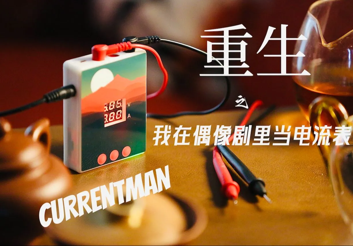

Photos of the finished voltmeter and ammeter based on the CW32F030 are shown below
: ![IMG_7361 2.JPG]
![IMG_7359.jpg]
I won't go into details since they were all taught by the same mentor. This was my first time experiencing JLCPCB's 3D printing and panel services. Initially, I wanted an acrylic panel, but the customer service representative called to tell me that acrylic couldn't be made with bulging, so I changed it to a thin-film panel. The buttons have a nice bulge. I
initially wanted a semi-transparent shell, but my printer couldn't handle transparent effects. So I used JLCPCB's 3D printing service to make a semi-transparent resin shell. The result is shown in the image:
![IMG_7309.jpg]
The panel hadn't arrived yet, so I assembled it and checked the effect. I found some design flaws: the LCD screen edges weren't reinforced, and the four corner screws were too short to hold the motherboard in place, causing the motherboard to be uneven during assembly. So I modified the model and finally printed a white one using my own printer.
The shell model file is attached.
