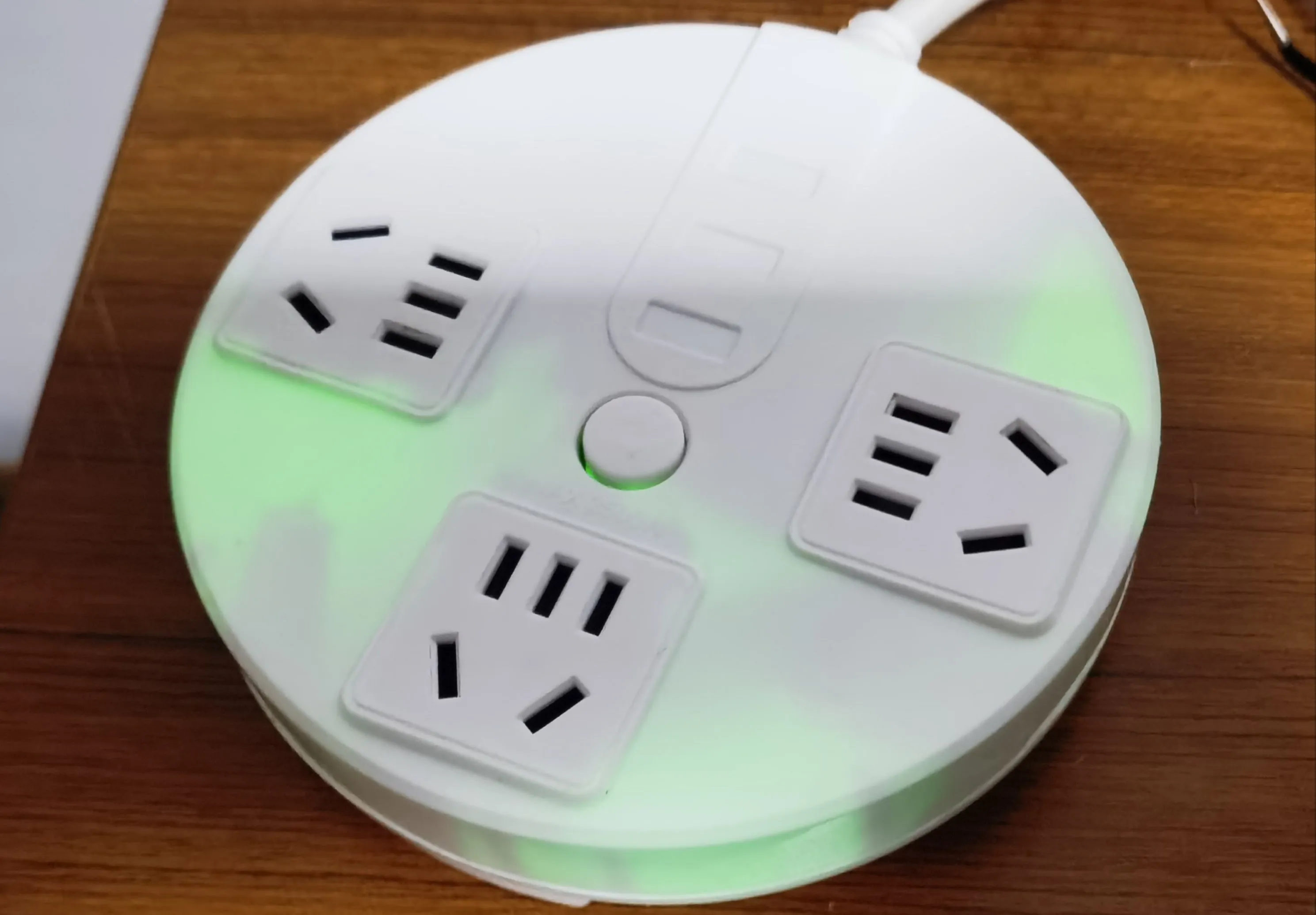

WiFi smart power strip retrofit based on ESP8266 and Buffalo Cloud
This project involves
modifying a purchased standard power strip to allow individual control of each socket via Buffalo Cloud.
0805 surface-mount capacitors and 1206 surface-mount resistors are used for easy soldering.
This power strip uses 220V AC power. DIY projects and actual use may involve risks of electric shock, burns, and other potential injuries, disabilities, or death. Please strictly follow safety regulations and take adequate precautions. Minors should operate under the supervision of a guardian. By using this solution, you acknowledge the safety risks; please ensure you have sufficient knowledge before proceeding. You are solely responsible for any losses or consequences incurred, and I assume no legal liability.
I am not a professional in electronics hardware or software; I am merely an amateur enthusiast. Therefore, I may lack basic hardware and software knowledge. Any errors in the circuit diagrams or code are sincerely appreciated and I would be grateful for any corrections.

: Power strip: Round power strip, Quantity 1;
WiFi module: ESP8266 (this project uses E103-W01 module, compatible with ESP12F, etc.), Quantity 1;
Magnetic latching relay: Hongfa magnetic latching relay HF3F-L-05-1HL1T, Quantity 3;
Relay control chip: TC118S, Quantity 3;
ACDC power module: Hailingke HLK-5M05, Quantity 1;
Inductor: Common mode inductor UU9.8 20MH, Quantity 1;
Capacitor: Safety capacitor X2 275V 0.1uF lead spacing 10mm, Quantity 1;
Aluminum electrolytic capacitor 10V 220uf 5x11, Quantity 1;
0805 SMD capacitor 22uF, Quantity 2;
0805 SMD capacitor 100nF, Quantity 7;
Fuse: 5x20 fuse tube 250V 1A, Quantity 1;
5x20 fuse holder, quantity 1;
1206 resettable fuse 6V 1.1A, quantity 1;
Resistor: 10D561K varistor 560V, quantity 1;
1206 SMD resistor 1kΩ, quantity 3;
1206 SMD resistor 10kΩ, quantity 5;
Linear regulator: AMS1117-3.3 SOT-89, quantity 1;
Diode: Schottky diode SS14, quantity 1;
0805 LED, quantity 3;

Actual
PCB:
Soldering front:
Soldering back:
Complete assembly:
Lighting up:
