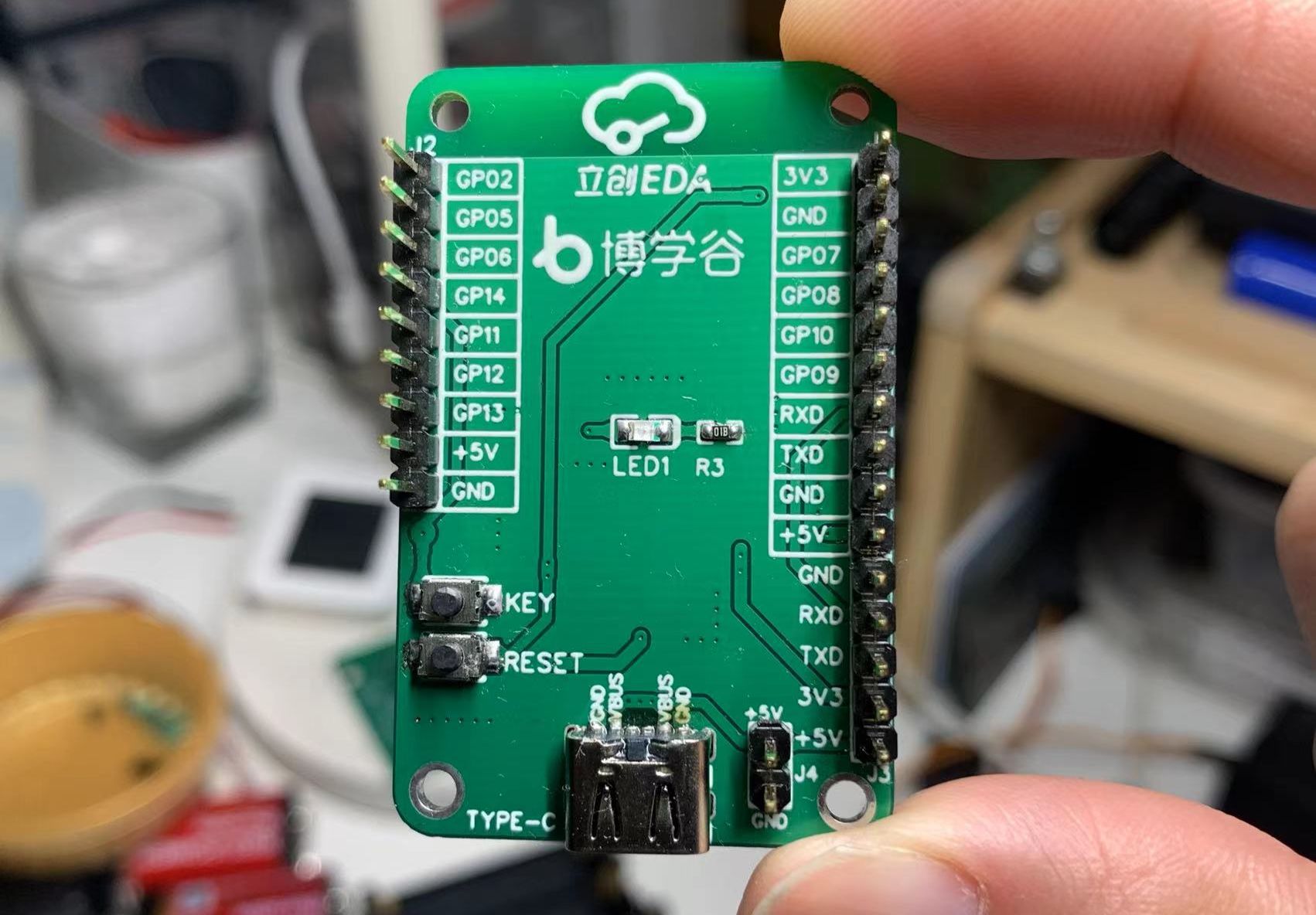

Hongmeng Internet of Things Practical Training Camp, using ITCAST-HI3861 module to implement smart WIFI switch
A development board designed using Hongmeng HI3861 SOC as the core, with a servo and battery power supply, is installed at a suitable position next to the switch. By directly connecting the mobile phone to the AP or connecting to WIFI, the status of the wall switch can be remotely controlled in real time.
HI3861 smart WIFI switch [physical demonstration]
https://www.bilibili.com/video/BV1rL4y1L7Ld
Python version of genkipi plug-in: genkipi-python-xxx.zip
Burn firmware: Hi3861_wifiiot_app_allinone_xxx.bin
Firmware burning tool: HiBurn.exe
Hi3861_wifiiot_app_allinone_v1.1.0.bin is the first version. Every time the chip is reset, the servo will perform initial movement, and the default small light will turn on and off with the movement. WIFI: genkipi-switch Password: 12345678
Hi3861_wifiiot_app_allinone_v1.1.1.bin is the third version. Every time after resetting the chip, the servo will not move and the small light will not light up by default. WIFI: itcast password: 12345678
The above firmware supports network and serial port burning of Python programs.
The v1.1.0 version is used with the Hi3861_wifiiot_app_allinone_v1.1.0.bin firmware: the network burning IP is 192.168.10.1 port 7071
The v1.1.1 version is used with Hi3861_wifiiot_app_allinone_v1.1.1.bin firmware: the network burning IP is 192.168.10.1 port 80
v1.1.1 serial port burning is more stable
