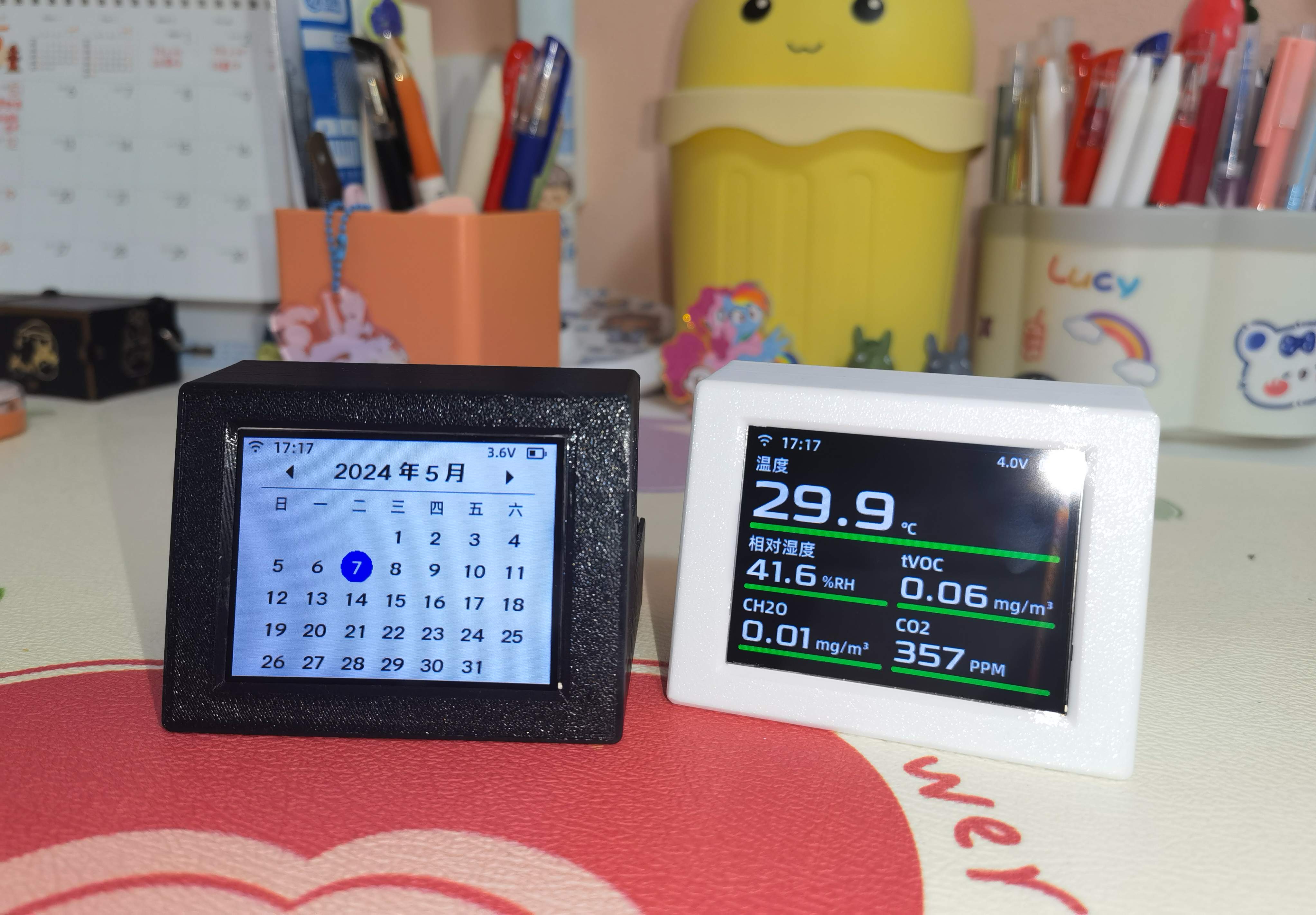

section is written using the Arduino IDE, and all pages use the native tft_Espi library.
Version 1.0 has five pages: temperature and humidity detection, clock & detection, city weather, calendar, and settings.
There are three buttons on the back: the side buttons are used to switch pages, and the middle button is used for confirmation with a short press and for sleep mode with a long press.
The main
controller selected is the ESP-wroom-32 module. Since it needs to be powered by a lithium battery pack, the power supply circuit does not use LDO, but uses a DCDC solution.
Several power-consuming components use transistors as switches. After sleep mode, the current is high.
