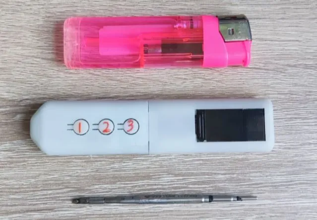

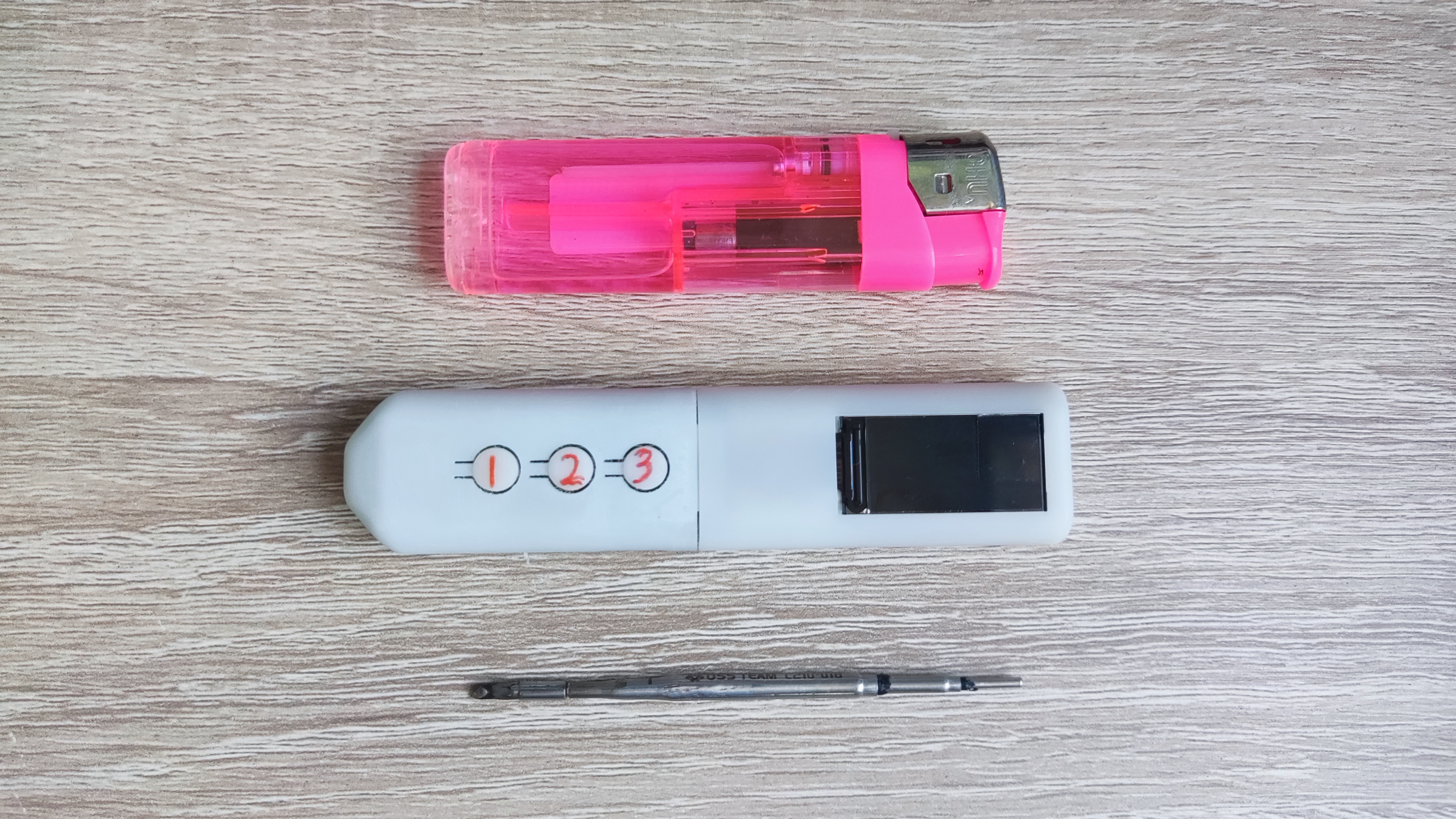

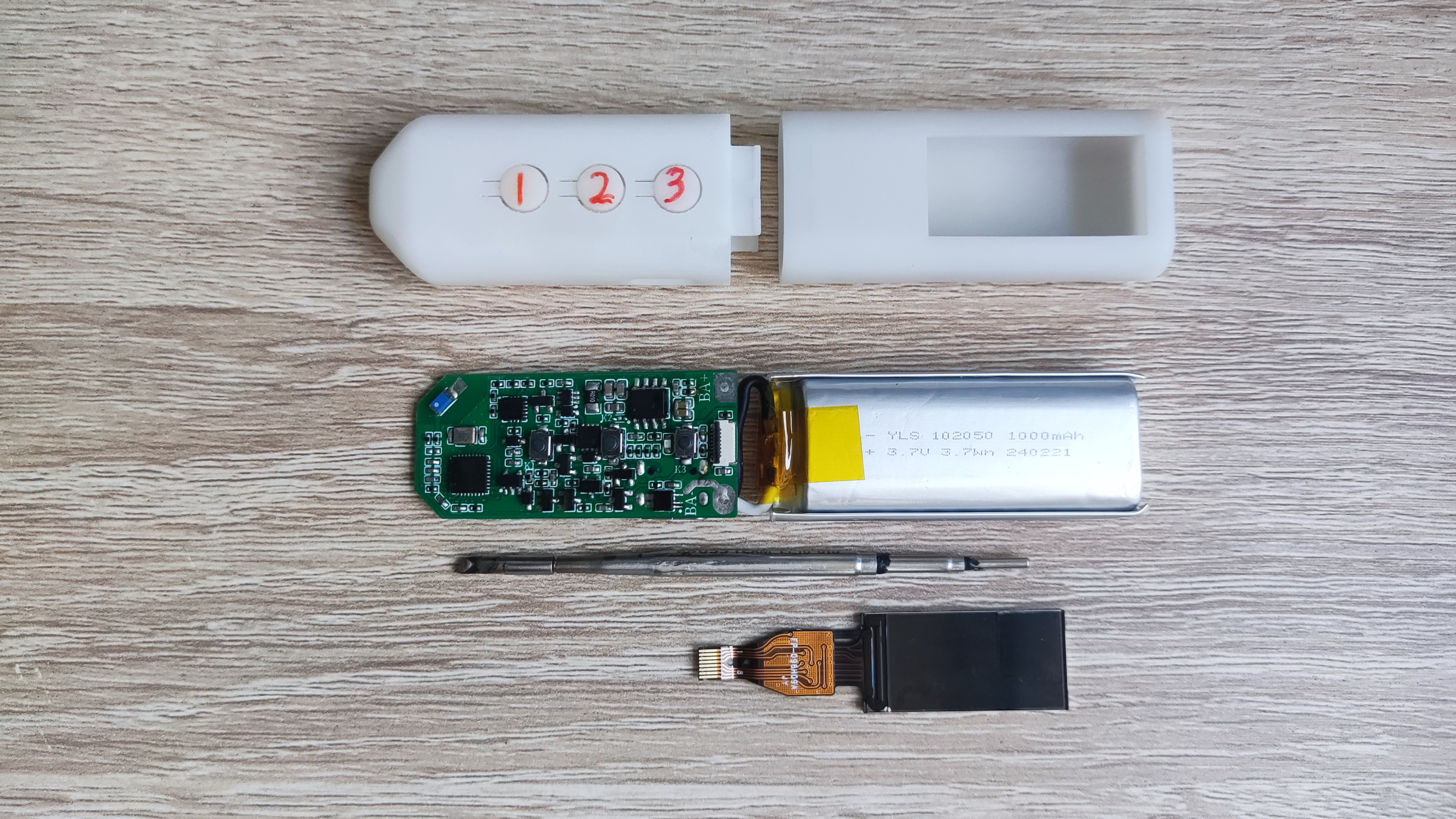

1. The EESP32-C210 wireless soldering iron consists of: PCBA + lithium battery + 0.96 TFT + two shells + C210 soldering iron core.
2. The PCB is prototyped using JLCPCB. Process parameters selected: FR-4 material, 2-layer board, board thickness 0.8mm, color optional.
3. The lithium battery uses 102050 cells with a capacity of 1000mAh, length 50*width 20*height 10mm. It is best to use a high-performance battery cell to provide sufficient heating power; ordinary battery cells are barely usable.
4. The shell is designed using SOLIDWORKS 2021 and 3D printed by JLCPCB. It consists of shell A and shell B. Since the connection between the two shells is not very tight, it is best to reinforce the connection with glue or tape.
5. The TFT uses ST7735S 0.96-inch TFT. 160*80 pixels, plug-in 8-pin FPC interface. Note: ST7735S driver required
. 6. The C210 soldering iron uses the Sugon C210-018 tip soldering iron core. Measured heating resistance: approximately 2R. Thermocouple signal: approximately 0~5mV at 0~500℃. Precautions
