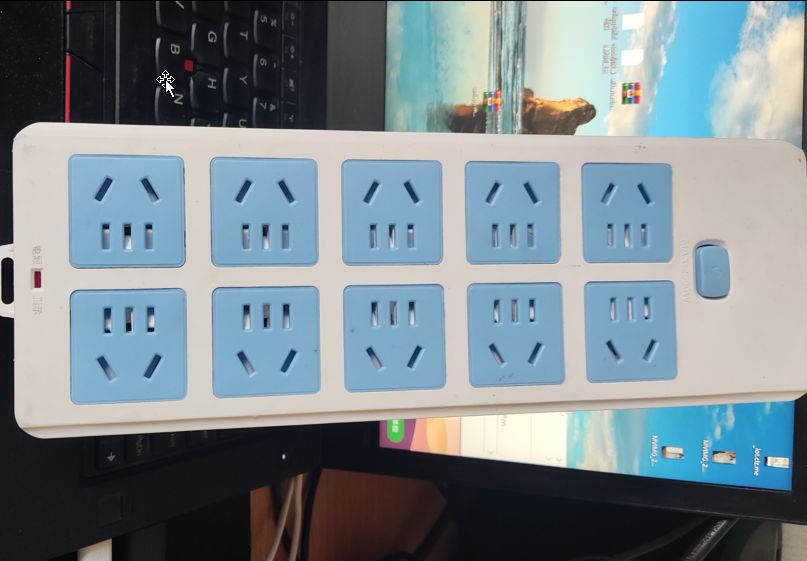

1. Uses the LCSC ESP32 development board to control whether the sockets on a power strip are powered.
2. When the router is on, it connects to a cloud server via the ESP32's Wi-Fi to receive control commands;
     when the router is off or the cloud server is unavailable, it connects directly to the phone via the ESP32's Bluetooth to receive control commands.
3. When the phone is not readily available, a universal remote control can be used.
4. For easy mobile app use, a simple lighting app can be used; for medium difficulty, uniapp can be used, or an Alibaba Cloud SDK template can be used directly.

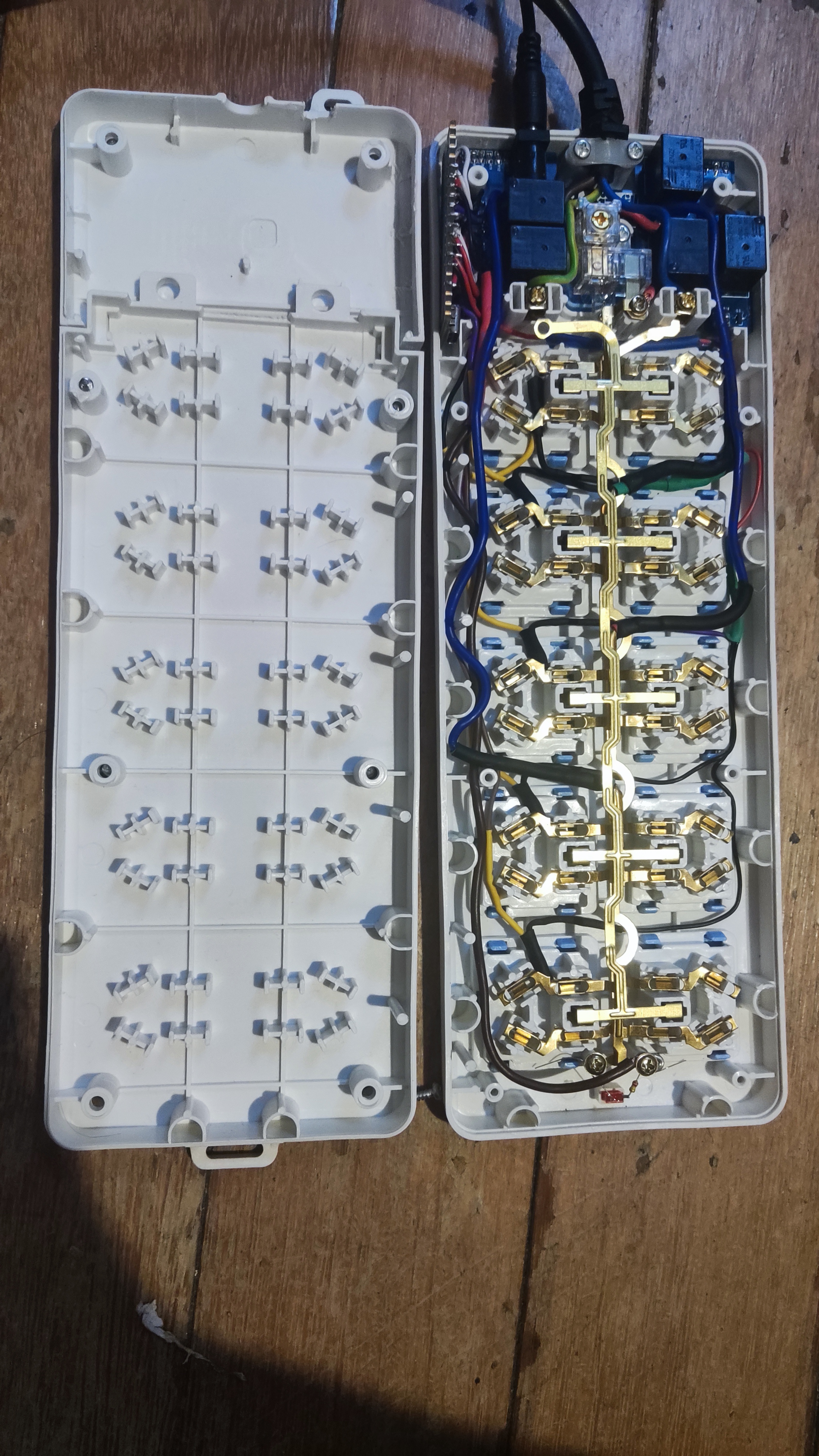

5. A commercially available power strip can be modified to ensure safety.

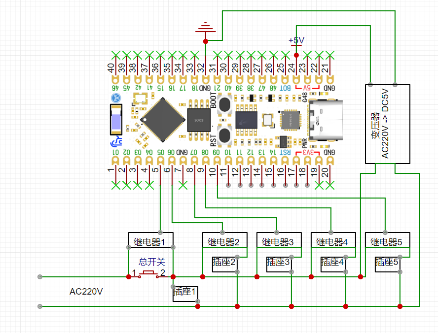

6. The 5V power supply for the ESP32 development board is provided by a transformer module. The 220V connection point of the transformer module is after the main switch of the power strip. Relay 1 is connected in parallel with the main switch. After the ESP32 development board is powered on, relay 1 immediately closes, and the normally open non-locking main switch opens. If a risk is detected or the APP commands relay 1 to open, the entire system will be de-energized, ensuring safety.
7. NTC is installed next to all live wire sockets to ensure safety.
