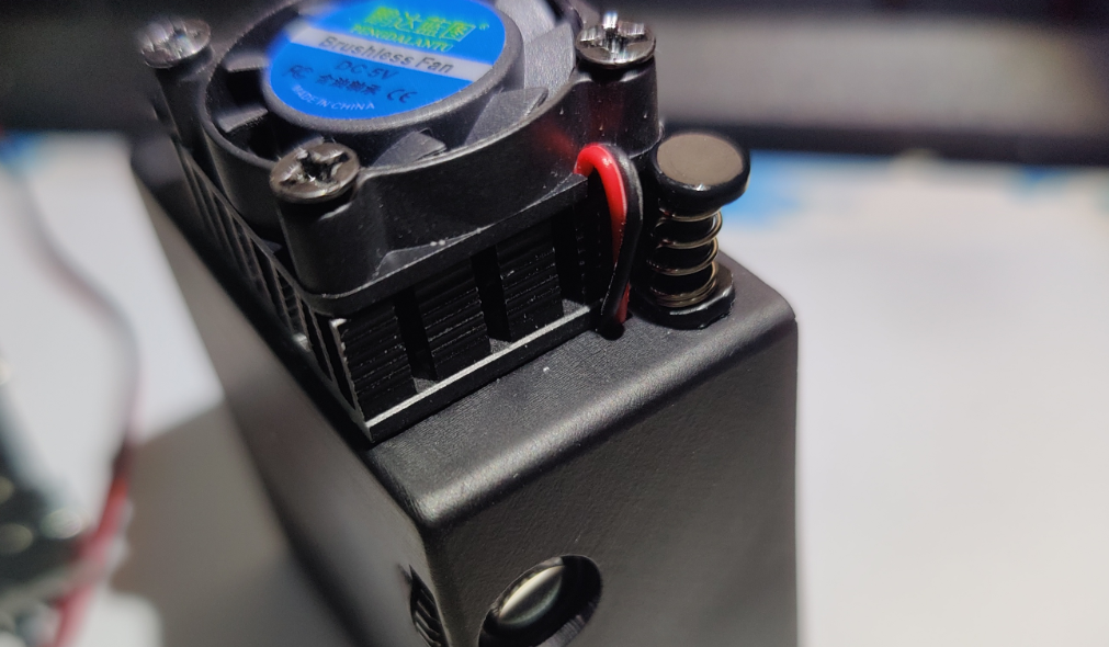

WARNING ⚠: A heatsink must be connected before the optical engine module is lit; otherwise, powering on for more than 3 seconds may burn out the LED chips.

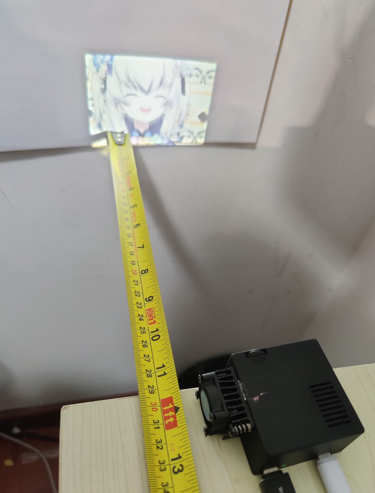

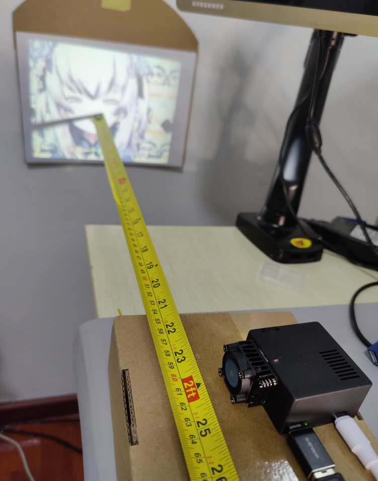

Projection distance:
To project the entire area of ​​an A4 sheet of paper, the distance is approximately 60cm.
The minimum projection distance is approximately 29cm (with the focus ring turned to the far left).
The maximum projection distance should be between 1m and 1.5m (with the focus ring turned to the far right). At this distance, the projected area will be slightly larger than the A3 size (29.7cm × 42.0cm), but the brightness will be lower.

If the contact surface of the fan's heat sink aluminum block is uneven, you can use a hammer to flatten it.

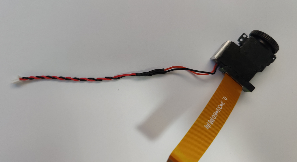

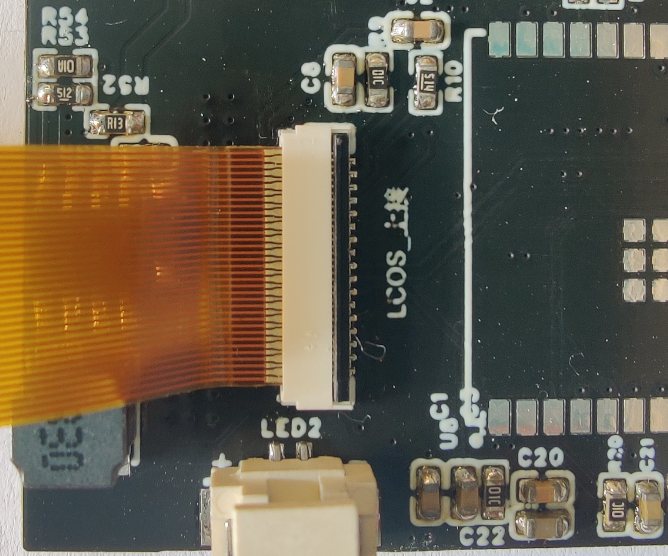

Installation:

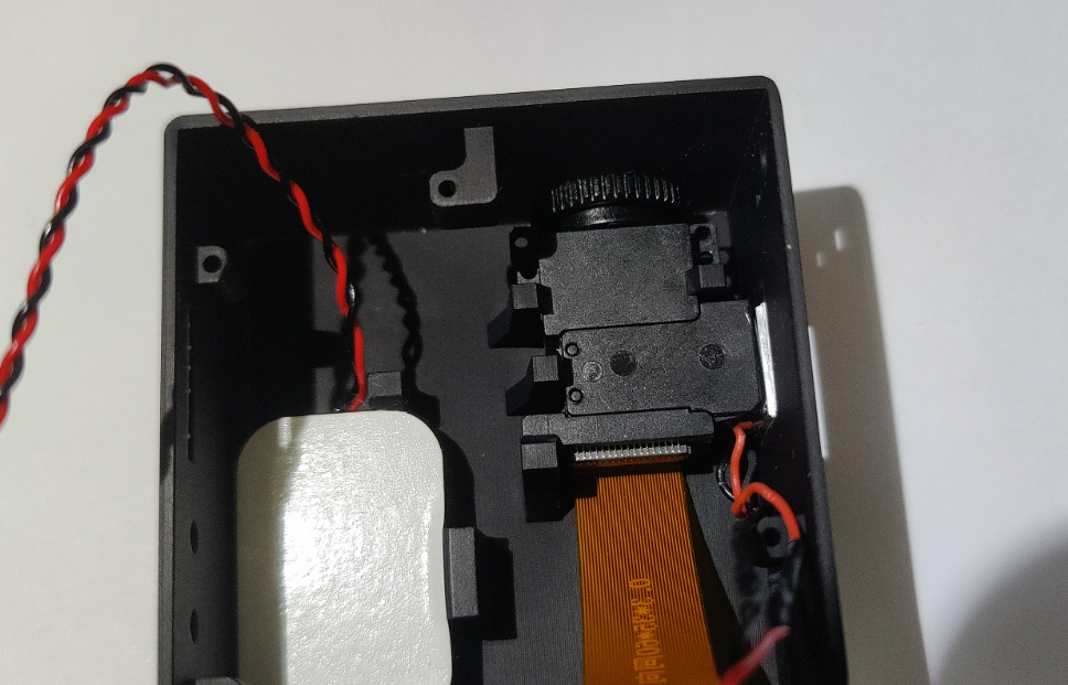

Note: Once the optical engine is installed in the housing, it is difficult to remove unless the housing is damaged.

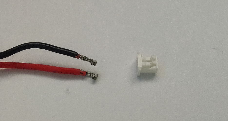

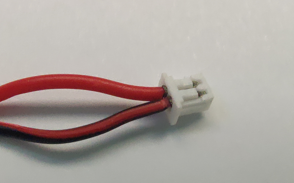

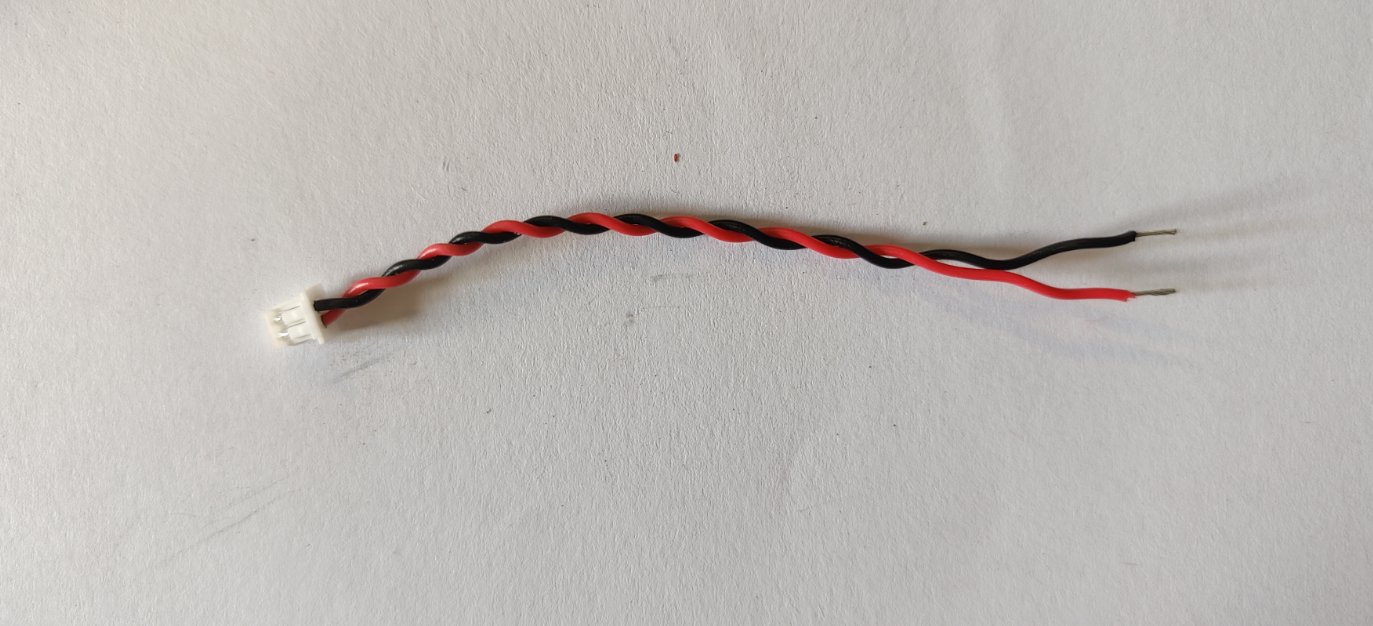

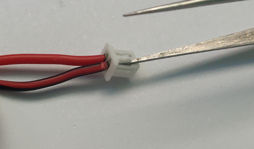

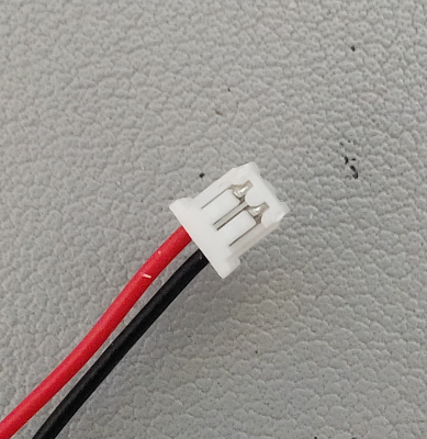

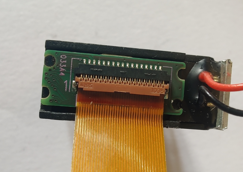

Prepare an MX 1.25mm pitch 2P male connector and connect the optical engine's LED light source cable to the
optical engine ribbon cable. Installation: (The optical engine ribbon cable must be installed first). After installation, manually fold the ribbon cable upwards
and then peel off the protective film on the optical engine lens
. (Carefully check the housing for any unpolished support points. If there are any, polish them smooth, otherwise they will block the optical engine.)

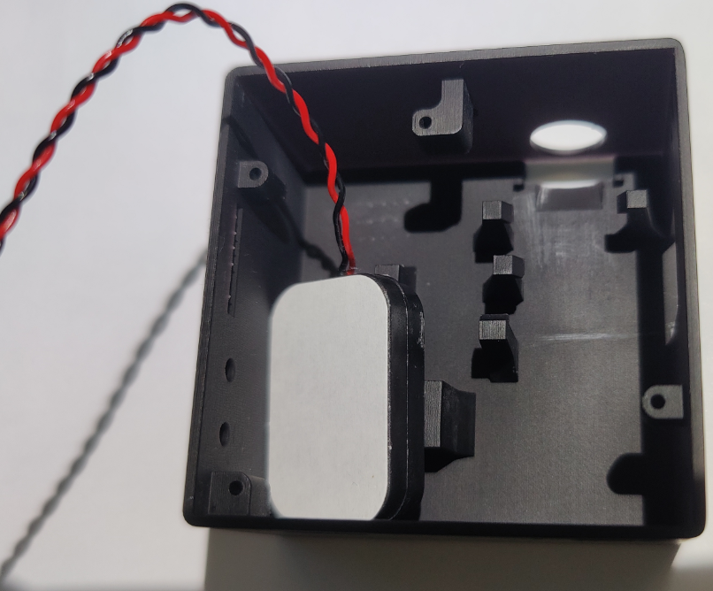

Place the optical engine diagonally into the housing
and push it to the right while pressing it down
. Place the speaker diagonally in as well.
Then, while pushing to the left, press down firmly on

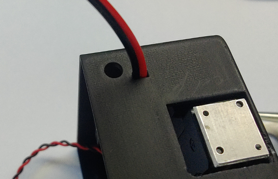

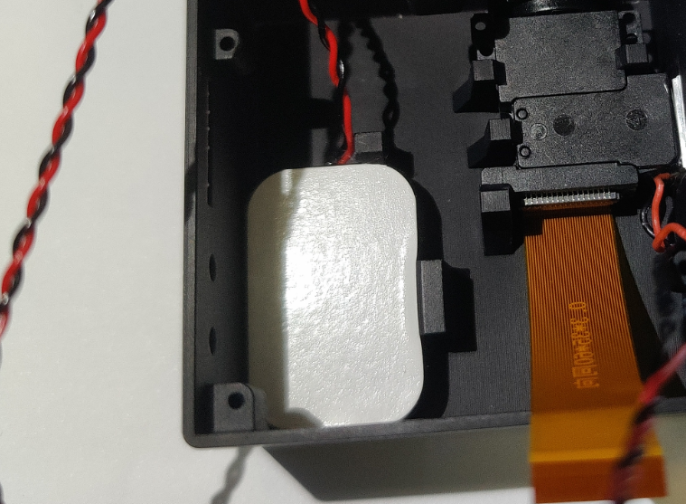

the heatsink connector. Use pointed tweezers or a needle to remove the terminal
, then insert it through the pre-drilled hole on the casing
and back in (be careful not to reverse the positive and negative terminals) .
Apply thermal paste to the contact points between the heatsink and the optical engine, then align it with the hole on the side and press in the included adhesive pins to secure it.

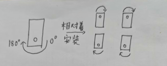

Motherboard connection method: (By default, the gold fingers of the ribbon cable face up. If the connector is bottom-mounted, the ribbon cable is reversed, and the gold fingers face down.)

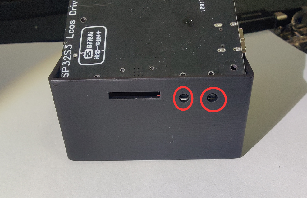

Then connect the other cables. Align
the two buttons
, then gently bend the right side of the casing to the right to insert the motherboard.
After inserting it, close the back cover and secure it with the four screws.

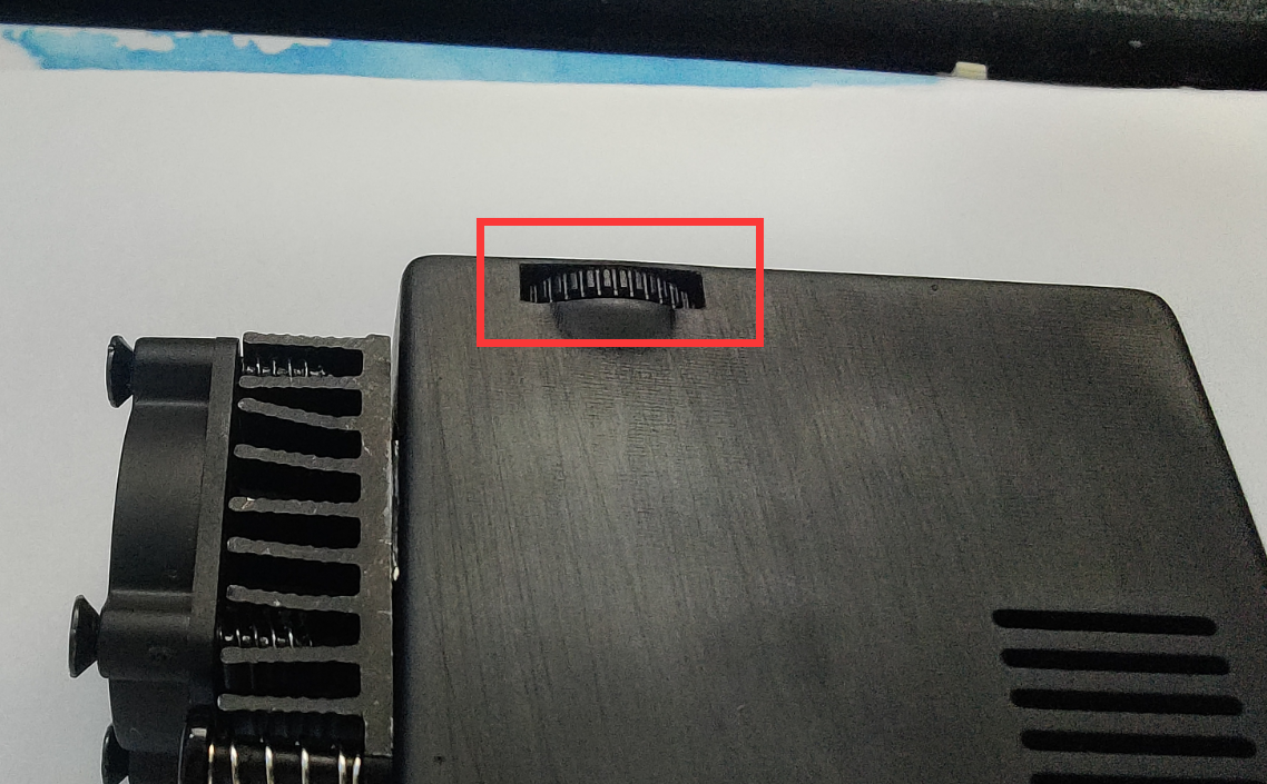

If the image is blurry during use, you can adjust the focus by turning this knob left
and right. Turn it to the left when you are closer, and turn it to the right when you are farther away.

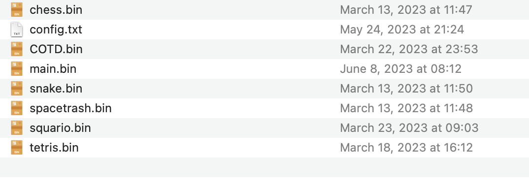

You need to download and unzip the "Game Console Memory Card Files.zip" compressed package in the attachment, and put the folders inside into the memory card. The memory card needs to be formatted as FAT32.
Folder structure:
NES folder: This folder is used to store NES game files. Theoretically, .nes game files are supported, but actual testing is required; opening.mp3 file is the boot sound effect.
MJPEG folder: This folder is used to store the MJPEG files to be played and audio.

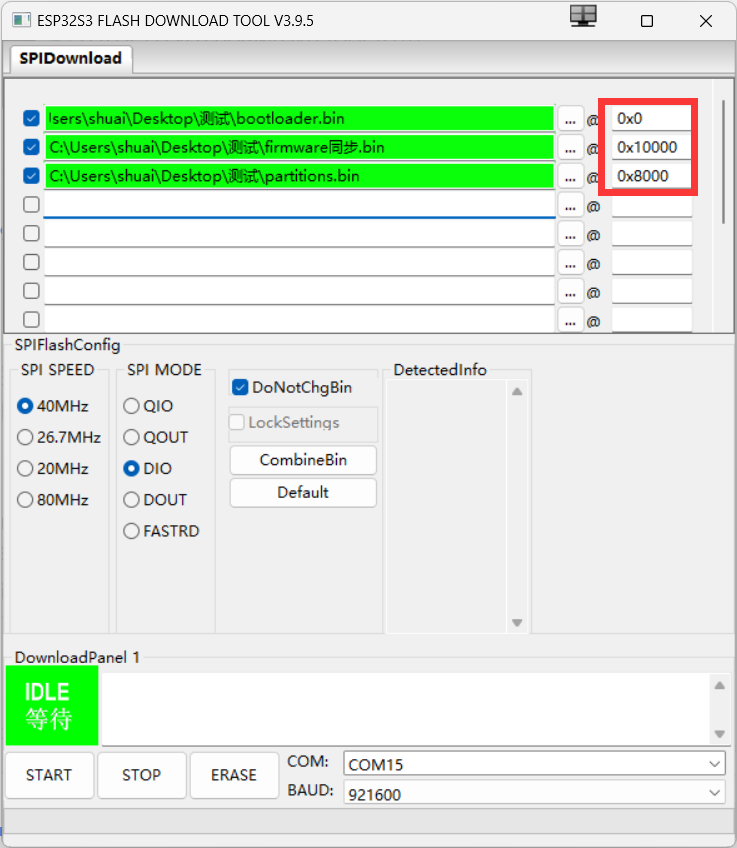

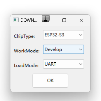

Firmware burning:
Open flash_download_tool_3.9.5.exe
, select ESP32S3
, select each partition file:
bootloader.bin (burning address 0x0),
firmware.bin (burning address 0x10000),
partitions.bin (burning address 0x8000).
Connect the Type-C data cable to the USB port (do not connect to the OTG port). The CH340 driver needs to be installed beforehand. Then select your serial port number, click START to start burning
, wait for the progress bar to complete, then unplug the data cable and plug in a charger with a voltage of 5V2A or higher
. (Do not use your computer's USB port to power it; the peak power is 6.5W+, use a charger with a voltage of 5V2A or higher).

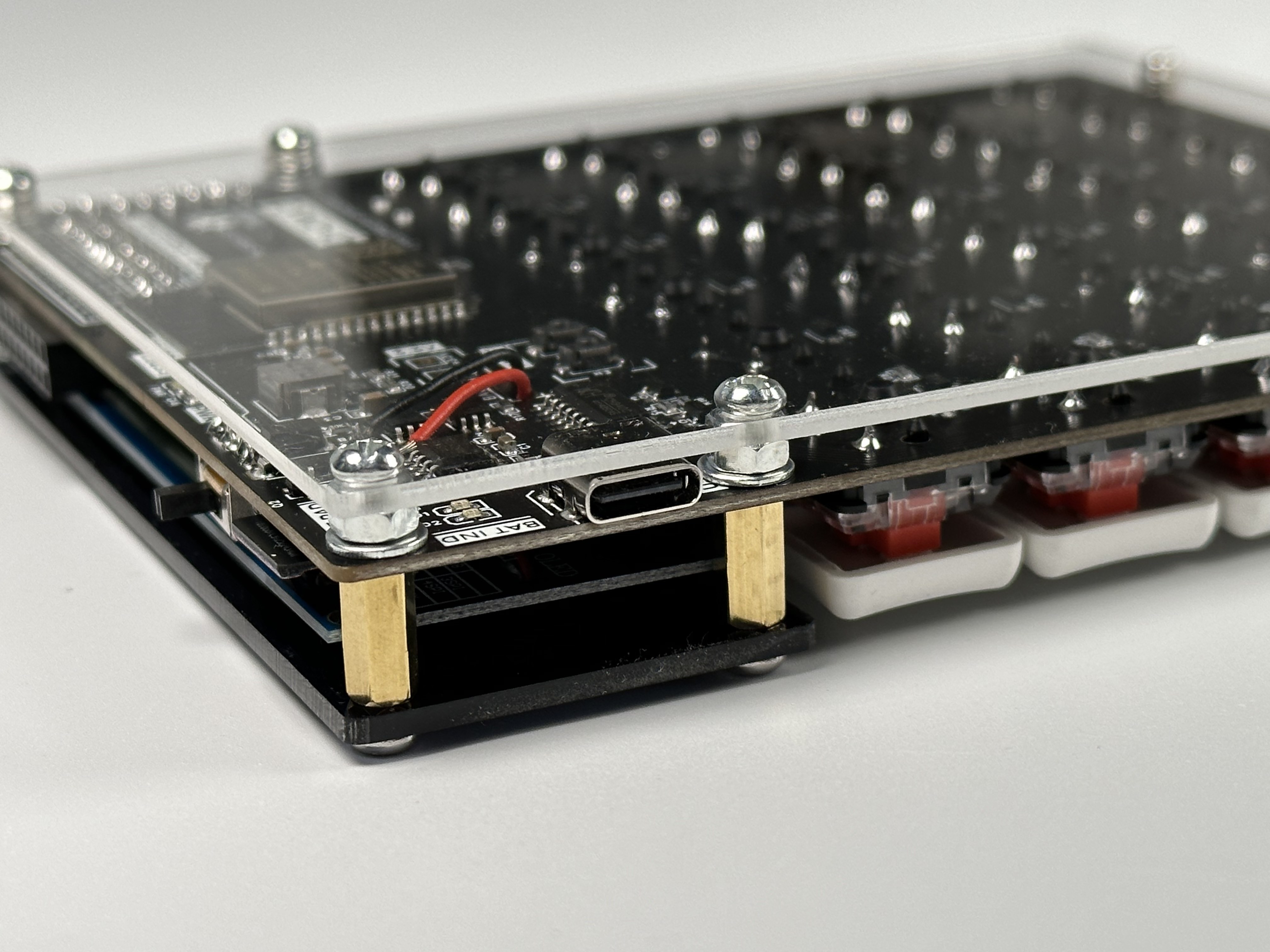

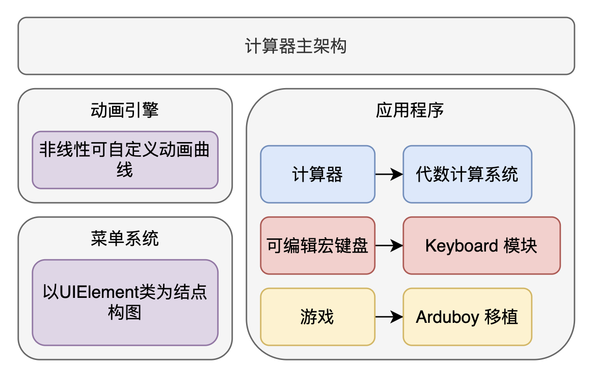

Multifunctional Mechanical Shaft Scientific Calculator
Calculator + Numeric Macro Keyboard + Handheld Game Console + Full-Powered Development Board (4-in-1)
This project documentation will be continuously updated.
Overview:

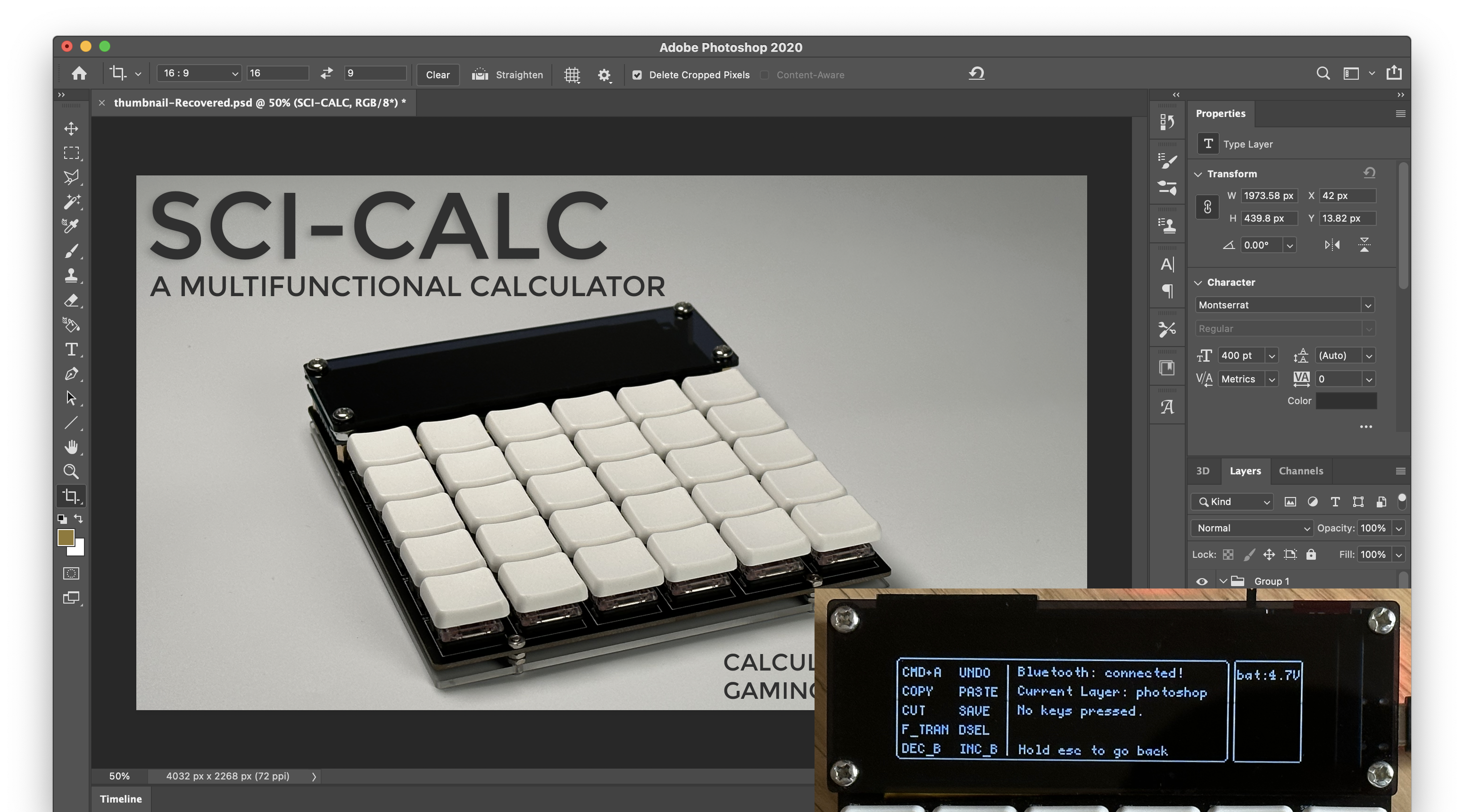

This is a multi-functional calculator that combines a scientific calculator, numeric macro keyboard, handheld game console, and a fully functional development version into one device. Initially, I started making my own calculator because I found the calculator software purchased by the school to be bloated, cumbersome, and difficult to use (Ti-Nspire, cough cough). However, I later added a bunch of other functions, and it became what it is now. (For more information, please see https://github.com/shaoxiongduan/sci-calc/) Bilibili
Collection Configuration : ESP32 WROOM32 E Driver Switches: Kailh v1 choc Low-profile switches Screen: 256x64 OLED (SSD1322) Serial Port Chip: CH340C 1000mAh Battery + TP4056 + DW01 Battery Protection, supports simultaneous charging and use Supports microSD card storage Program Firmware Menu System and UI Components Macro Keyboard Program The macro keyboard program is also quite intuitive. Custom macro keys can be built through the following methods. The 10 buttons in the two columns on the right will automatically appear on the screen as the main macro keys. Customize one layer of buttons: Macro layout1[5][6] = { {Macro({'7'}), Macro({'8'}), Macro({'9'}), Macro({'+'}), Macro({KEY_LEFT_GUI, 'c'}, "COPY"), Macro({KEY_LEFT_GUI, 'v'}, "PASTE")}, {Macro({KEY_ESC}), Macro({'/'}), Macro({'*'}), Macro({'-'}), Macro({KEY_LEFT_ALT, KEY_LEFT_GUI, 'c'}, "C_PATH"), Macro({KEY_LEFT_GUI, 'r'}, "CMD+R")}, {Macro({'4'}), Macro({'5'}), Macro({'6'}), Macro({'^'}), Macro({KEY_LEFT_GUI, 'x'}, "CUT"), Macro({KEY_LEFT_GUI, 's'}, "SAVE")}, {Macro({'1'}), Macro({'2'}), Macro({'3'}), Macro({KEY_RETURN}), Macro({KEY_LEFT_GUI, 'h'}, "HIDE"), Macro({KEY_LEFT_GUI, 'n'}, "NEW")}, {Macro({KEY_LAYER_SWITCH}), Macro({'0'}), Macro({'.'}), Macro({KEY_BACKSPACE}), Macro({KEY_F12}, "G_DEC"), Macro()} }; Initialize macro keyboard class: MacroPad macroPad({ Layout("standard", layout1), Layout("layout 2", layout2), Layout("photoshop", photoshopLayer), Layout("editing", filmoraLayer), Layout("obsidian", obsidianLayer) }); MacropadUI MacropadUI (& MacroPad); The calculator firmware is developed using VS Code + PlatformIO. All programs and configuration files are on GitHub: After flashing the program to the ESP32, it won't run immediately upon boot. You need to copy the .bin file from the SD card. Function keys: Toggle key layers: /Shift:  Single press temporarily toggles, double press toggles and locks like the Shift key, angle toggle key: Toggles between angle and radian units. Tab: Used to switch between the calculator input box and history. Appearance: The calculator 's appearance is made of stacked acrylic sheets, mainly composed of a black semi-transparent acrylic sheet + PCB + a transparent acrylic sheet at the bottom. It is very sturdy, inexpensive, and easy to assemble; users have praised it. The UI calculator supports basic arithmetic operations, including square roots, trigonometric functions, and exponential/logarithmic functions. Automatic differentiation and equation solving may be added in the future. History: Used to record calculations. You can also copy the answers from the history using Tab + Enter, greatly improving calculation efficiency and eliminating the need to manually type out previously calculated formulas. This calculator also functions as a numeric keypad with 10 customizable macro keys. The defined keys are displayed on the left side of the screen. Multiple macro keys can be set, allowing you to switch between different levels depending on the software you're using, such as for programming . (PS: There's also editing: Uploading programs involves saving the compiled program's .bin file to a microSD card, and the calculator reads and runs the file.) To improve learning efficiency and motivation, I've ported several "learning software" tools from various developers: An ESP32 development version calculator brings out the ESP32 pins, allowing it to be used as a development board with Arduino IDE. These pins can also be connected to expansion modules (I'm too lazy to design them yet). Please like and follow! :)

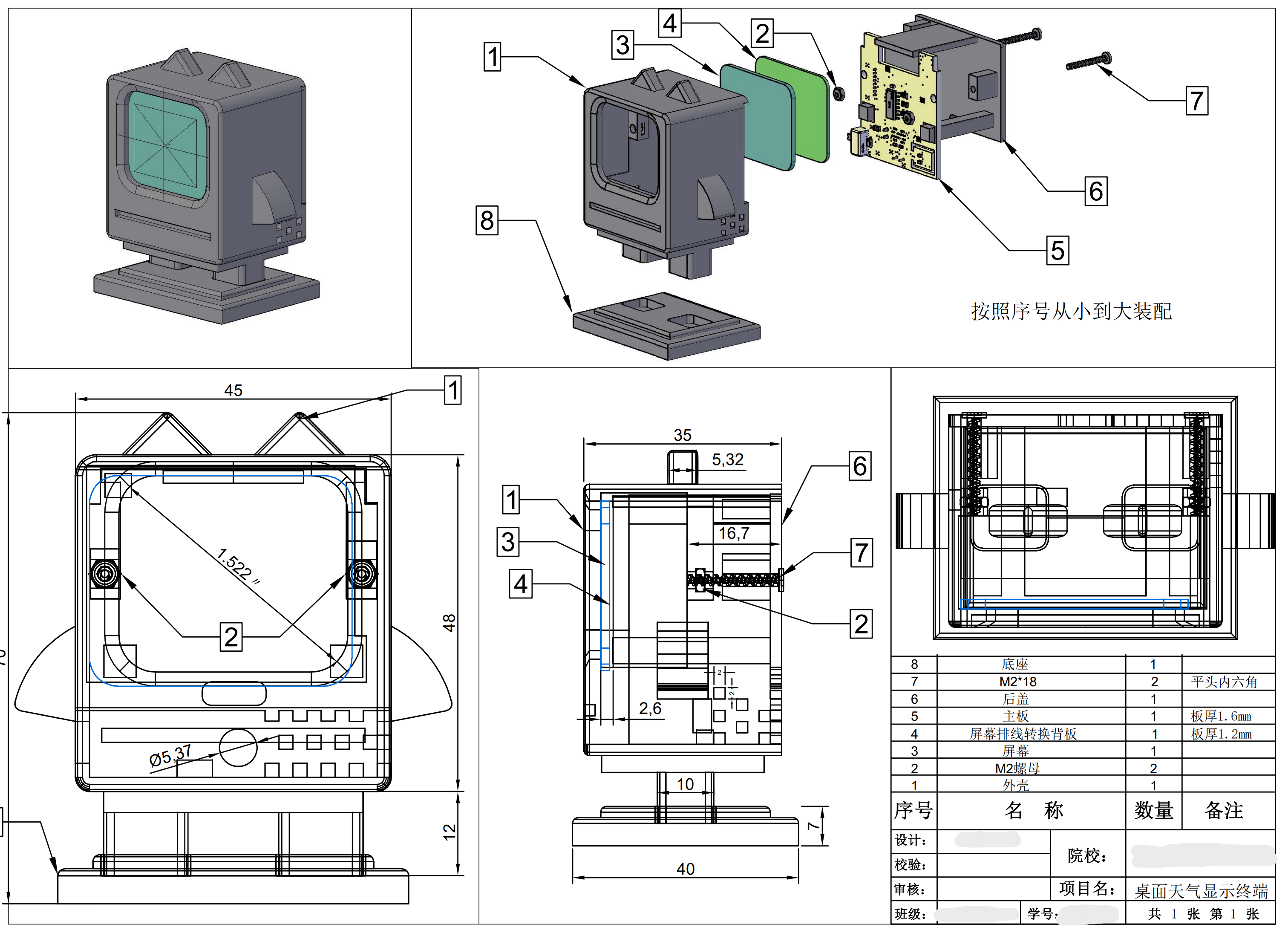

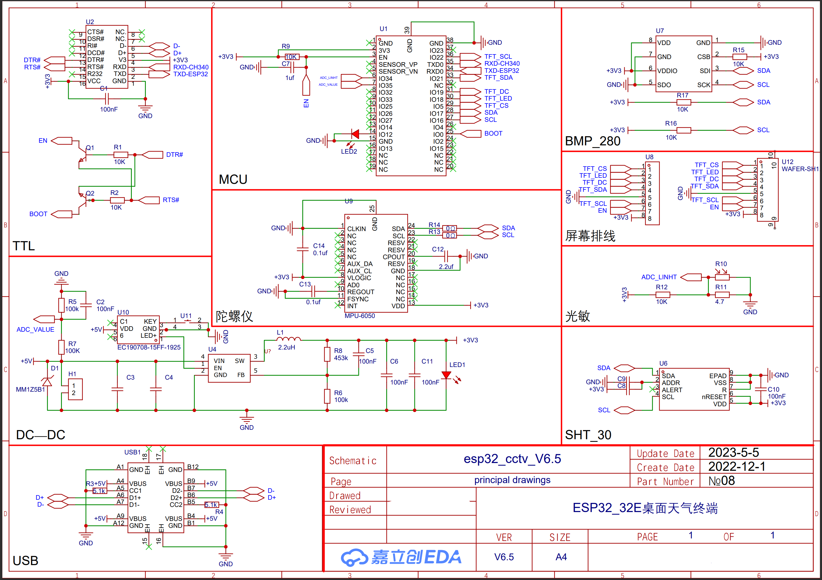

ESP32_32E Desktop Weather Terminal
Using the ESP32-WROOM_32E main control chip, the local sensors employ two temperature, humidity and barometric pressure sensors, SHT30 and BMP280, to detect and display local temperature data in real time. The main control chip is connected to the network and automatically obtains its location and weather conditions via IP.
 ESP32 Multifunctional Time and Weather Desktop Display Terminal
   Project Introduction: This project uses the ESP32-WROOM series domestic WiFi chip as the main control chip. Local sensors, specifically the SHT30 and BMP280 temperature, humidity, and barometric pressure sensors, are used to detect and display local temperature data in real time. The main control unit automatically obtains its location and weather conditions via IP address. The built-in light sensor automatically adjusts the screen brightness based on ambient light intensity and features OTA remote firmware upgrade functionality.
#### Shell Design #### Circuit Design
#### Library Installation Method and Compilation Tutorial
1. Download and install Arduino IDE 1.8.19 (https://www.arduino.cc/en/software)
2. Unzip the files in the software program/Arduino-libraries directory and place them in the Arduino IDE 1.8.19/libraries directory.

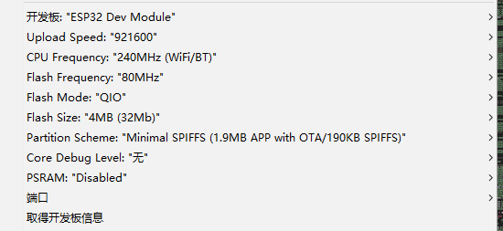

4. Download the ESP32 development board from the Arduino IDE 1.8.19 software.
5. Select the development board in the tools options (as shown in the image). 6. Open the file `/arduinoIDE_minicctv_main_ino/arduino_IDE_cctv.ino` and compile it. If there are no errors, the first four steps are correct.

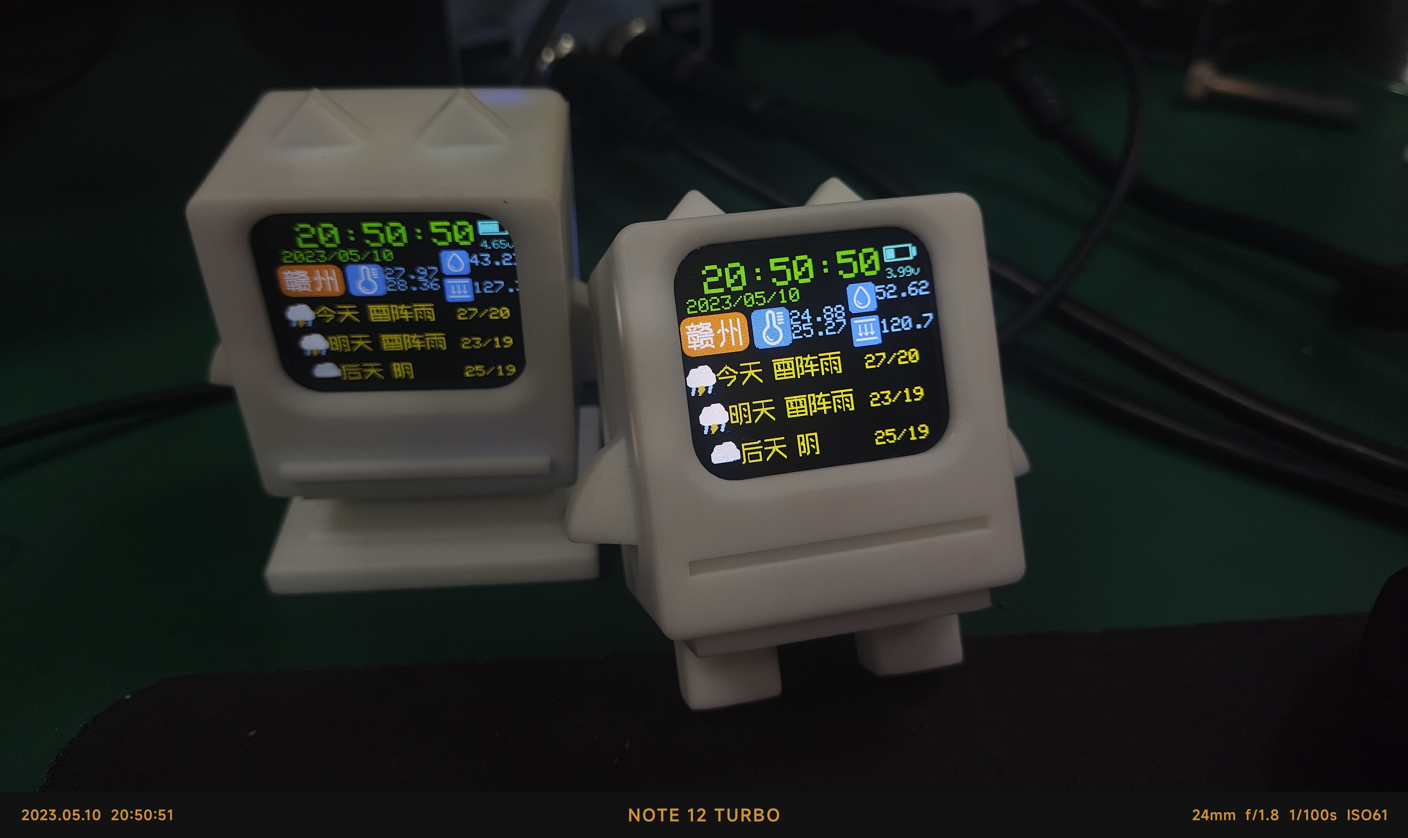

1. **Connecting to WiFi:** For first-time use, you need to connect to your own WiFi network.
  1.1: After powering on, wait for the WiFi connection timeout screen to appear.
  1.2: Turn on your phone or computer's WiFi and search for and connect to WiFi networks starting with `ESP32`
  . 1.3: In the pop-up window, select the WiFi name and enter the WiFi password.
  1.4: Click Save and wait for the module to connect to WiFi.

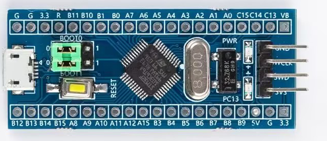

While browsing Bilibili, I stumbled upon a mechanical quadruped made by a content creator, which inspired me to make a simplified version. Please excuse its simplicity. Materials needed:

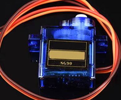

1. One STM32F103C8T6 development board
2. Eight blue SG9 classic 180-degree servos

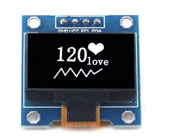

3. One IIC communication OLED screen (large or small)
4. One 3.7V lithium battery + one 5V lithium battery Alternatively, you can use my lazy method: directly using the ST-Link power supply

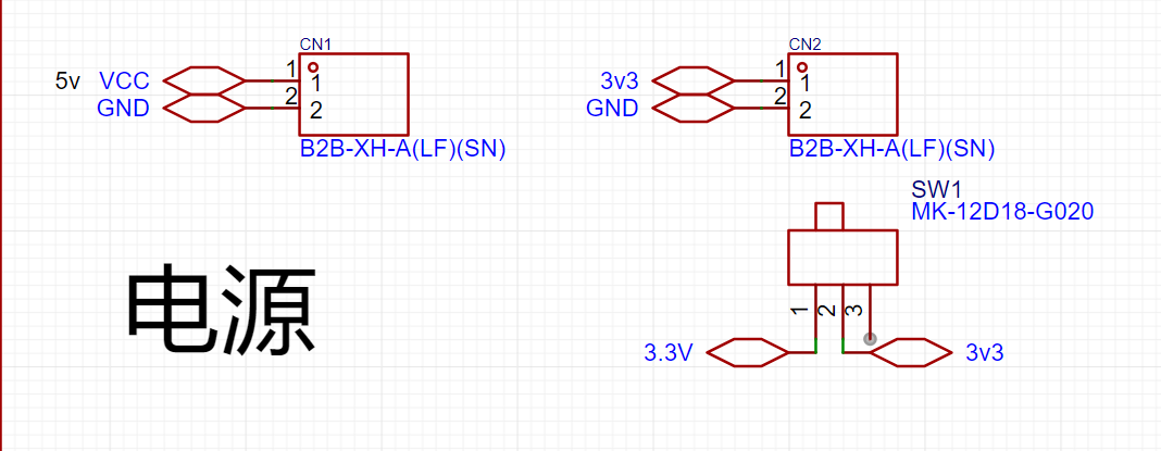

schematic and PCB design instructions.

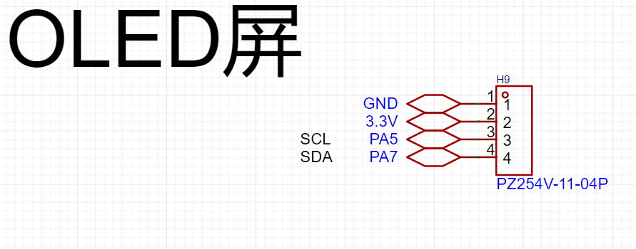

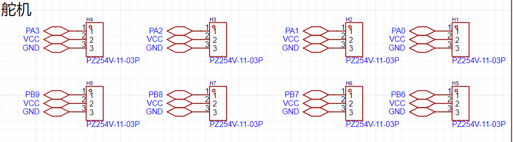

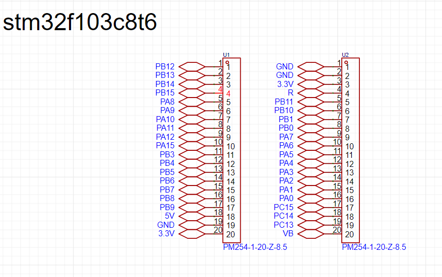

The design consists of four parts: power supply, OLED, servos, and STM32 board.
1. The power supply
only requires a miniature toggle switch + two 2P headers or sockets. Alternatively, you can just place the pads and then connect the batteries with jumper wires.
Use the miniature toggle switch to control the power supply to the STM32 board.
The 3V power supply is for the STM32F103C8T6 board and can be powered by a small 3.7V lithium battery.
The 5V power supply is for the servos and can be powered by a 5V lithium battery.
Two batteries can be glued to the bottom of the base plate using a hot glue gun.
Of course, for lazy people like me, I can directly use the 3V3 and 5V drivers on the ST-Link, and I can modify the code at any time. 2. The I2C communication port of the OLED screen
only needs a 4-pin header.
The screen I used here can be driven by 3V3, but you can also switch to 5V depending on the application.
The communication ports SC1 and SDA use PA5 and PA7 I/O ports respectively (this is how the code is written), and you can change them according to your own code.
If you are using other communication methods, this part needs to be modified accordingly.
3.
The reason for using these ports for the servo part is that the distance is short, and the subsequent wiring is simple.
Secondly, when writing the code to control the servo, you need to consider the TIM clock. The following figure shows the I/O port corresponding to the TIM clock of the STM32. 4. For
the STM32F103C8T6
, I used female headers to draw each serial port of the STM32.
In the PCB, you need to pay attention to the spacing of the female headers, otherwise they will not fit.

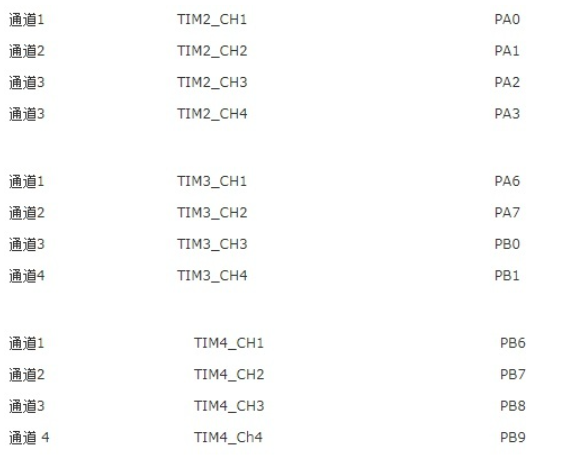

requires checking the STM32's TIM clock table.
I've chosen TIM2 and TIM4, so I need to define the I/O ports PA0, 1, 2, 3 and PB6, 7, 8, 9: `

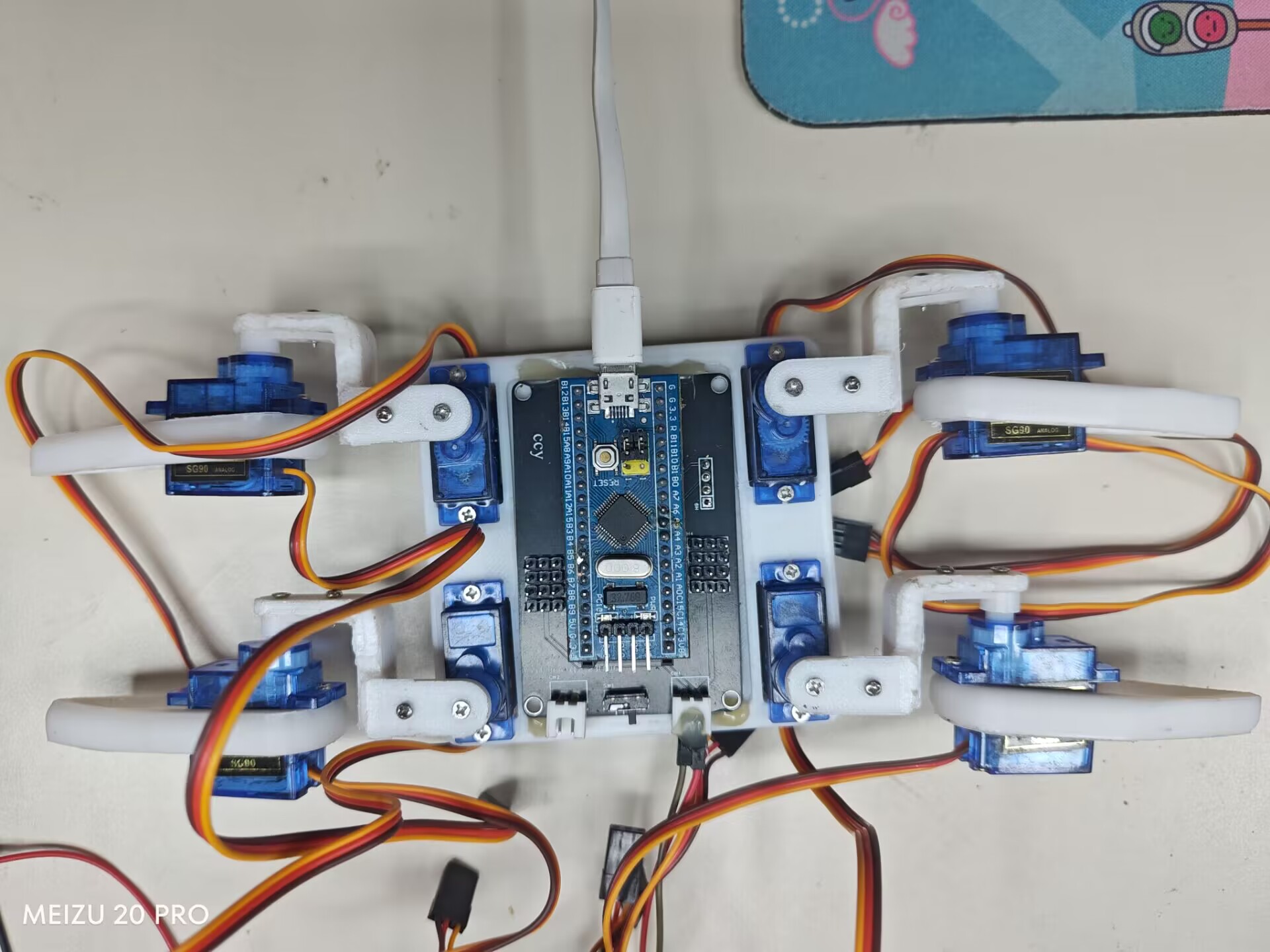

Before installation, you need to use code to rotate all the servos to 90° before fixing the legs. This increases the leg's freedom of movement.
First, use these codes:
`TIM_SetCompare1(TIM2,150);
TIM_SetCompare2(TIM2,150);
TIM_SetCompare3(TIM2,150);
TIM_SetCompare4(TIM2,150);
TIM_SetCompare1(TIM4,150);
TIM_SetCompare2(TIM4,150);
TIM_SetCompare3(TIM4,150);
TIM_SetCompare4(TIM4,150);`

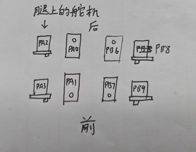

to adjust the servos to 90°. Then connect the legs as shown in the diagram.
To run my code, connect the servo cables as shown in the diagram.
