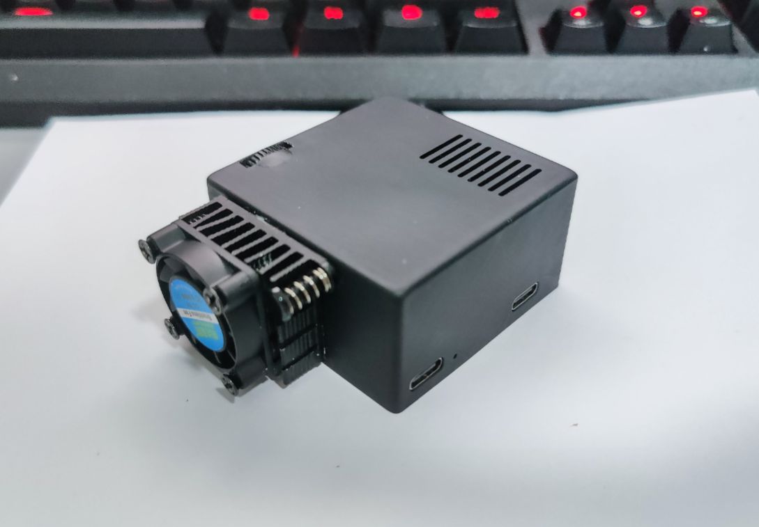

This is a small LCOS projector driven by an ESP32S3, with a resolution of 320*240.
I previously open-sourced a small projector using an LCD screen, but the effect wasn't good. A friend recently recommended this stock optical engine, and the effect is much better than the previous LCD screen version.
The LCOS modules for this project were found on Xianyu (a second-hand marketplace), 5 for 50 yuan. Those who want to replicate it should buy the optical engine as soon as possible, as the quantity of this LCOS module on Xianyu seems to be limited. (

The LCOS model is Lijing Optoelectronics HX7033,
driven by the Arduino_GFX library (https://github.com/moononournation/Arduino_GFX).
The driving method is I2C+RGB565
. Main controller: ESP32S3 N8R8 (S3-WROOM-1U-N8R8, which is the version without PCB antenna).
I2S amplifier: MAX98357
. 3.3V step-down: TLV62569DBVR.
10V boost: MT3608.
LED Constant Current: PAM2863ECR
Serial Port: CH340K
WARNING ⚠: A heatsink must be connected before the optical engine module is lit; otherwise, powering on for more than 3 seconds may burn out the LED chips.

Projection distance:
To project the entire area of ​​an A4 sheet of paper, the distance is approximately 60cm.
The minimum projection distance is approximately 29cm (with the focus ring turned to the far left).
The maximum projection distance should be between 1m and 1.5m (with the focus ring turned to the far right). At this distance, the projected area will be slightly larger than the A3 size (29.7cm × 42.0cm), but the brightness will be lower.

Installation:
Note: Once the optical engine is installed in the housing, it is difficult to remove unless the housing is damaged.
Prepare an MX 1.25mm pitch 2P male connector and connect the optical engine's LED light source cable to the
optical engine ribbon cable. Installation: (The optical engine ribbon cable must be installed first). After installation, manually fold the ribbon cable upwards
and then peel off the protective film on the optical engine lens
. (Carefully check the housing for any unpolished support points. If there are any, polish them smooth, otherwise they will block the optical engine.)
Place the optical engine diagonally into the housing
and push it to the right while pressing it down
. Place the speaker diagonally in as well.
Then, while pushing to the left, press down firmly on
the heatsink connector. Use pointed tweezers or a needle to remove the terminal
, then insert it through the pre-drilled hole on the casing
and back in (be careful not to reverse the positive and negative terminals) .
Apply thermal paste to the contact points between the heatsink and the optical engine, then align it with the hole on the side and press in the included adhesive pins to secure it.
Motherboard connection method: (By default, the gold fingers of the ribbon cable face up. If the connector is bottom-mounted, the ribbon cable is reversed, and the gold fingers face down.)
Then connect the other cables. Align
the two buttons
, then gently bend the right side of the casing to the right to insert the motherboard.
After inserting it, close the back cover and secure it with the four screws.
If the image is blurry during use, you can adjust the focus by turning this knob left
and right. Turn it to the left when you are closer, and turn it to the right when you are farther away.
