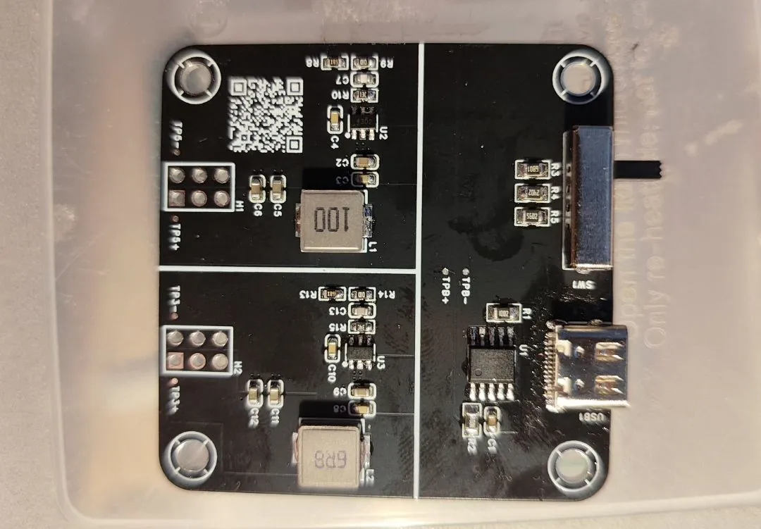

QC/PD-induced dual-channel DC-DC buck power supply
This project is a breadboard power supply module using the CH224K chip, supporting DC and QC protocols, and capable of outputting 9V, 12V, and 15V voltages. A TPS54302 step-down converter provides dual 5V and 3.3V voltage outputs to meet various circuit requirements. It is convenient and quick, suitable for various electronic projects and debugging.
The three-in-one board has been tested, and all voltage triggering operations with the CH224K chip are normal, as is the DC-DC converter. Without triggering, VBUS only provides 5V power, and the dual DC-DC converters only output 3.3V.
The triggering board and DC-DC converter board are only designed and have not yet been tested. Their layout and schematics are very similar to the three-in-one board, so theoretically, there should be no problems.
